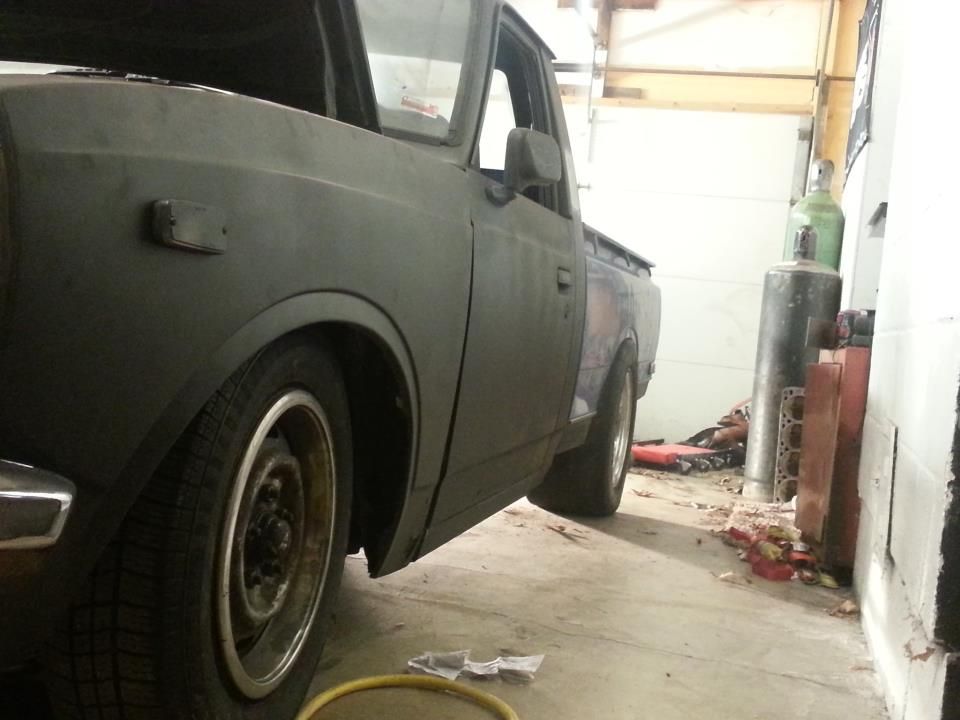

  3. 77mini
    77mini Enthusiast
    Sep 17, 2012
    131
    Im doing adjustable drag links with a adjustable wish bone. Im going to keep the top links at around 15 degress and the bottom links 0 to -5 degress. The frame getting narrowed to tuck the tires with the right back spaceing. The inside im going to widen the wheel wells. Its going to be simple and clean... I guess you guys are going have to see what im talking about.

  9. 77mini
    77mini Enthusiast
    Sep 17, 2012
    131
    275-50-15 on a 10in rim

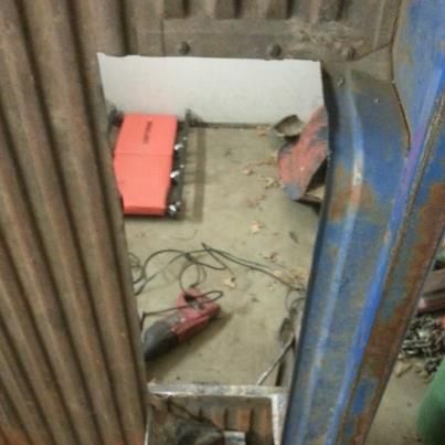

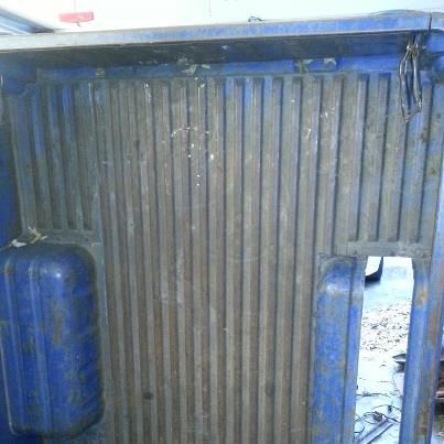

  10. 77mini
    77mini Enthusiast
    Sep 17, 2012
    131
    NOOOOOOOOO THE BED WAS CUT!!!!!!!!!!!!! :p
    A BEFORE
    A AFTER

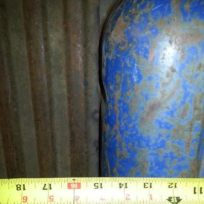

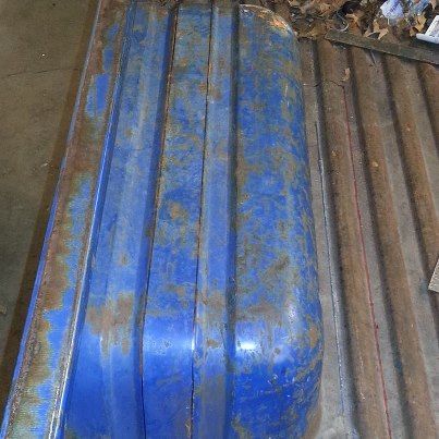

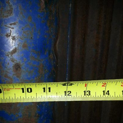

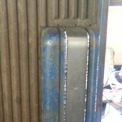

  11. 77mini
    77mini Enthusiast
    Sep 17, 2012
    131
    a lot of work later, i got the middle peace tacked up and shaped up to the old fender, now i have to welded it up and sand it down smooth
