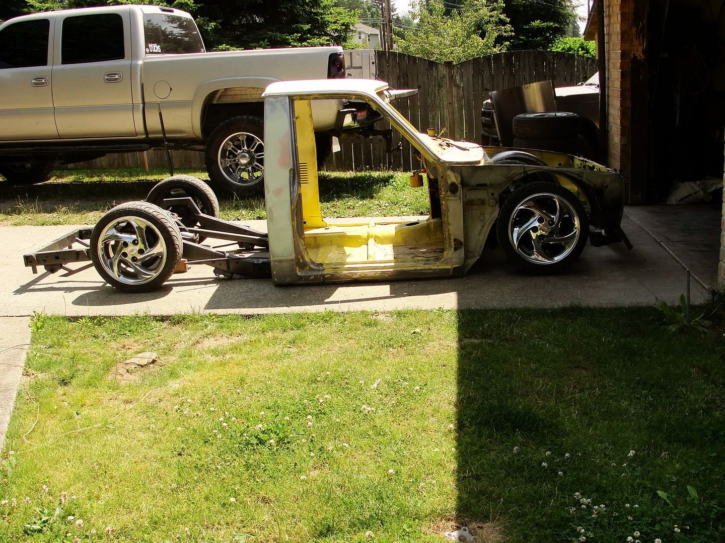

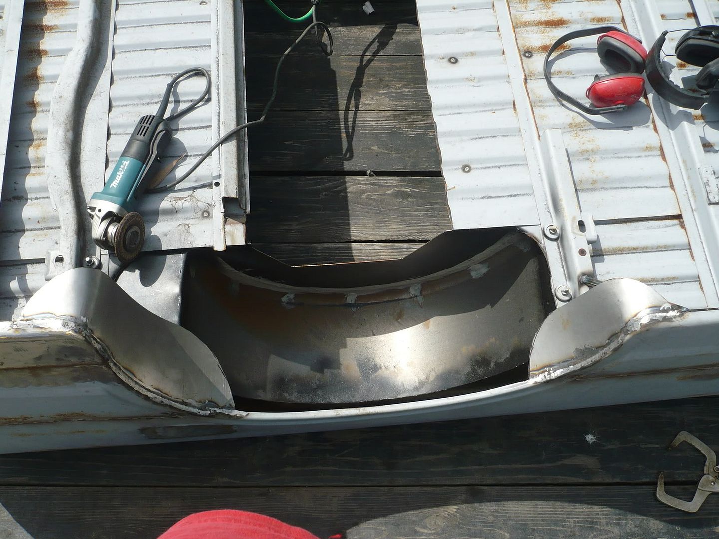

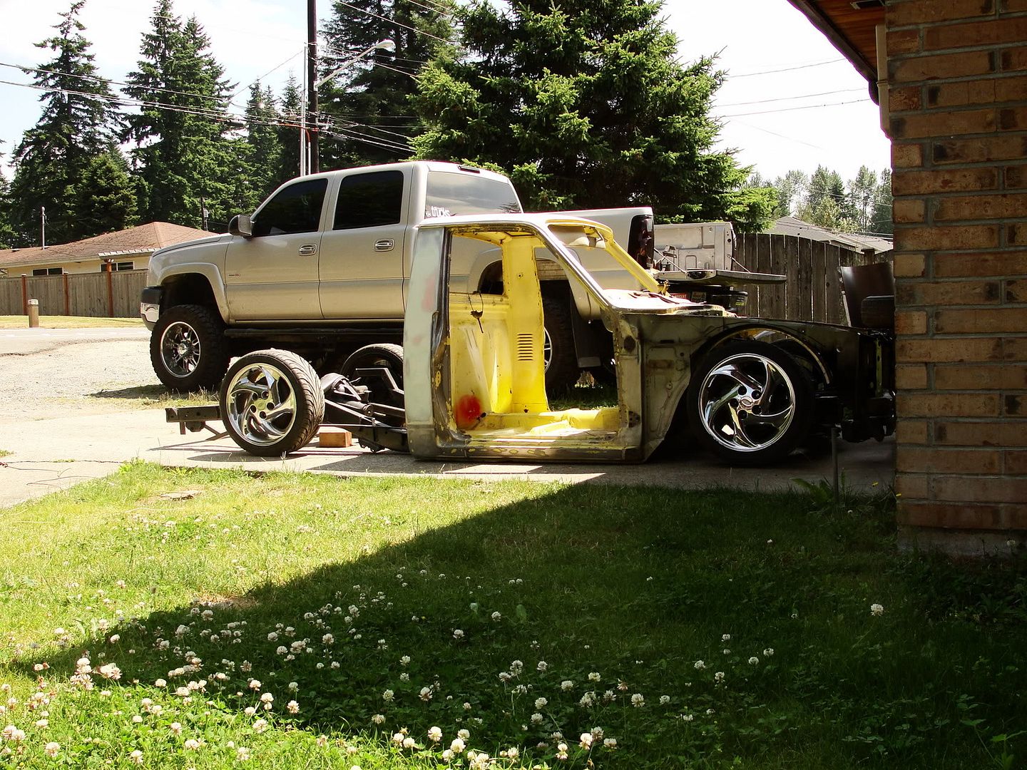

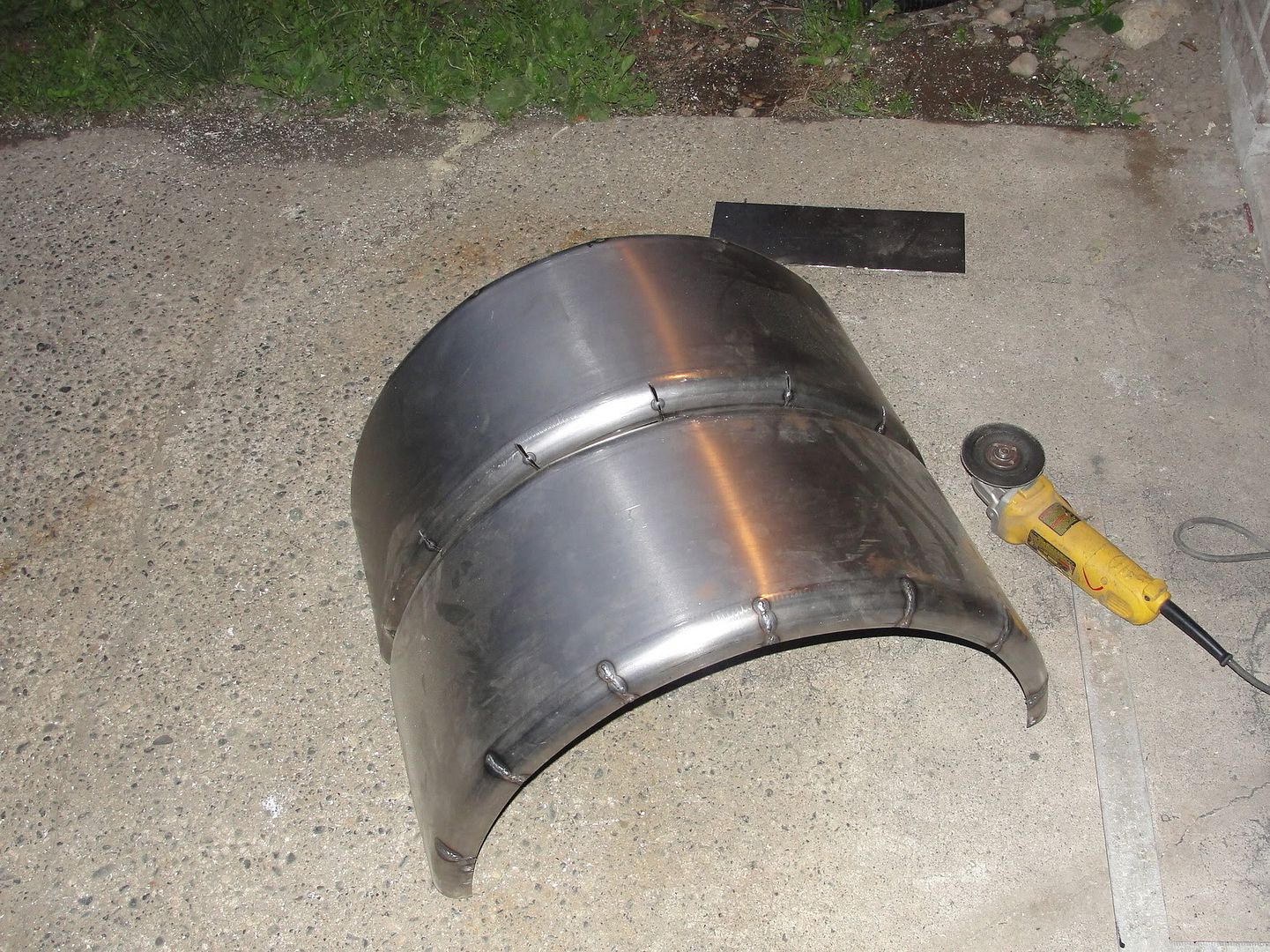

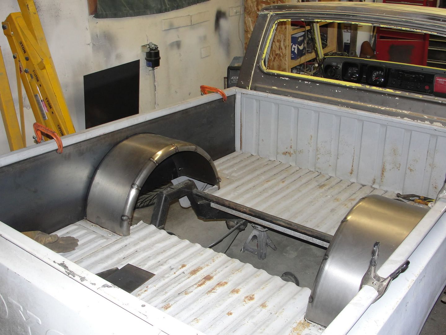

    i am. i already have those bottom pieces from another bed to make them longer. and the whole center section and tubs from another bed to make my tall tubs and notch cover out of the stock bed material.
    got all the easy **** mowed down. tomorrow ill spend most of the day finger ****ing the little **** while im da'ing and i get my new tiny tires tomorrwow 205/40/16 i want this bitch barely above the tires.

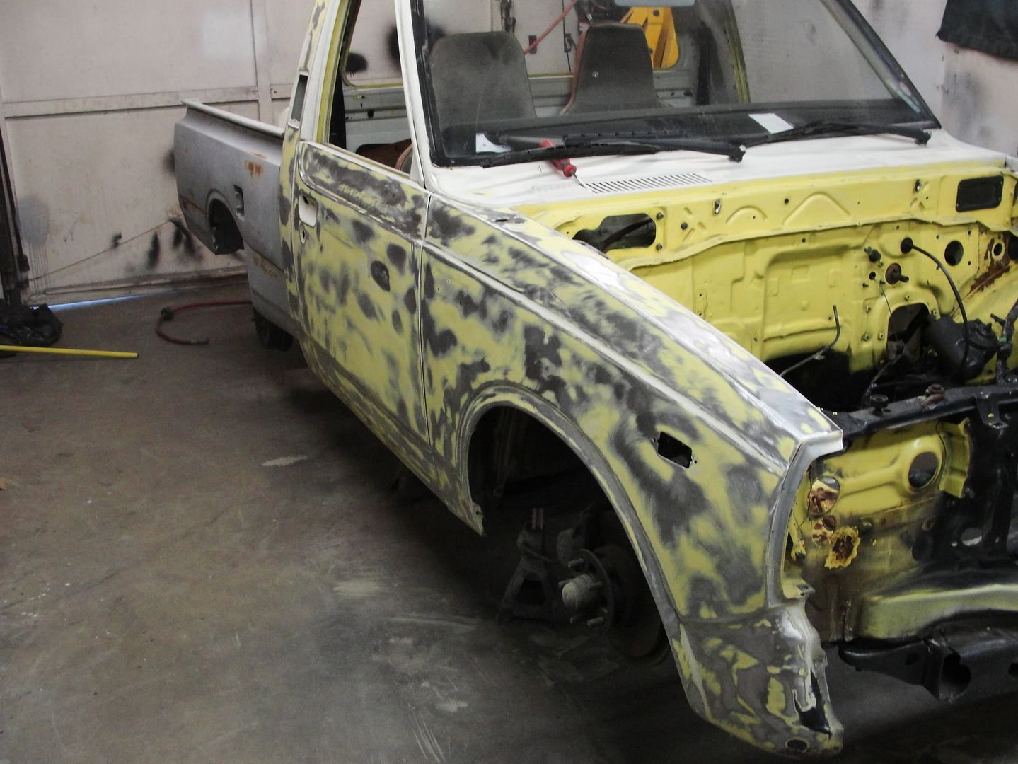

    your stripping the paint the messy way lol. i used the aircraft stripper on my truck with a wire brush it took 2 hours to do the whole truck.

    the gooy stripper way is the messy way imo. i hate that ****. unless its on a hood or roof where it can settle i dont like to dealwith it on side panels.
    it only took 2 hours to do that much. prob another 2 hours to finish it. i dont care id rather do it this way. id rather deal with dust than a liquid goo dripping all over my floor.

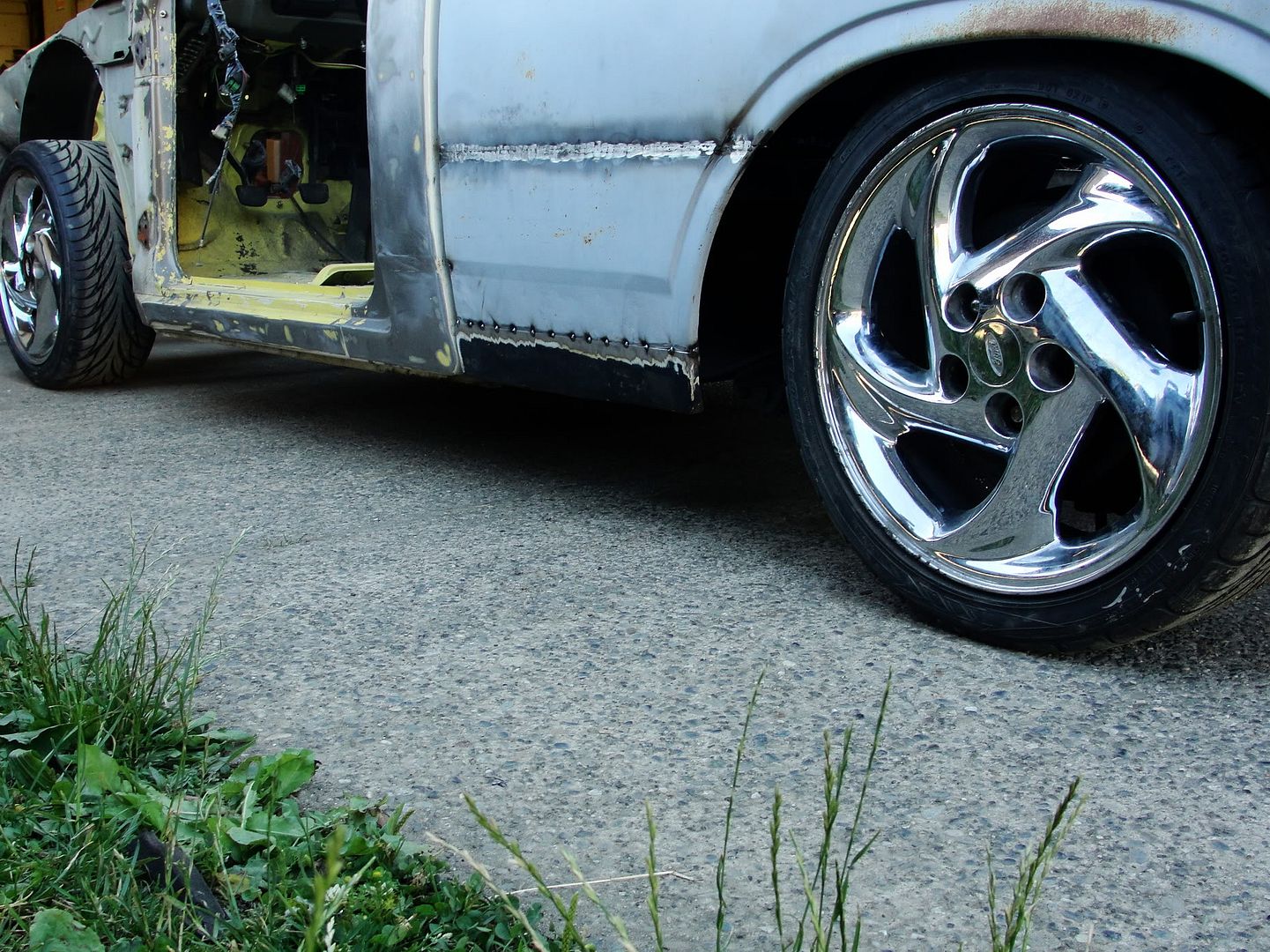

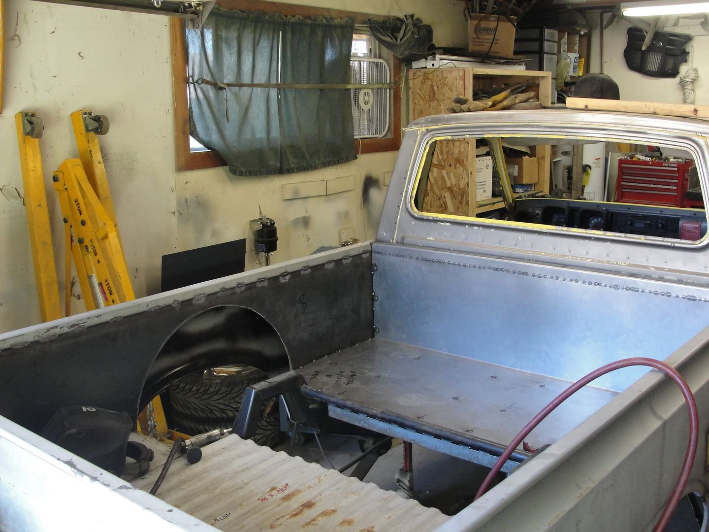

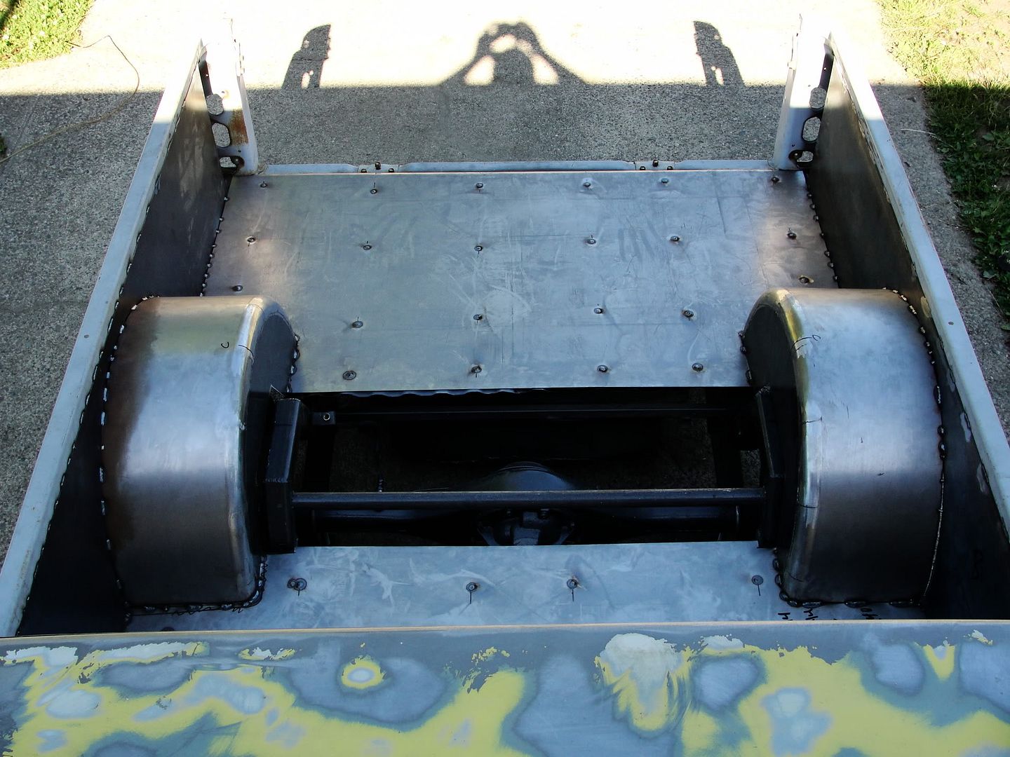

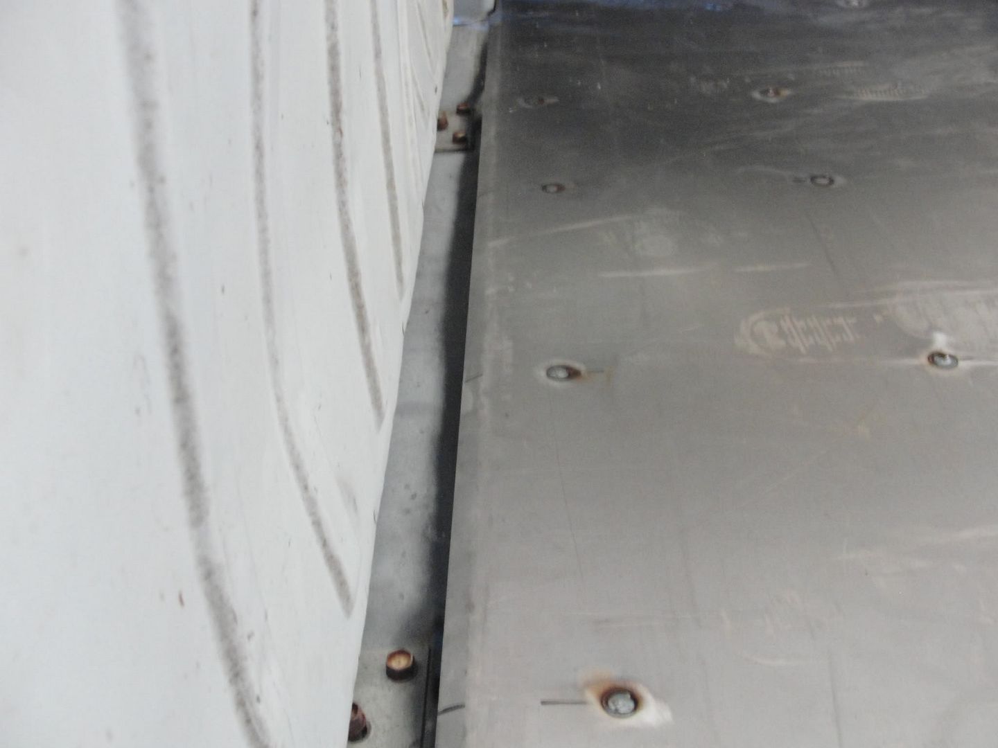

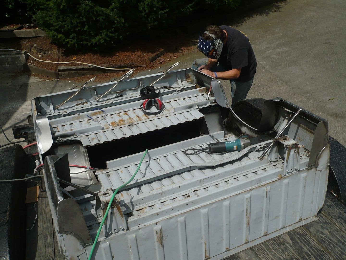

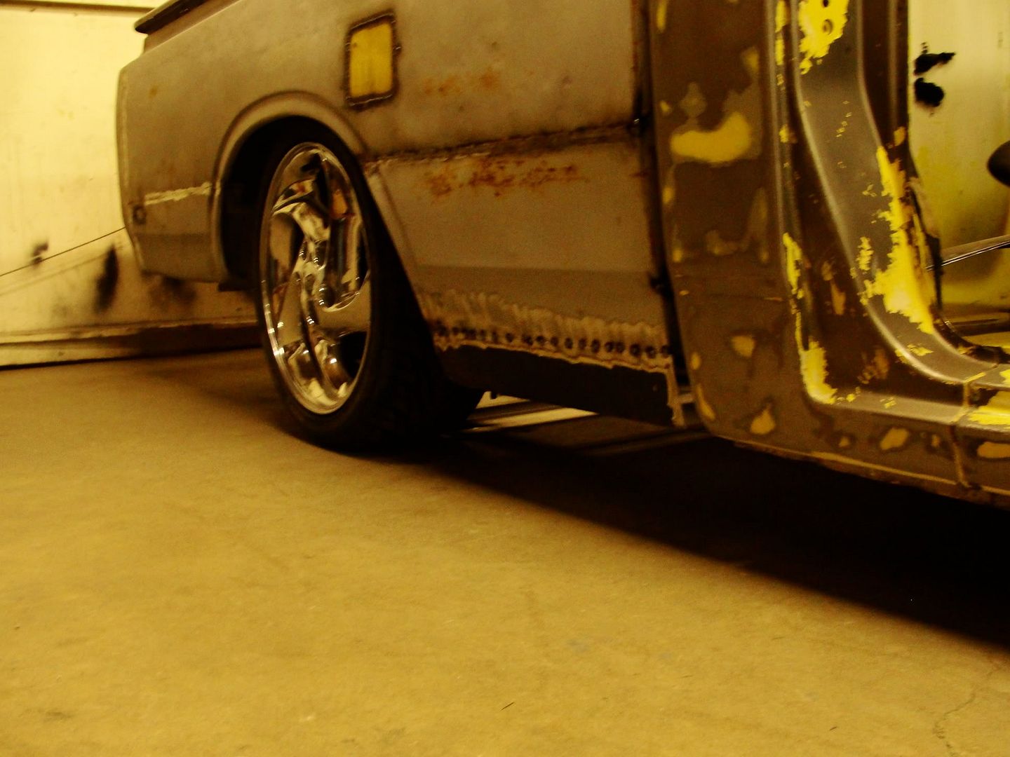

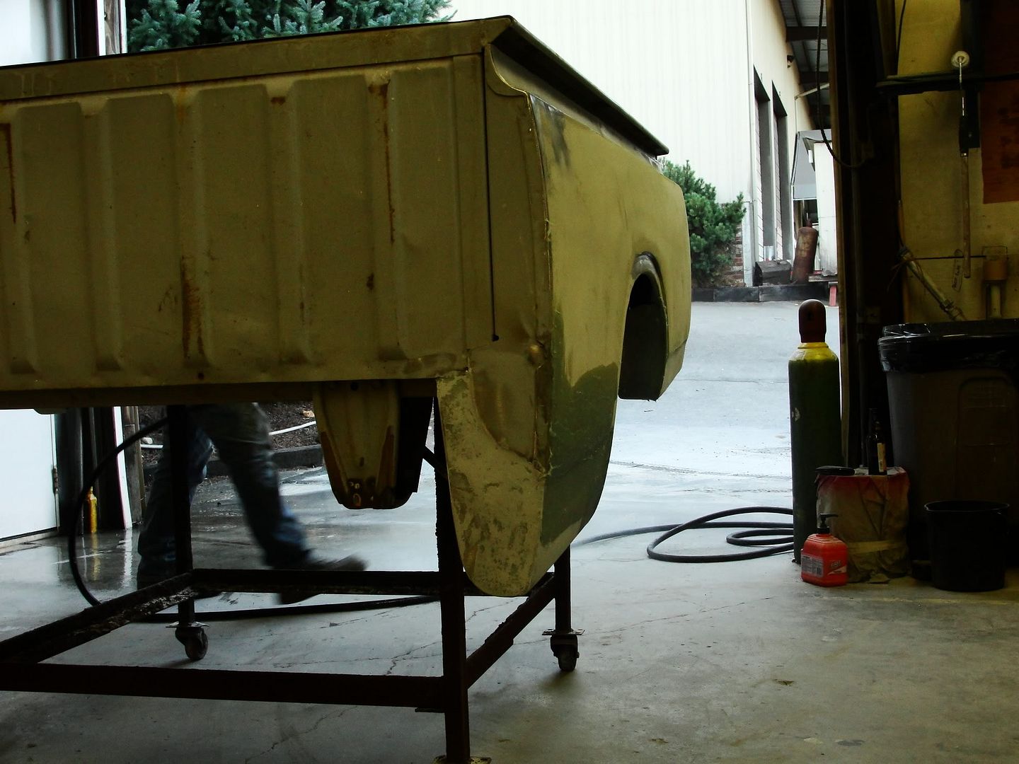

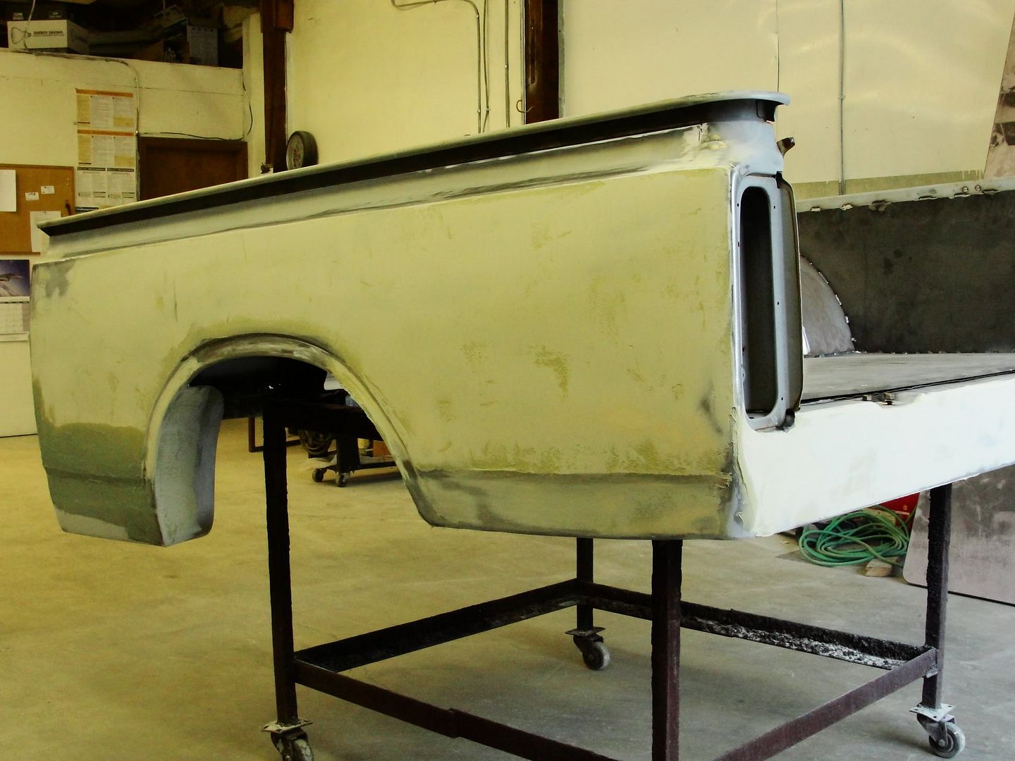

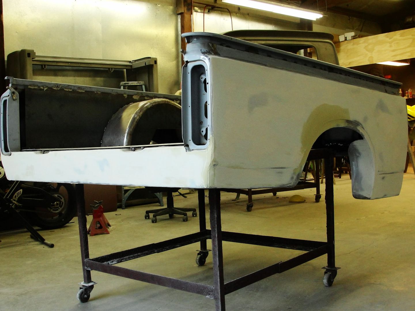

    got all the bed seams welded up and door jambs sanded down. just need to the roof, cowl and back wall then go over it all with 80 grit. and shes ready to relocate to the body shop

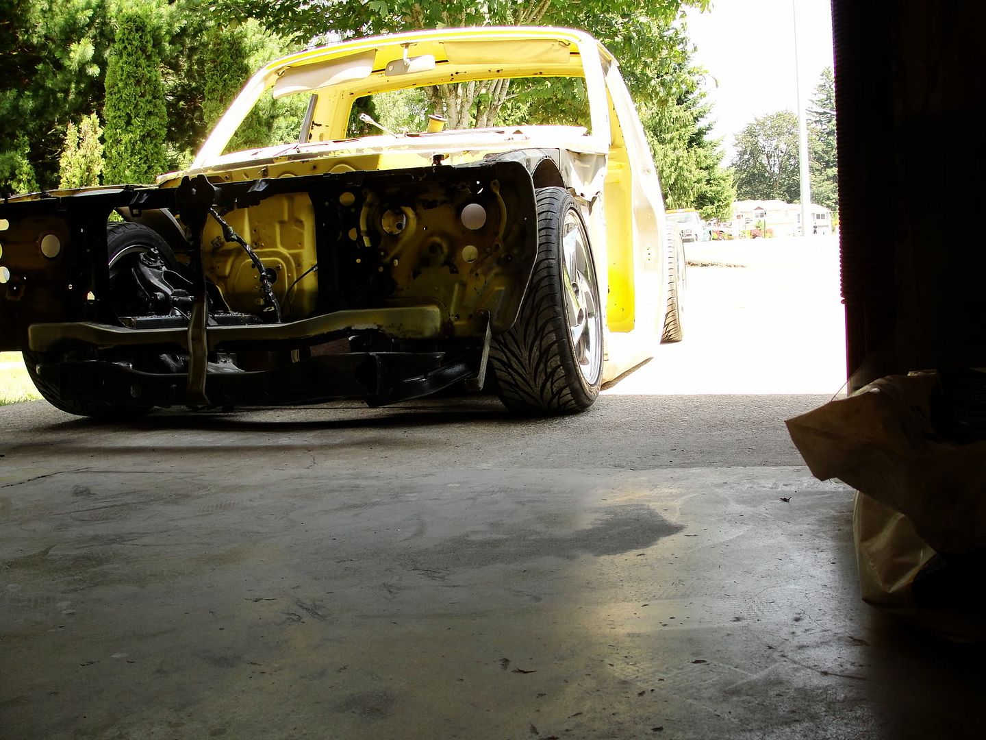

    oh and got new shoes on the probe wheels as well

    Nice. Those are gonna be some tiny ass tires. My 195/50s look little. Hope it doesn't bend a rim.

    they are heavy ass old chrome factory wheels not billets lol. ive had 265/35 /22 before and hit some narly ass holes and never had a problem. have bubbled some tires and destroyed them but never bent a wheel. plus these wheels are trashed anyway.

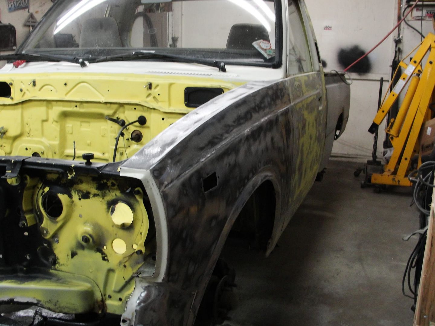

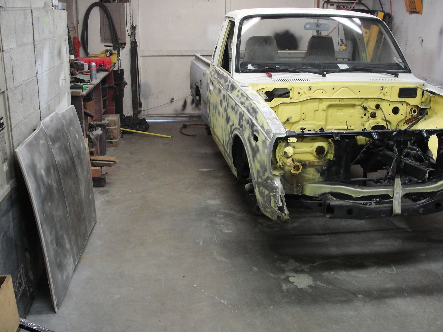

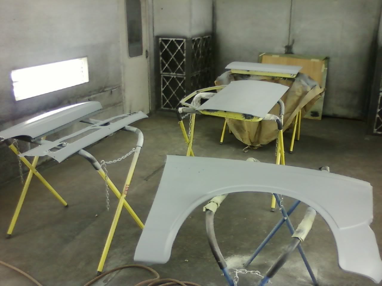

    also got the hood all reinforced underneath to prevent waves. used 3m pillar foam inbetween all the supports got that cutout then seamsealed every edge.. its crazy but it looks good lol. ill get pics of that tomm. the fenders doors hood and valence are ready for final sand and paint. soon the bed will be back at the shop getting a full skim and then the cab.. should have this bitch painted by the end of the month. wouldnt that be nice.

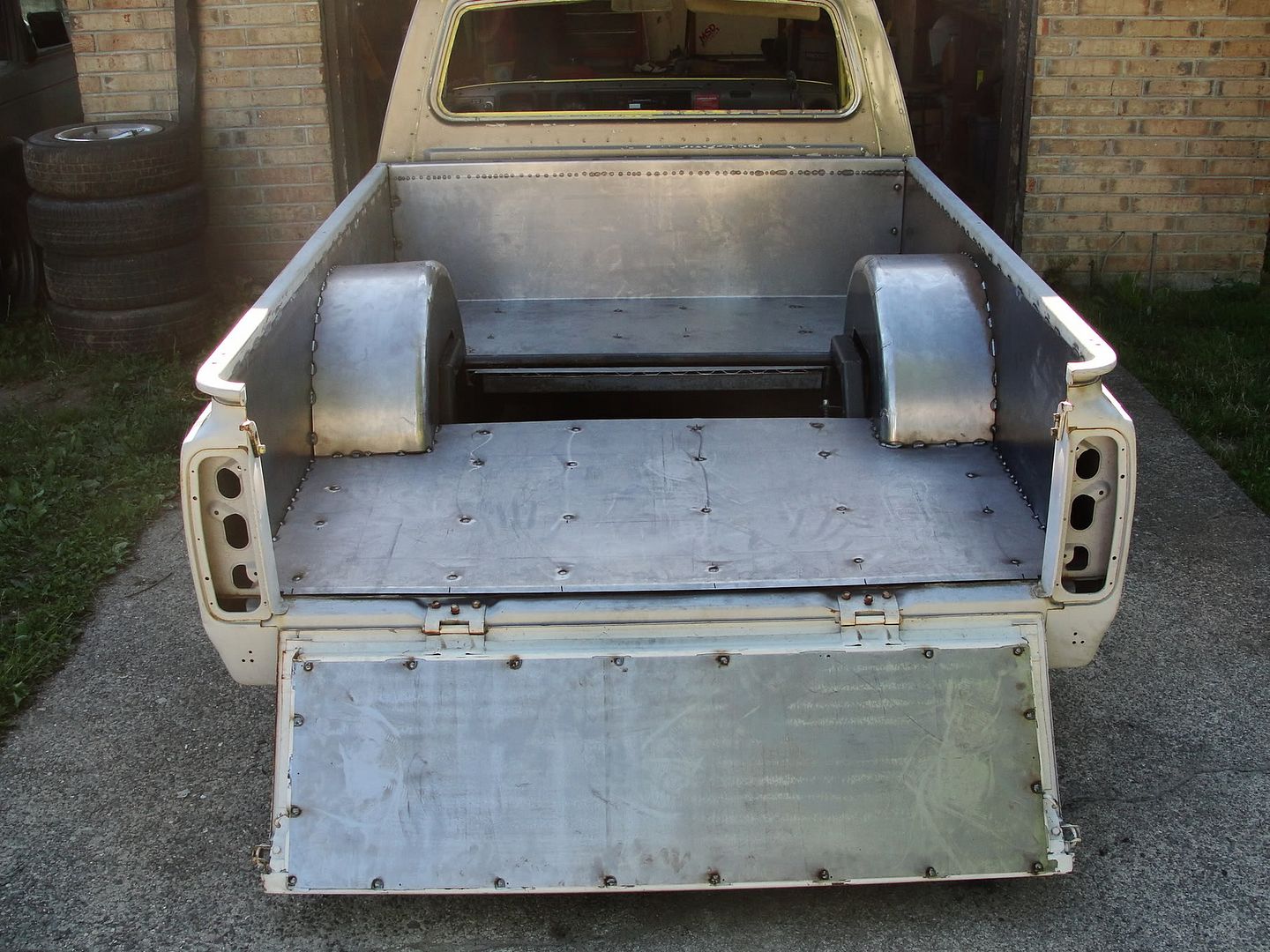

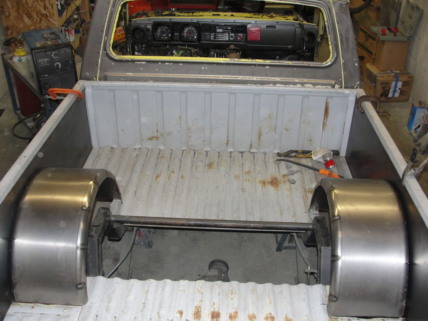

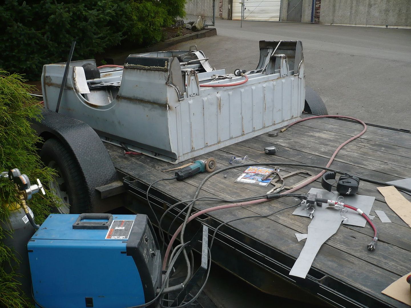

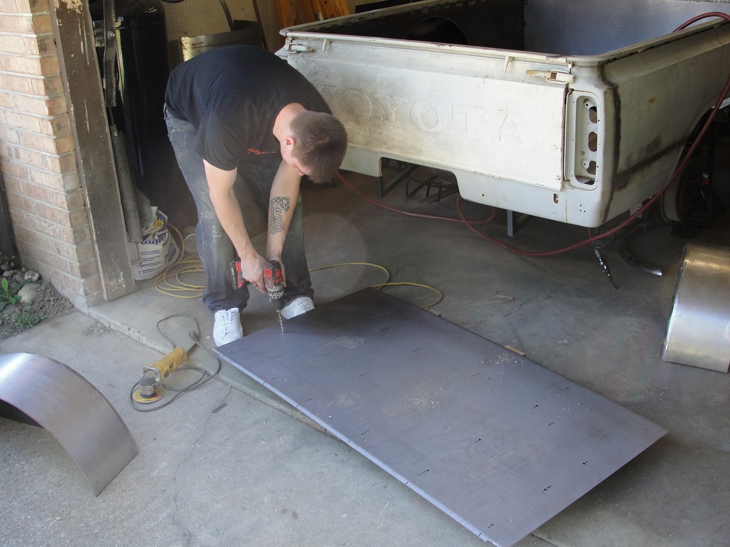

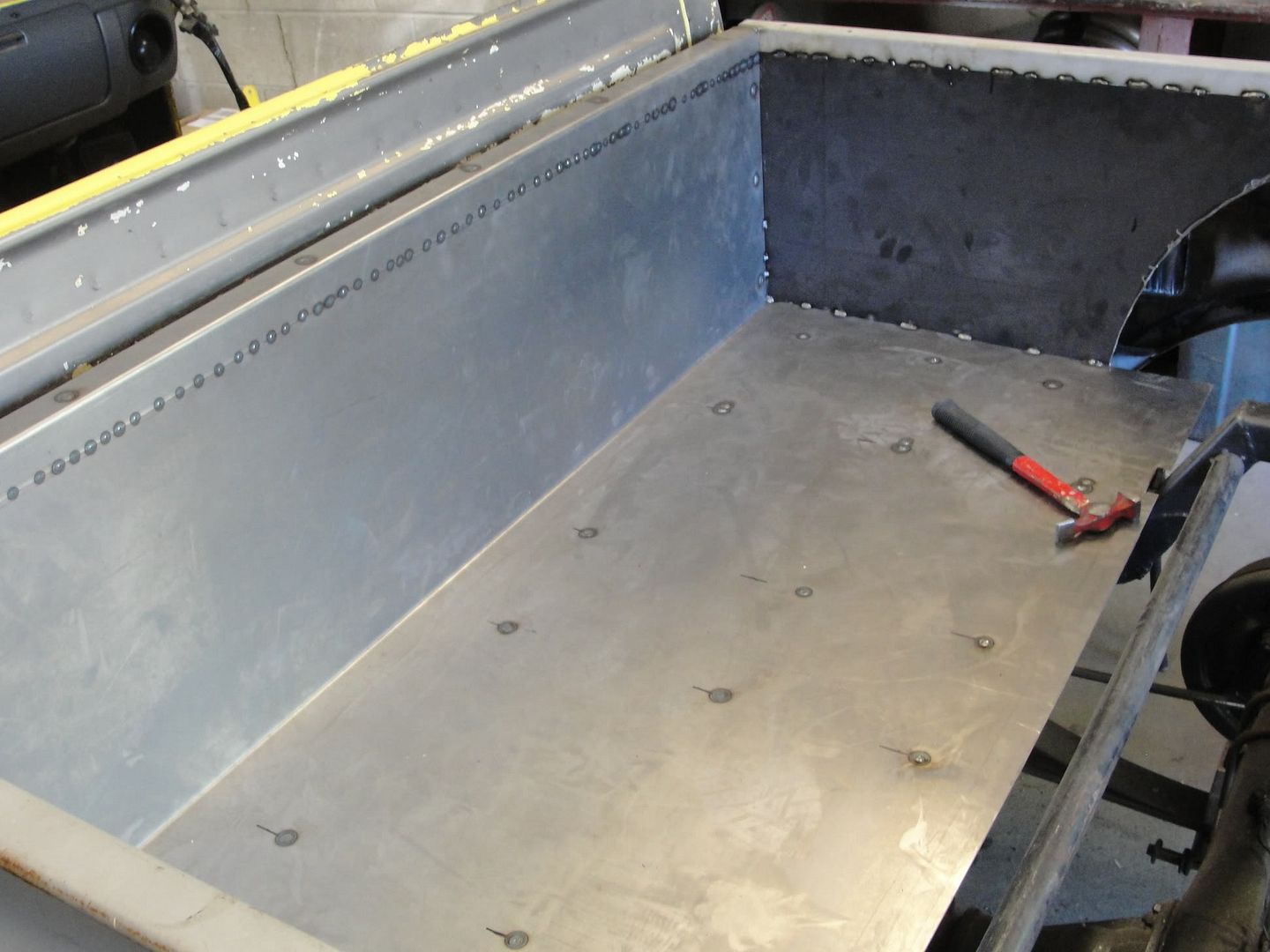

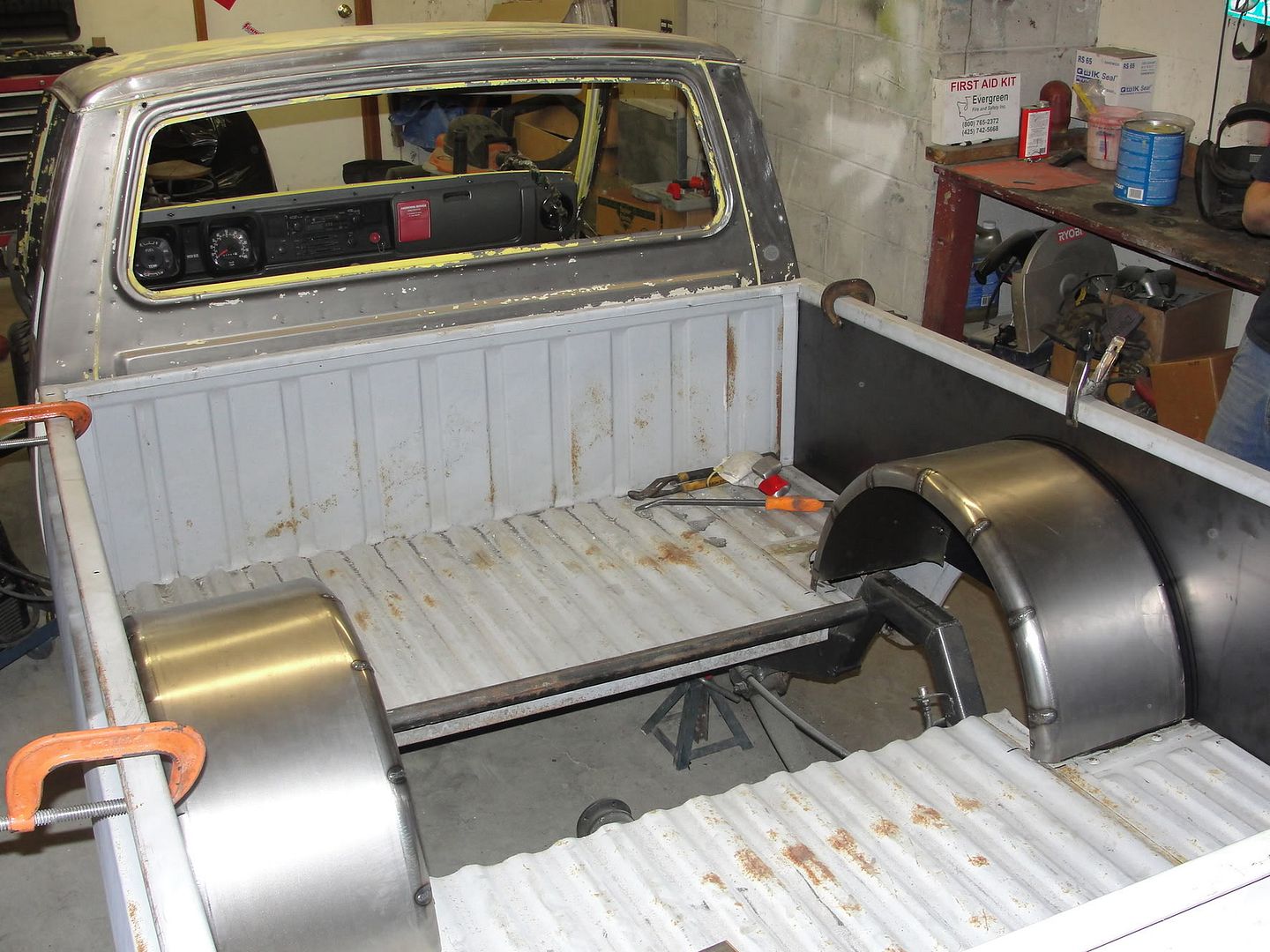

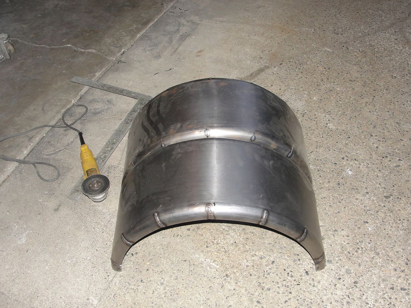

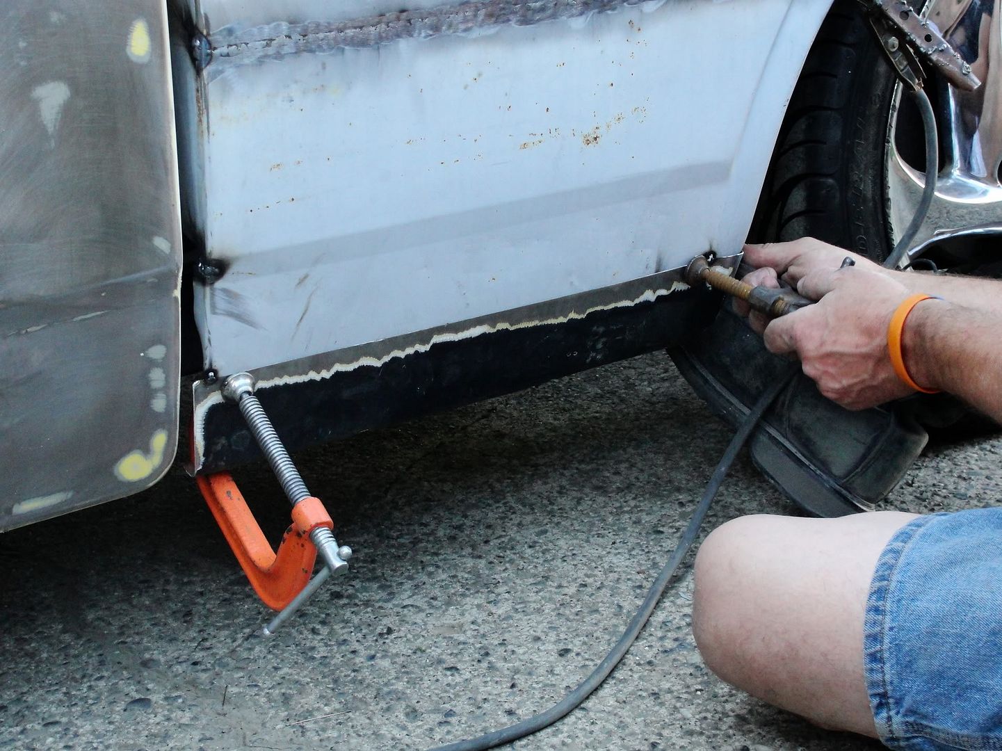

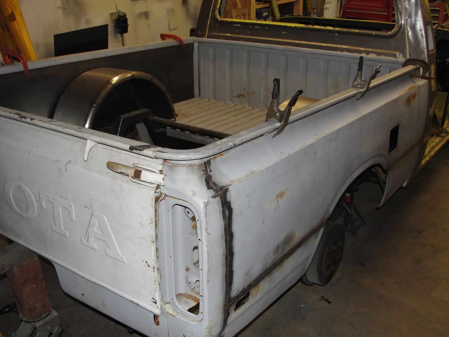

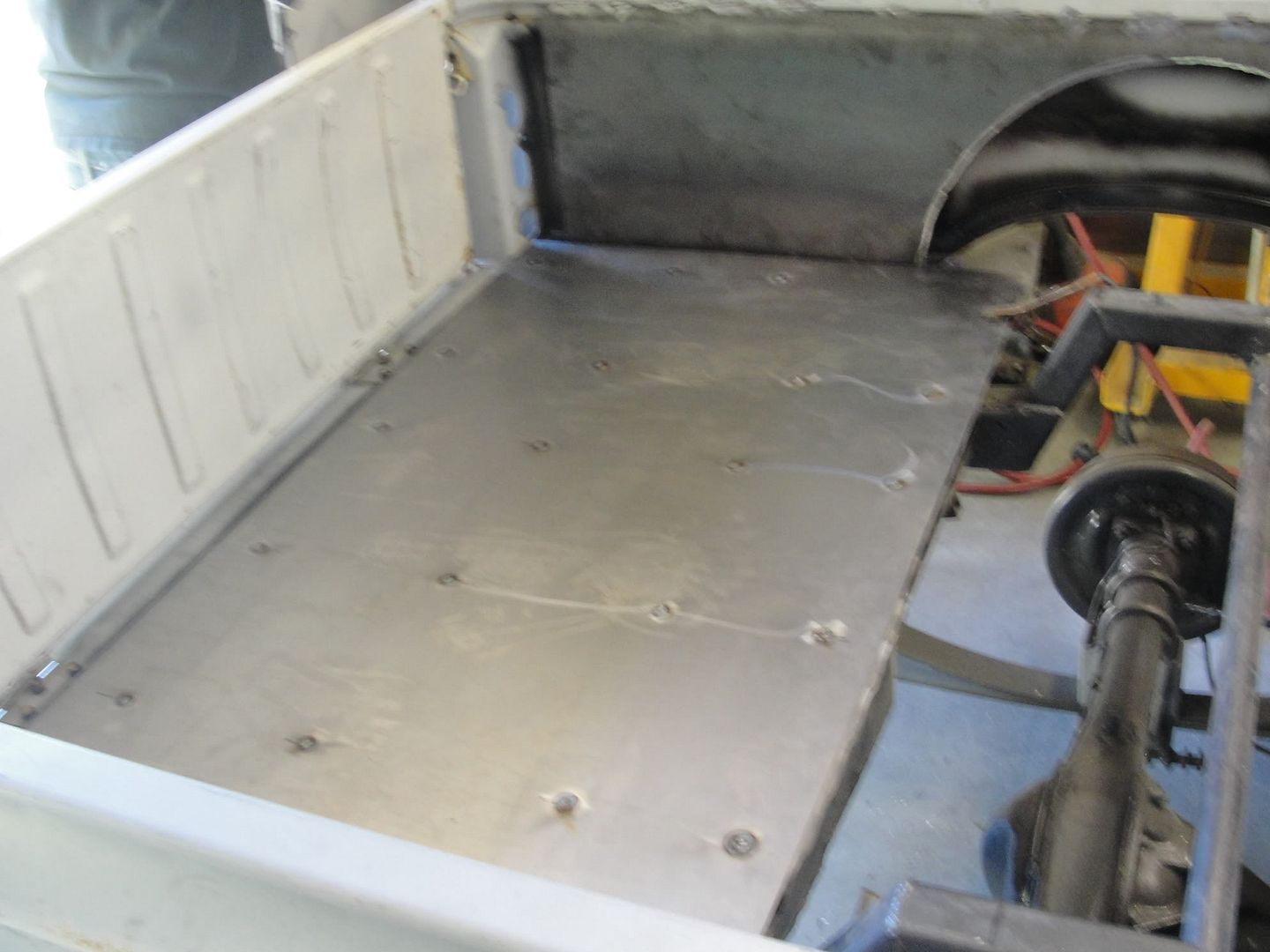

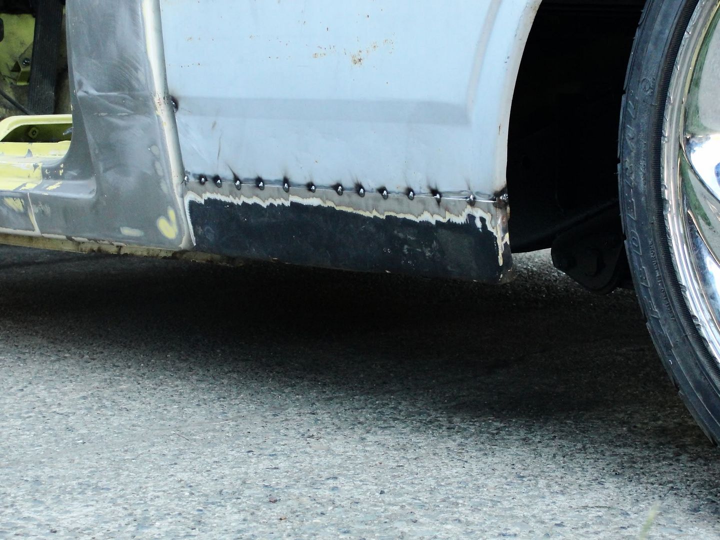

    got the rest of the shaving done and bed sheetmetal knocked out and brandon stopped by to tack in the lower bed extensions.

    sweet progress so far. those tires look tiny. if you end up wanting bigger ones for the back, i have a pair that are about 80% life. 225/50/16.

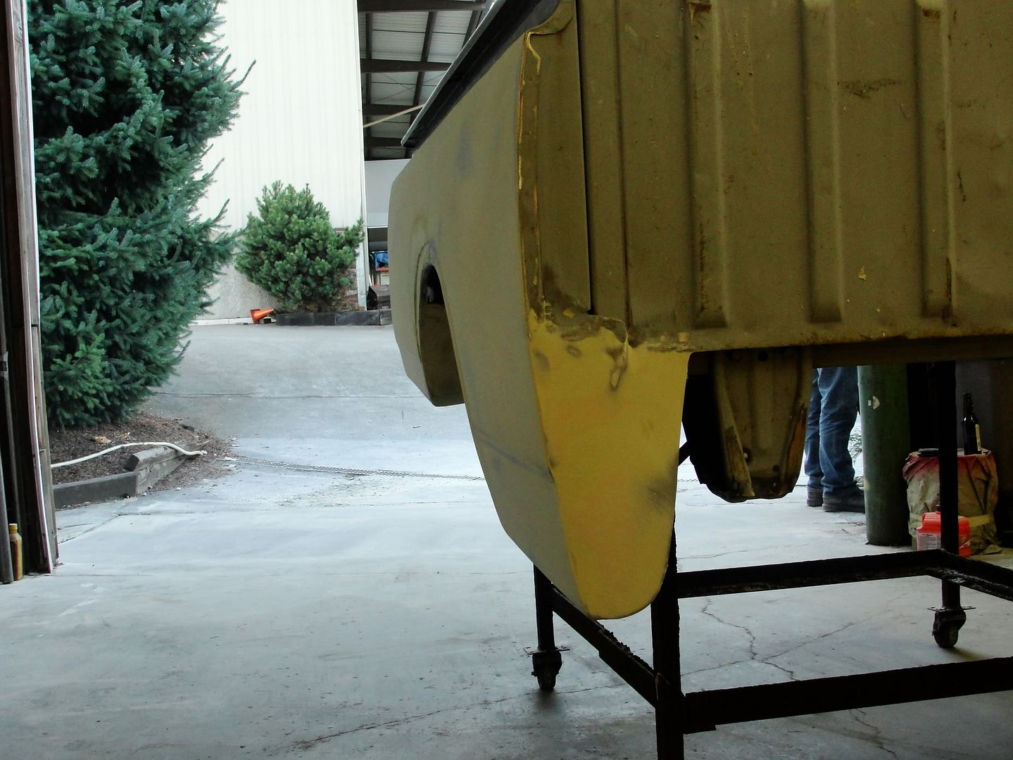

    are you gonna extend the back half of the bedsides down at all, maybe a taper to blend in?

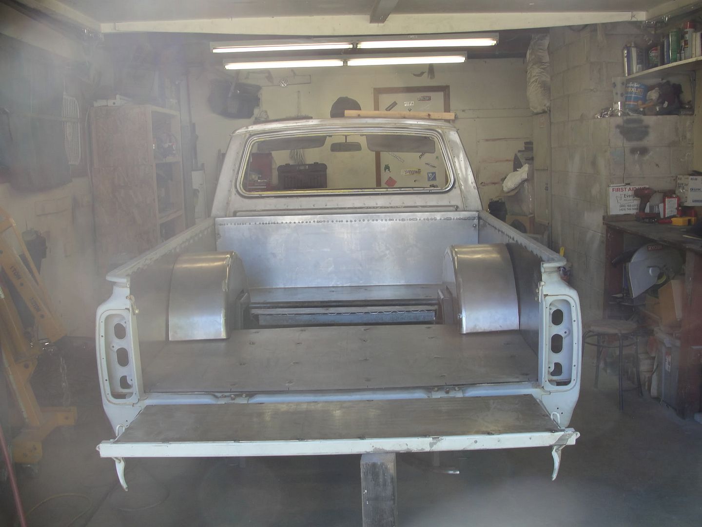

    i wish we could but with the corner and the taillights its super hard.. its gonna be fine. me and brandon knocked out the rest of the metal work on the bed in3 hours yesterday then got it pretty good in 40

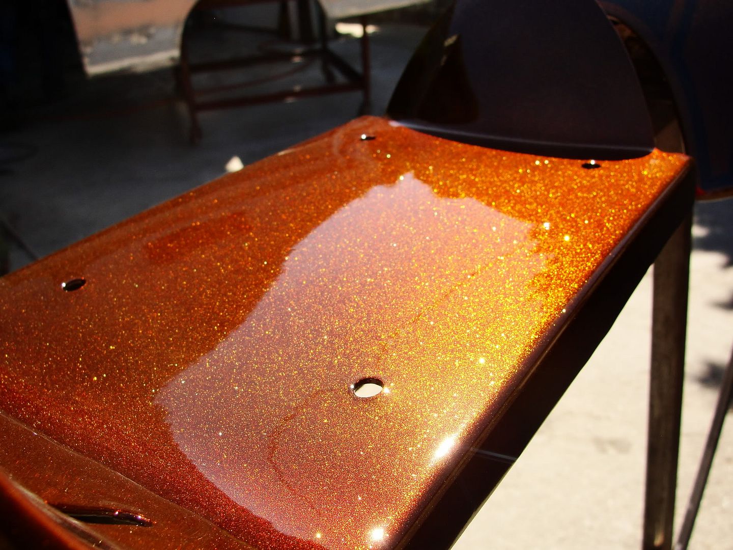

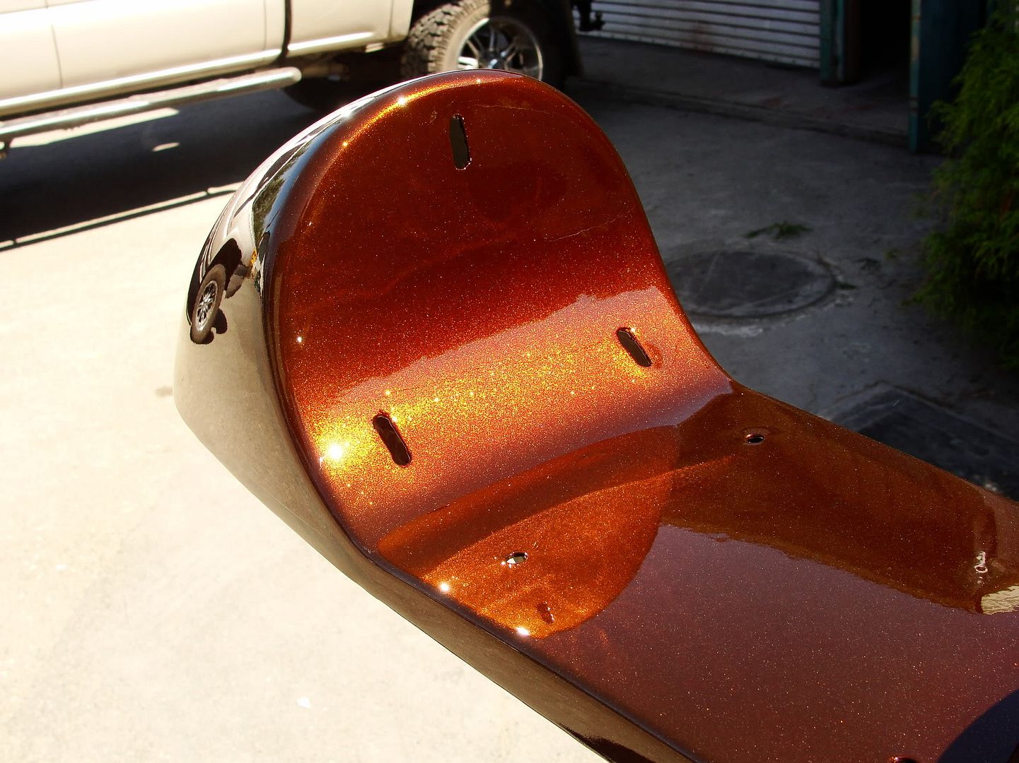

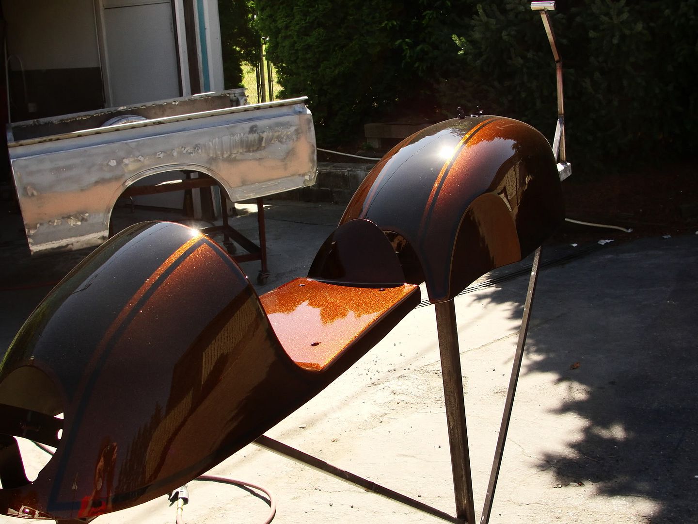

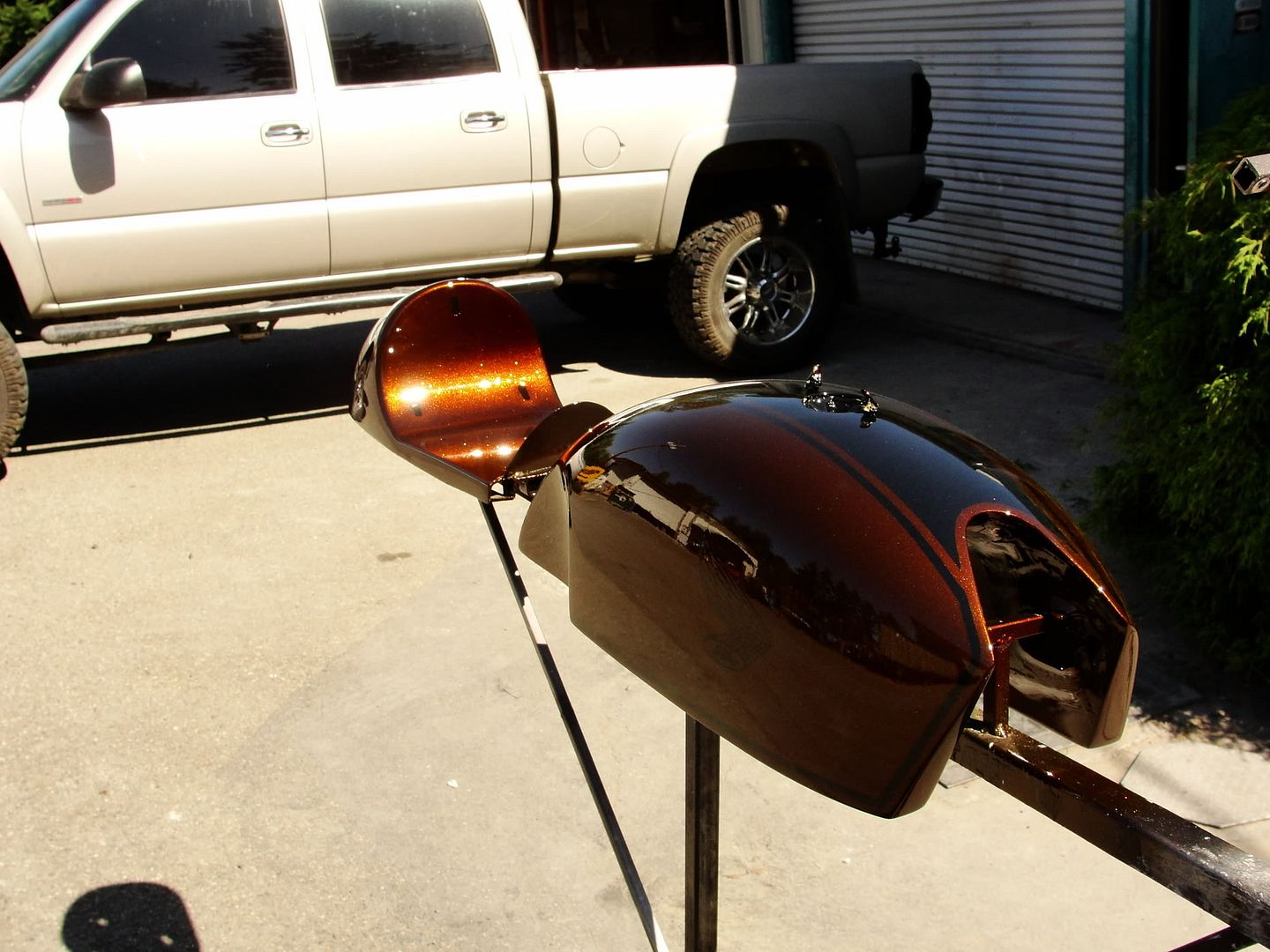

    heres the color

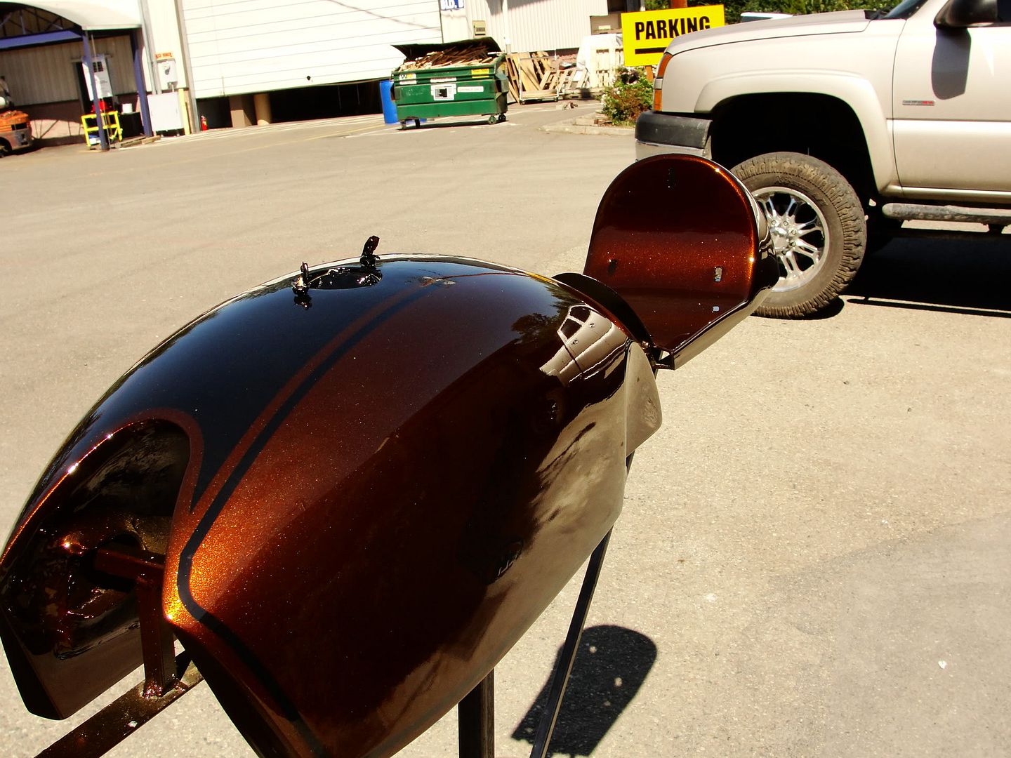

    sweet progress.. whats the seat cowl and tank going on? the paint on that is f'ing sweet!

    its a old nastalgic cb500. thats the same color we are painting the truck.

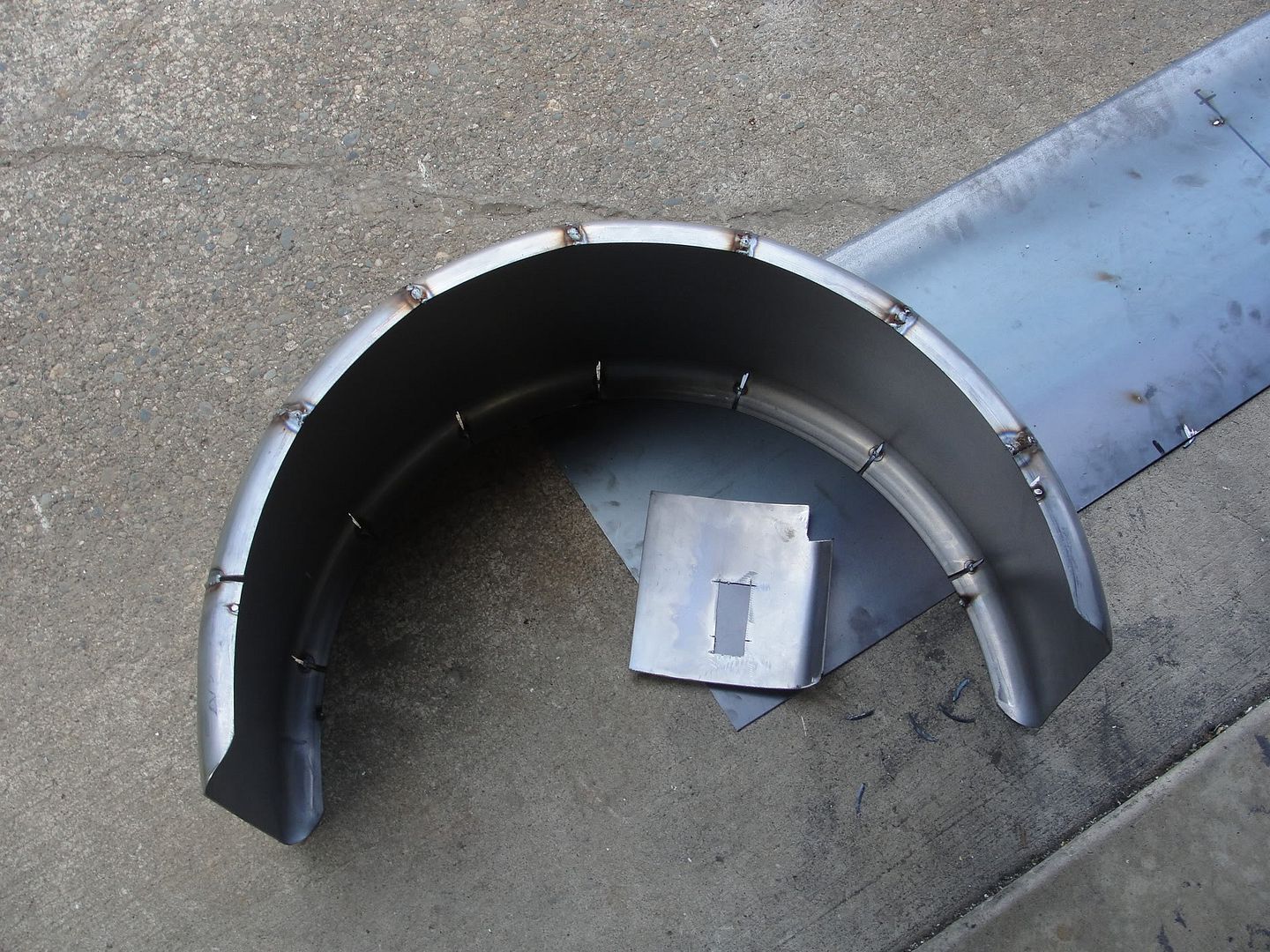

    got the link bars in and pulled the coils up front. got all my templates made for the bag brackets will have them all cut out tomm. and put it and get this bitch on air
