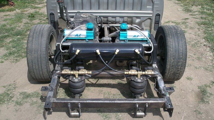

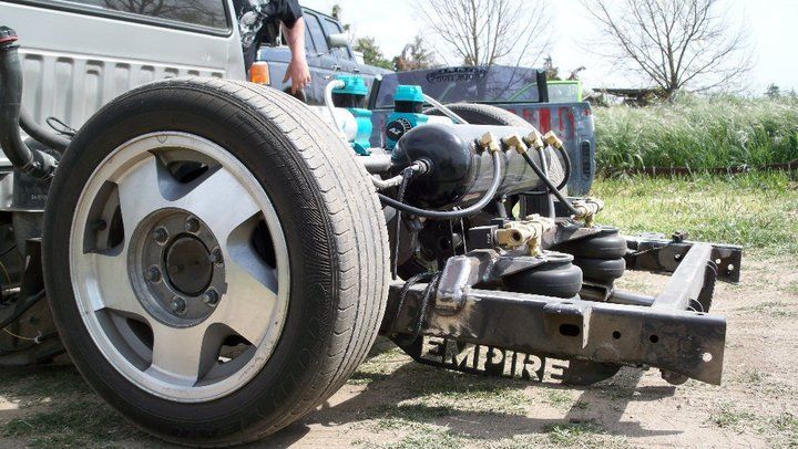

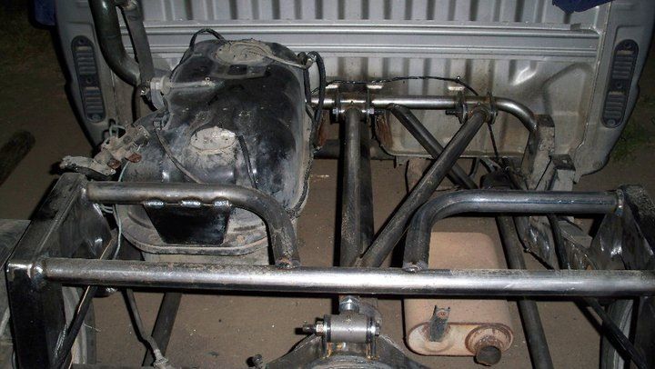

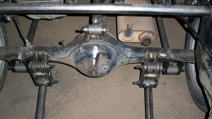

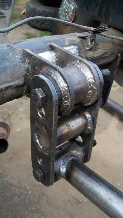

    You can raise the stock tank up like this. [​IMG]
    And put a lower link under it. Then run rear bar for the bags. Just put it on shackles or dog bones like this. [​IMG][​IMG][​IMG][​IMG]

    That's sort of the way I was walking for a wish one. Raising the tank is a good idea. My plan is similar to that. Only no rear bars, just some coil overs. Looks simple.
