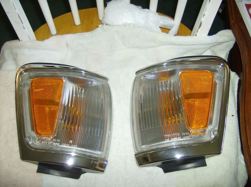

    Ok so yesterday i picked up some corner lights off a '95 4Runner for $20!!!!!!!!!!!!
    OEM pieces too.
    I smoked part of them this morning. Il get pics up later:D

    ON with the pics!!!!
    Stock looking

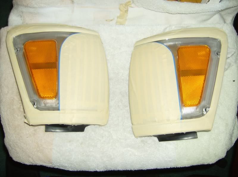

    Sanded and masked

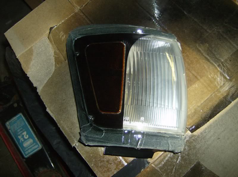

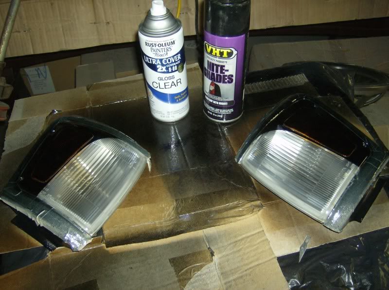

    4 coats Nite-Shades, 3 coats Clear
    Last coat of clear
    DRY!

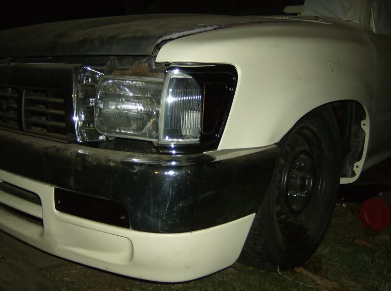

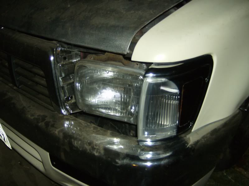

    And Night shots
    Day pics tomoro:cool:
