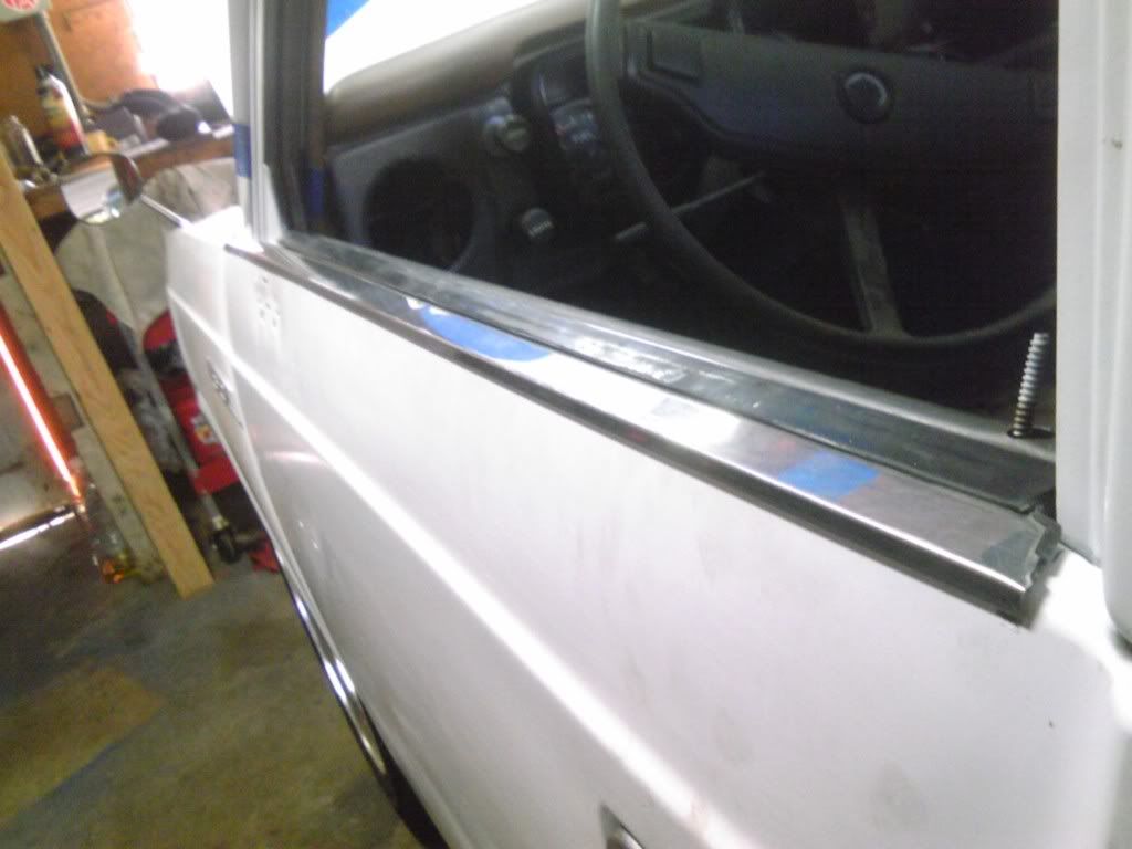

    I also snatched up the chrome door trim, looks tits!

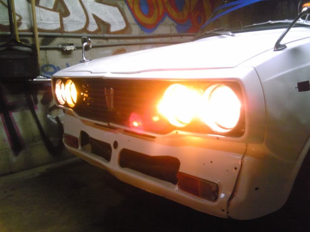

    Also on the headlight film, does it reduce the brightness of the highbeams?

    EDIT: Oh and no it doesnt seem the yellow hurts the high beams at all.

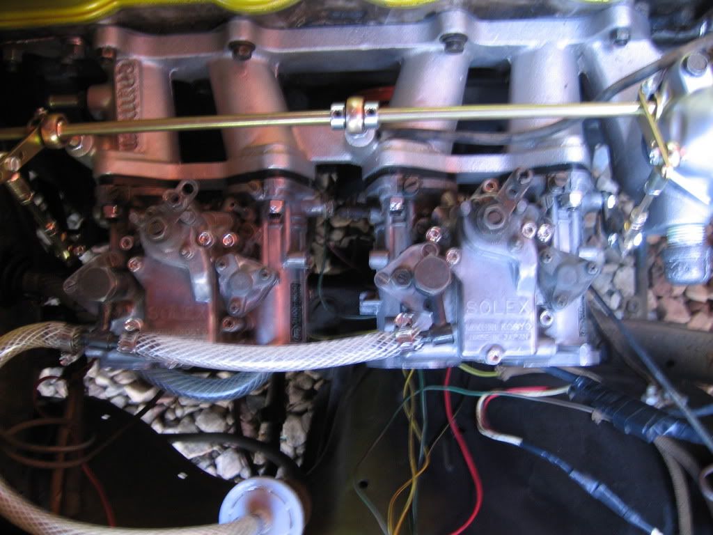

    Woot so I got the side drafts in thanks to six7one KDR:waytogo:
    They did start so thats awesome but they do need some moderate tuning and some velocity stacks, having a tough time finding them.
    But that brings me to my next question, any one have some tips or tricks to tuning them?
    P.S they're TEQ Mikuni-Kogyo Solex carbs, not sure what they came off of.
    Sorry for the lame pictures my camera has its days.

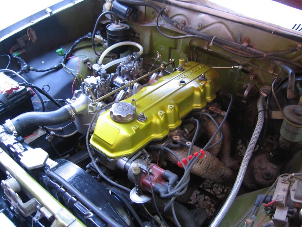

    I like the color on the valve cover. Where did that oil cap come from?

  16. Dgerfan55

    I 2nd that .... Where did you get that cap from?

    Thanks Pred, I call it "Electric Mt Dew" lol.
    And as for the oil cap when I bought the truck the PO, Tim, supplied me with a motor from a 78, that was the valve cover that came off it. So it would lead me to think it was some sort of late model option, only fits that valve cover, and its the only one I've ever seen.
