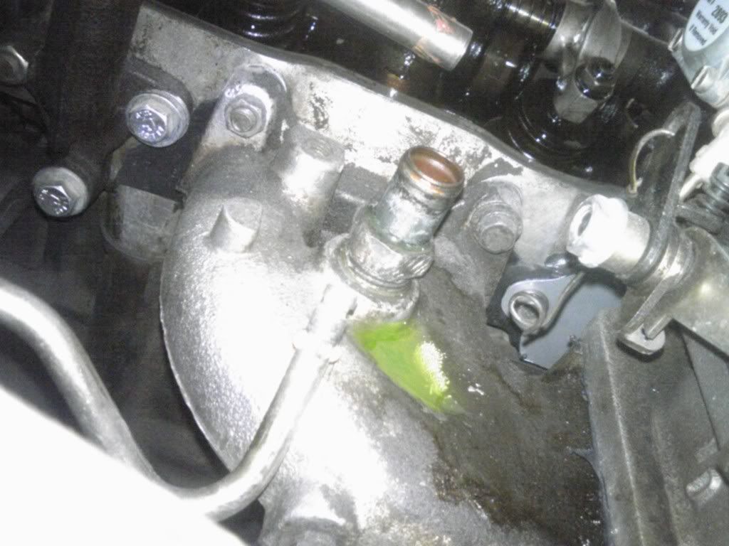

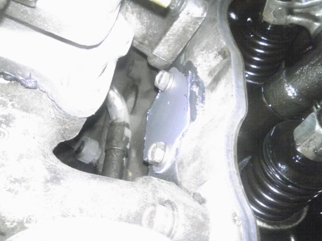

    So I did a bit of work on the truck today by making a block off plate for the old carbs water choke and it worked out very nicely.
    But I need to find a home for the other water lines. Heres what i have.
    This one is the line coming up from the intake manifold.

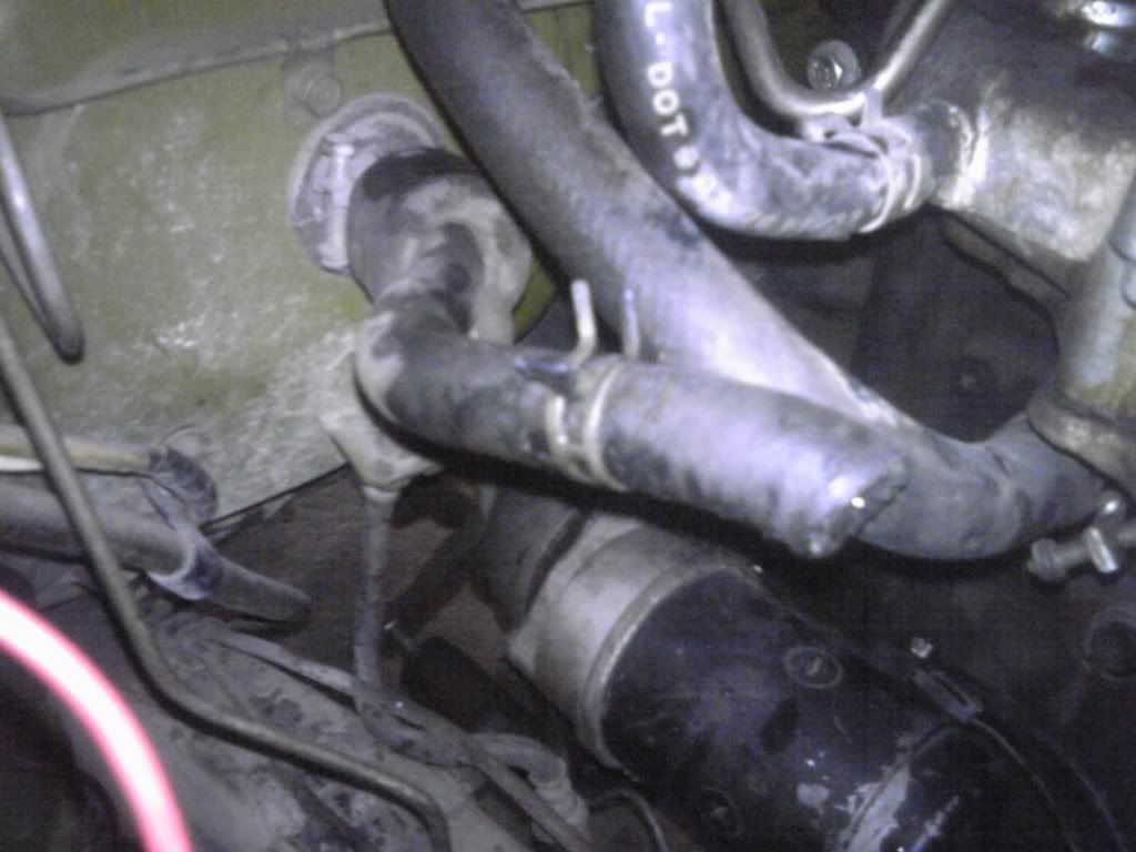

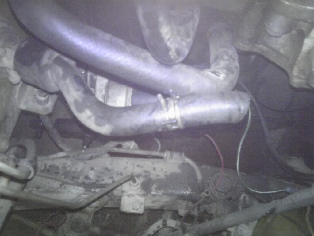

    Out of the firewall.
  18. The Crowing
    The Crowing Enthusiast
    Aug 9, 2009
    189
    Colorado
    1976 Toyota Pickup
    Ok so here's what I have going on right now.
    The line coming from the "water choke" was running into the firewall wich makes me think it goes to the heater core. Another was the one coming from the back side of the water pump via the steel pipe running the length of the block so using another length of pipe I plumbed those two together. Then looking at my manifold, another manifold, andother head, another motor, and my side draft manifold I decided the the small pipe running up out of the manifold is probably useless so im going to plug it and see what happens. Hopefully the coolant path is correct.
