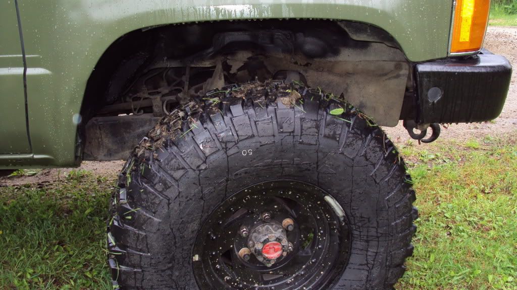

    I tubbed the firewall back to the cab mount. I was careful to make sure the clutch pedal has full compression.
    Driver's side just welded
    Passenger side with seam sealer and rocker guard
    33's should be no problem now:)

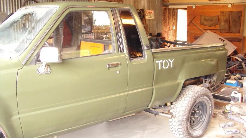

    1st layer
    I sprayed down my first layer of rattle can camo green. I like how it looks. But my bodywork is not perfectly smooth. I don't mind much though since it is only a 4x4 and will be getting scratched up anyway.

    uhhh, not sure why you painted the middle of the axle silver its all one piece, if you didnt have a drop out style rear axle like a dana or corp axle it would make sense the center section would be different piece but....anyway all the body work on the bed doesnt look to shabby looks almost factory nice

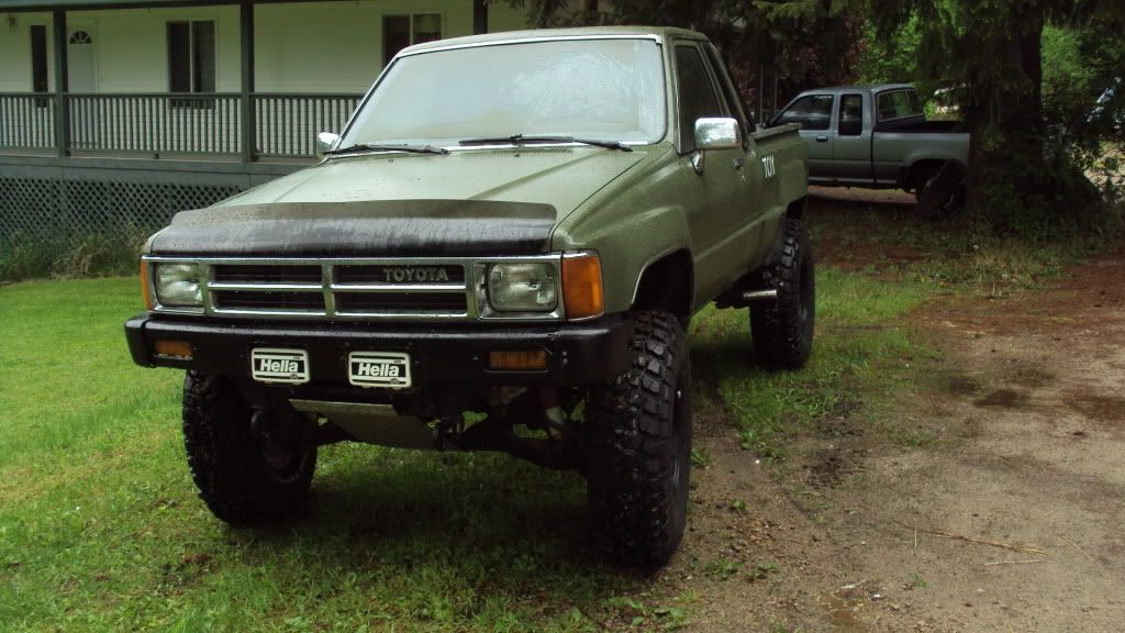

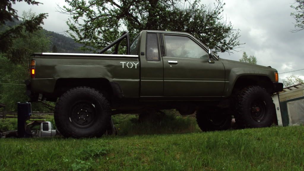

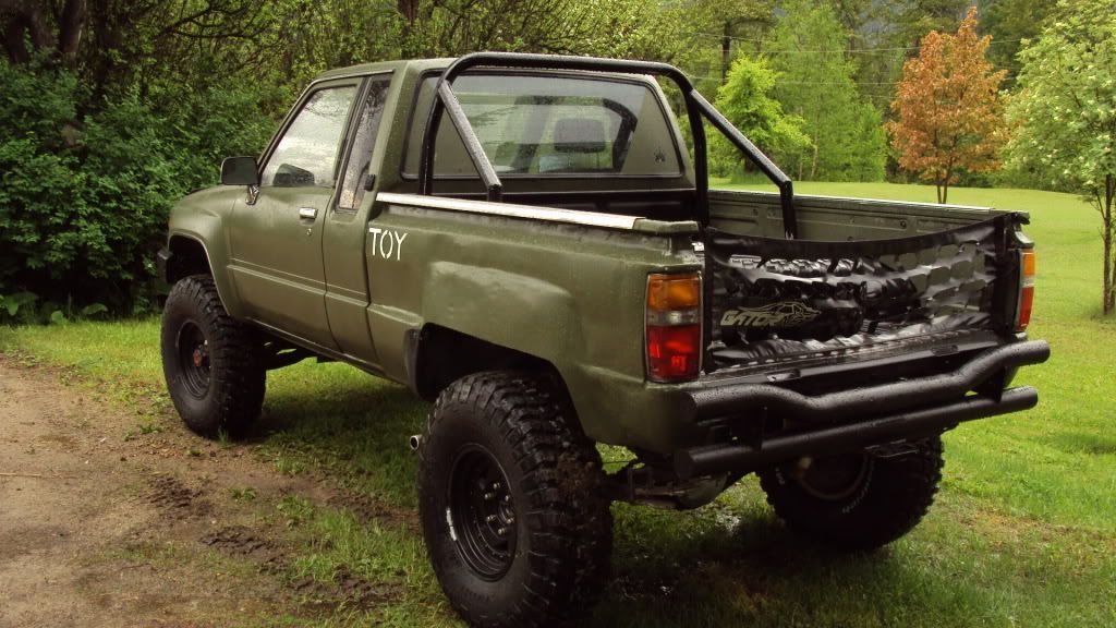

    New look
    Well I have an inspection and new windshield coming on Thursday. It is raining today but I got my new tires in town and installed them. It looks totally different now. I took pics.
    I need an alignment:
