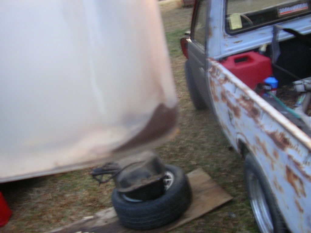

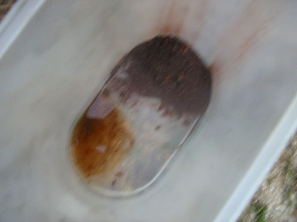

    Finally pulled my gas tank, weather was nice enough. The hoses needed to be replaces anyway, and was getting a lot of fine rust in my fuel filters, which I have 2 of them... Hope nothing got into my pump or carburetor.
    But that gas tank is full to the TOP. Going to drain it and buy some stuff to clean it once I have cash to spend on it. Buying a 97 pathfinder right now my moneys tied up in that.

    Did you pull the bed to get to the tank or did you just do it from underneath? Started to pull mine this past weekend and one of the bolts holding the bracket snapped on me.
  4. Comrade_Charlie
    Comrade_Charlie Veteran
    Oct 12, 2009
    340
    Rock Hill, SC. Charlotte, NC
    1973 Hilux
    Did it from underneith, was only 6 bolts, its been pulled by someone in the past, 1 of the bolts was missing, I had to cut one of the lines it was so dry rotted and wouldnt come off. On mine the tank is bolted to the bed not the frame. so pulling the bed wouldnt do anything

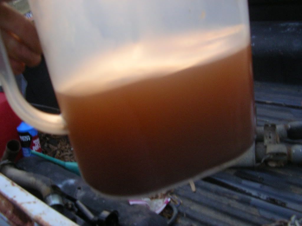

    found out why it quit running. The fuel filters looked fine when it quit, for some reason they dont now, weird. Maybe it was too dark to notice it. But tons of fine rust got in there... Hope it didnt mess up my pump or carb. I think it just clogged the pickup when it quit running, the bowl in the carb wouldnt fill up and nothing come out of the lines when I turned it over or had a electric pump on it
    any way pics are fun., aslo im getting a fuel cell and mounting it in the bed for more clearance under the truck, going to find a tool box with a lock on it and cut the bottom of it out and mount it over the fuel cell in there... Tired of dealing with gas tanks under stuff.
    sorry they are such big pictures

    Oh, wow - damn. That is bad. When I siphoned what remaining gas there was in the tank all kinds of grainy crap was coming out. Starting to rain before I could get much out. But I imagine it isn't going to be much different than what you had.

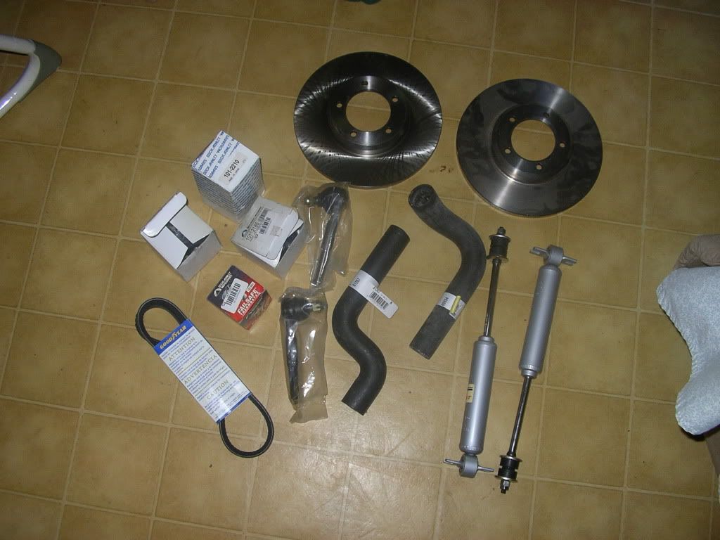

    UPDATE:
    lol
    Ordered parts for mah truck.
    -3ball joints,
    -outer tie rods
    -brake rotors for a 77
    -thermostat
    -kyb front struts
    -window crank handles
    -both radiator hoses
    -control arm bushings
    -exhaust flange for my exhaust
    Going to get the calipers from auto zone they were cheaper there, if they need to be changed, I just got rotors because thats pretty much a given, everything else I got at rockauto

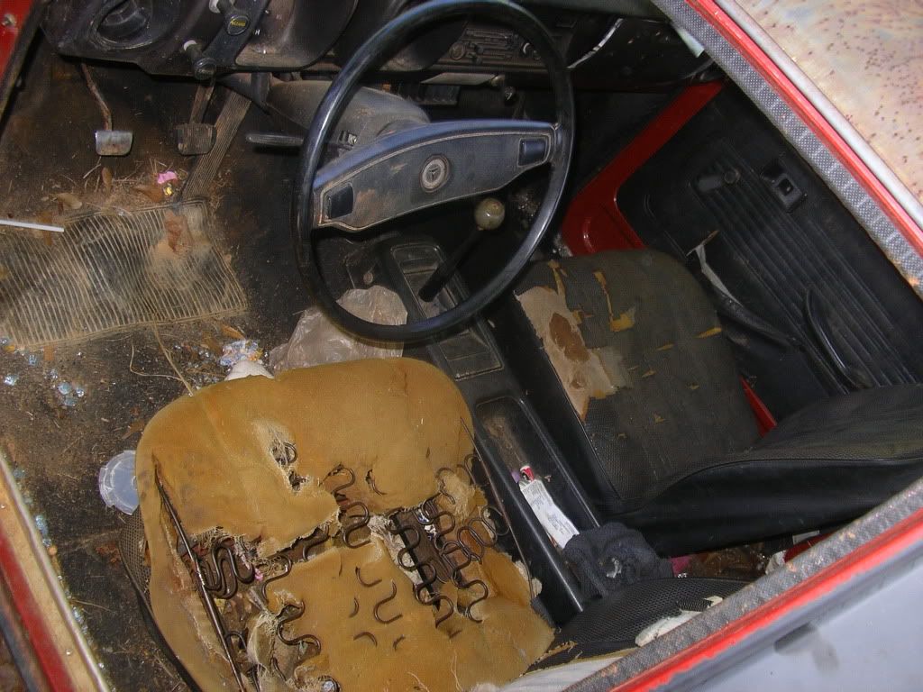

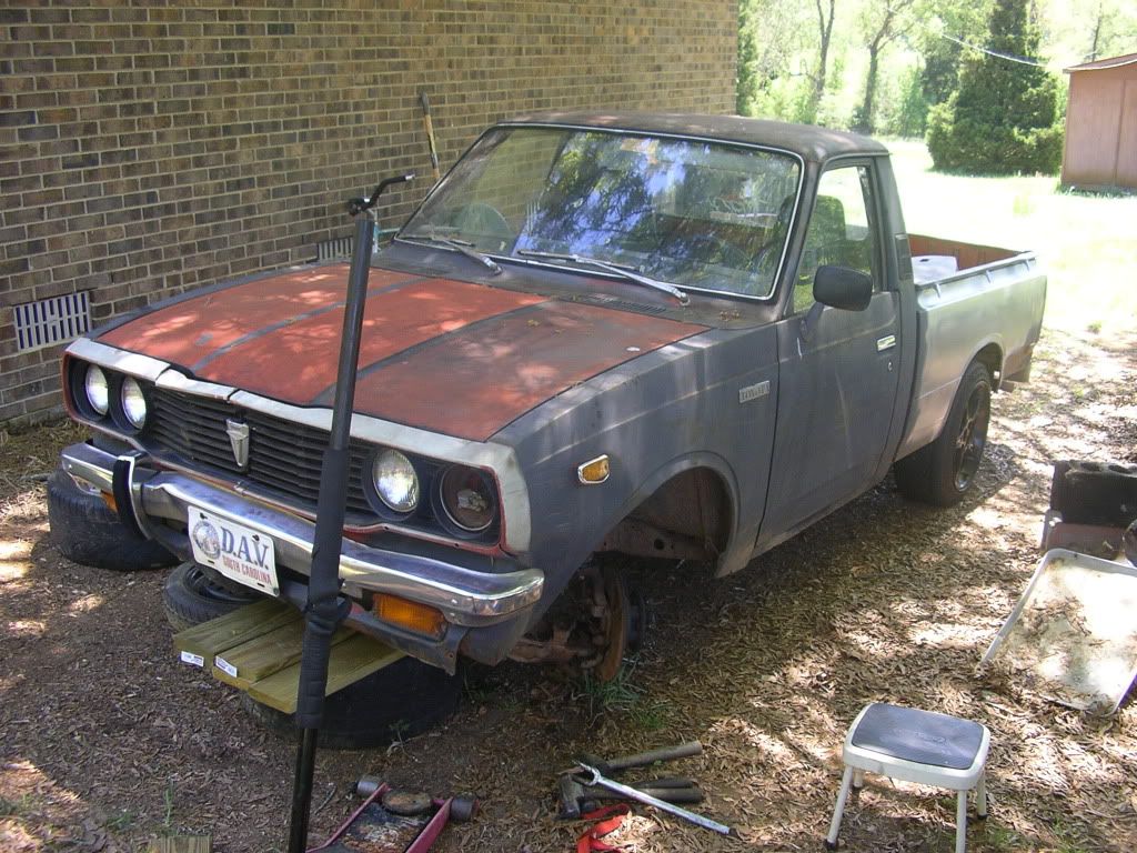

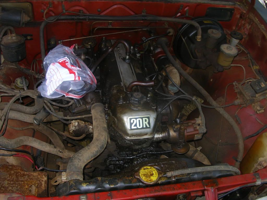

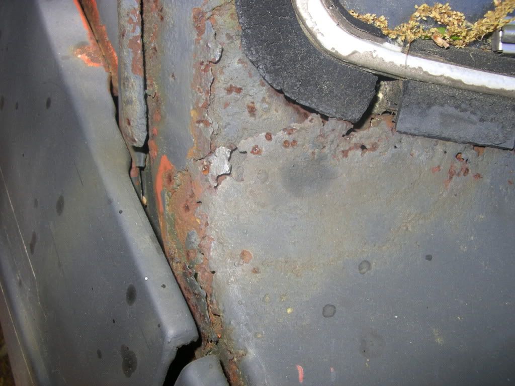

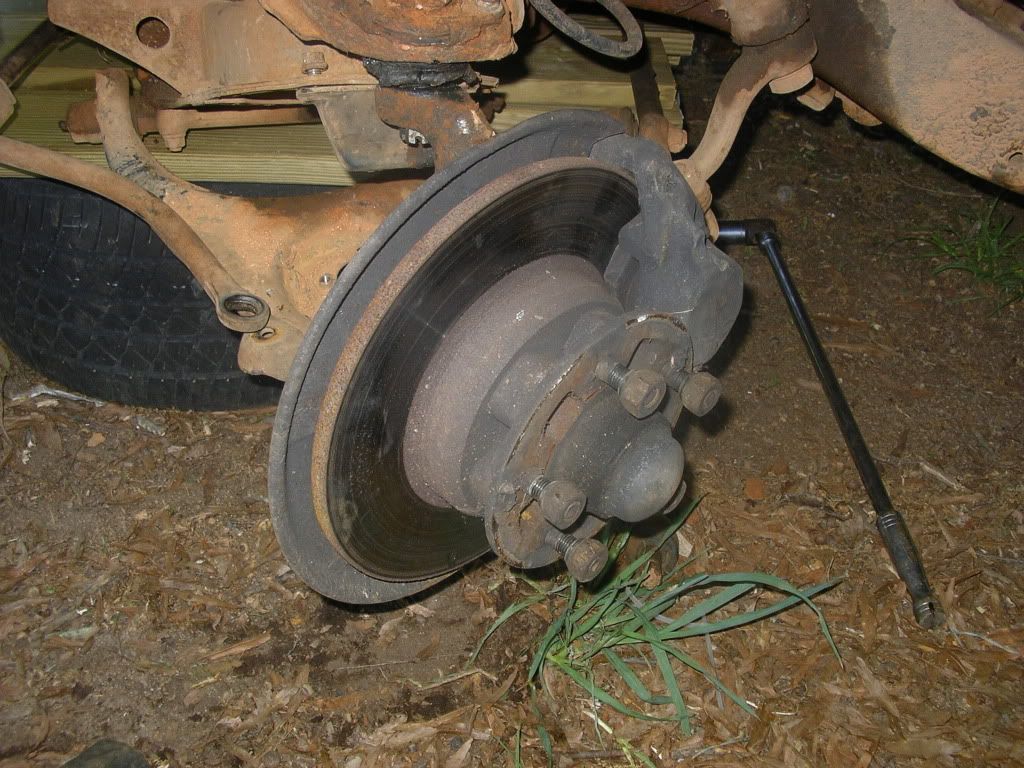

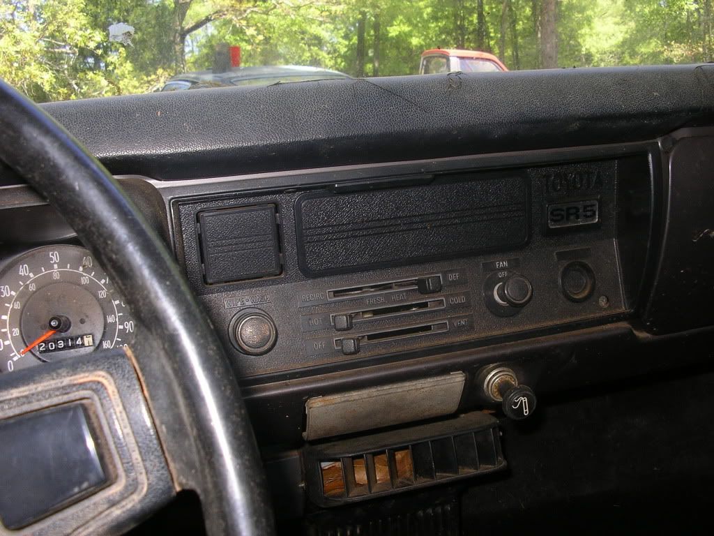

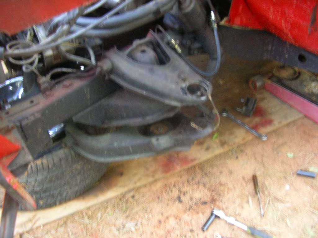

    Got my parts in, and got my parts truck...

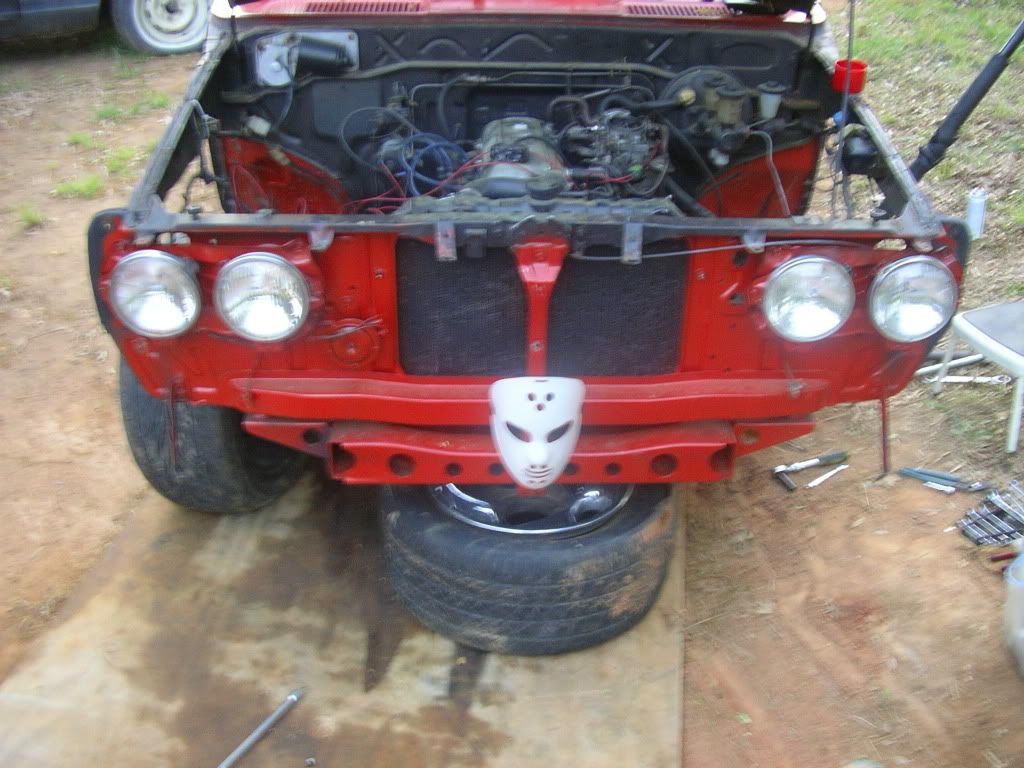

    The parts truck runs, drives but is kind of scary, steering is iffy, brakes are iffy, cuts off because of gas pedal not coming back so I idle'd it down so it would rev sky high.... but this is the oilyest engine I have ever seen so much oil on it it was smoking from burning the oil on the outside of the engine haha. I traded a gun and a scope that were worth about 270 new and I gave him 100 bucks for the truck, I had the gun for about 4 years and it wasnt worth 270 any more.... didnt shoot it much so I thought it was a heck of a deal, it has what i need hood, tail gate. Took about 60 bucks in gas and 50 to rent a tow dolley. 14 mpg in my brothers jeep.

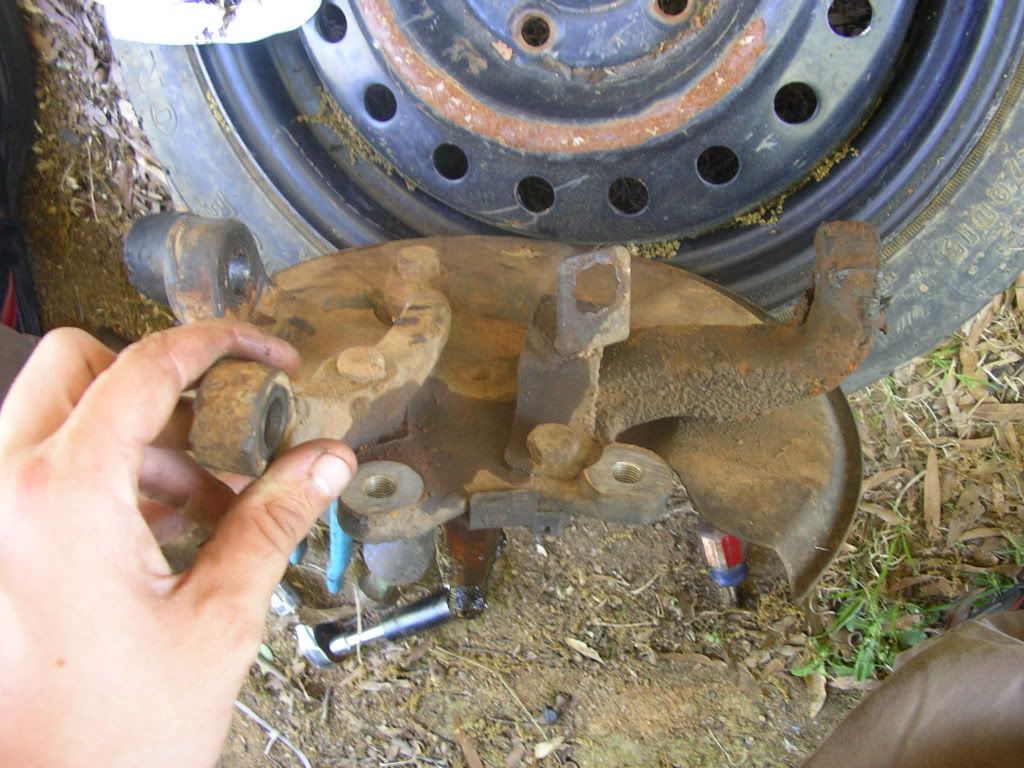

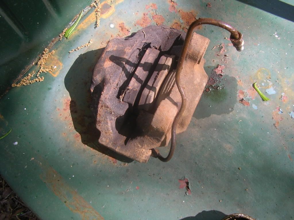

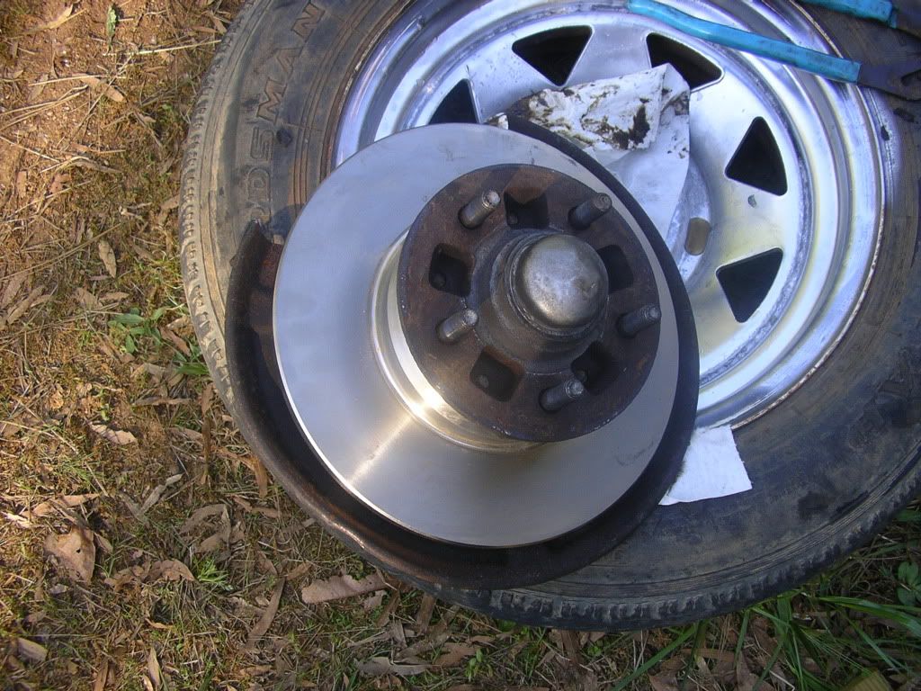

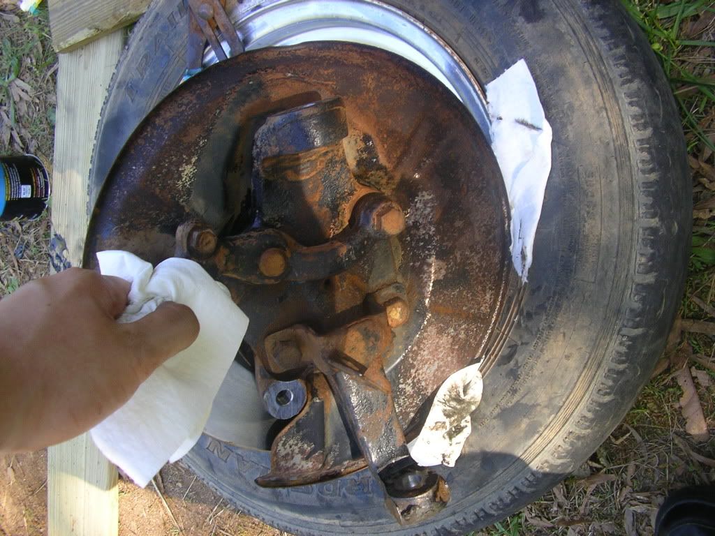

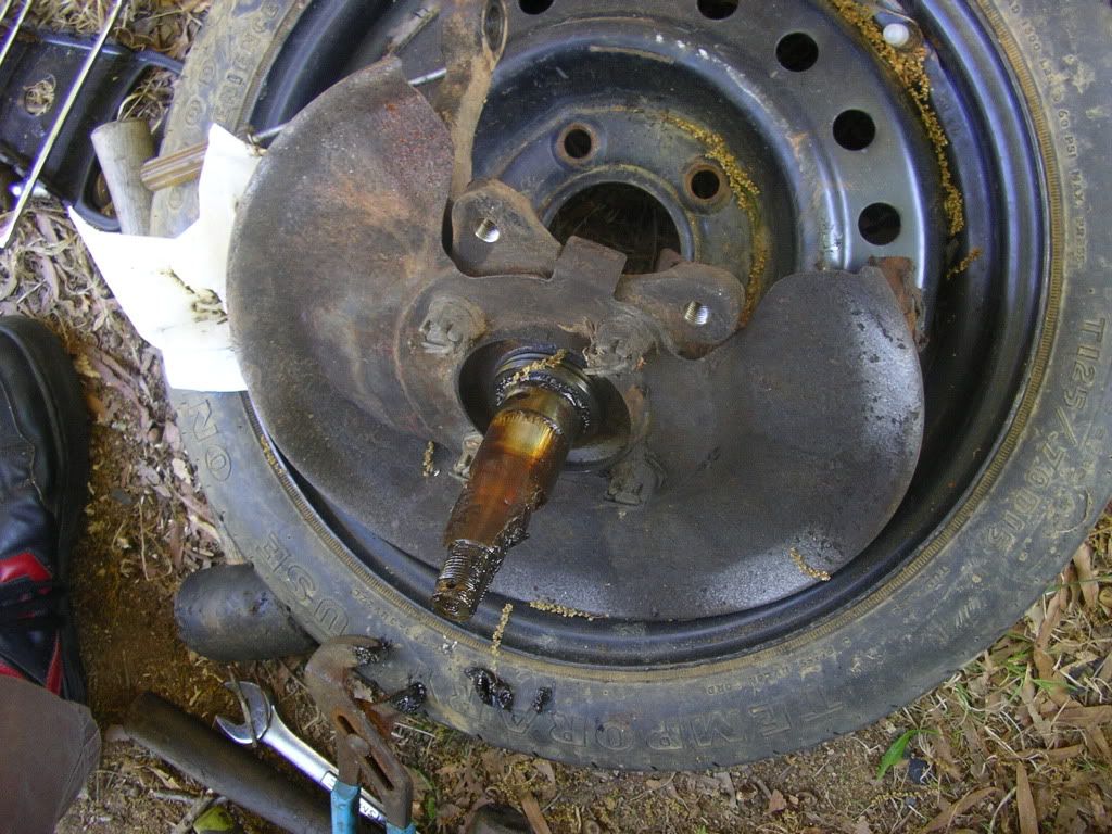

    But i pulled the brakes and spindles off, cleaned one side up so far, ordered new calipers and got new pads...
    200 bucks worth of parts lol, doesnt look like much
    77 sr5, only stuff im using from this truck are the spindle/knucle, tail gate, hood, some dash parts, maybe the front grill. Might use the rear end, I think its a 4.11, Not sure what my 73 is as the fenders were cut out.

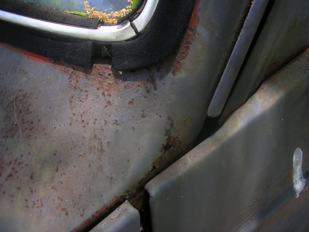

    some rust
    same place other side
    Its only clean where I wiped it.

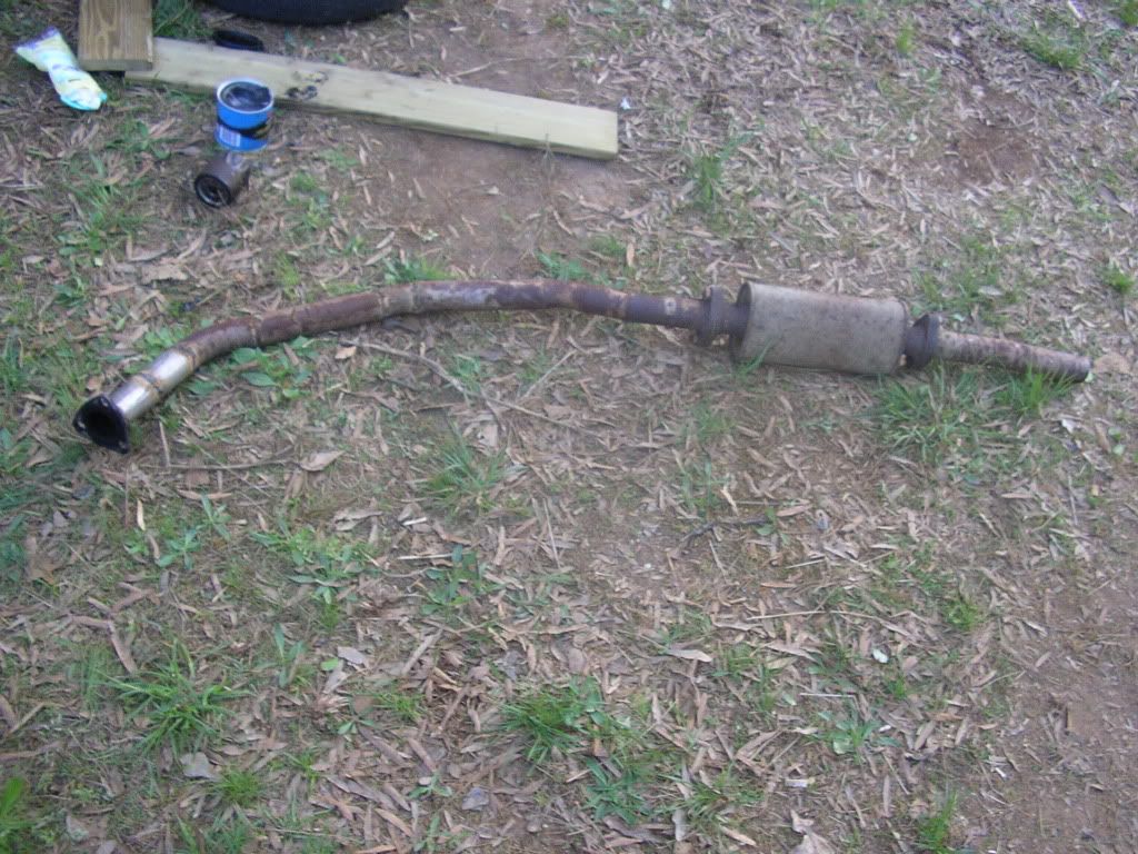

    Gotta love my ghetto exhaust, My first attempt at welding, I have the hang of it now, but that doesnt fix the bad welds I did :D
    the 73 getting ready for disc brakes.
