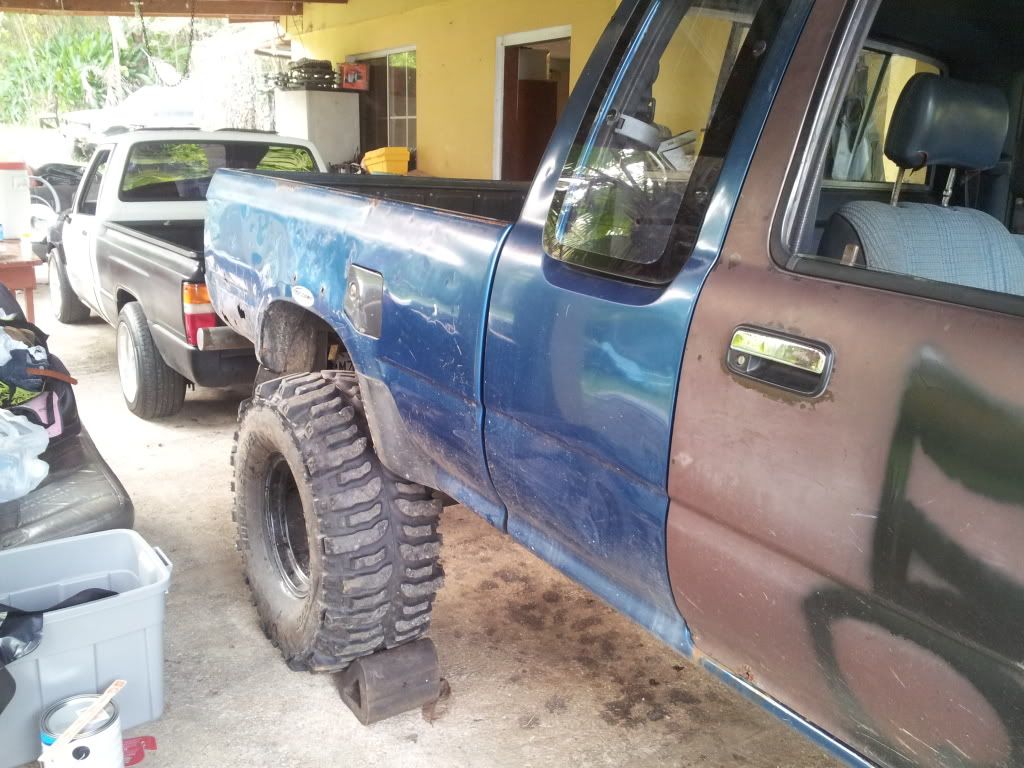

    Check this out.So yesterday I got the rear set of Boggers mounted and balanced.I can only do two at a time because all the weight in the back is causing my tires to rub on the rear fenders.Anyways I rushed home all excited to slap them on to see how they look.Mind you these b!tches are pretty heavy.So I put on the right side then moved over and did the left side.Took me a while and I was sweating pretty hard but I was happy and the adrenalin was pumping.So after I'm done I walk back a ways so I can get a good look at the truck to admire the new look and I realized I fkin put those mthr fakers on backwards.I was like"aah you stupid idiot".My wife even came out and asked me who am I yelling at.I just left it like that and plan on mounting the fronts today so I'll just switch them around one shot.[​IMG]

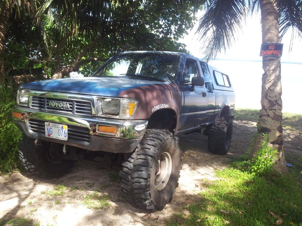

    Got the tires mounted on the truck(the correct way)and drove it around over the weekend.It rubs on a couple spots so I'm going to need to make a few cuts to the front bumper and valance and the rear fender.[​IMG]

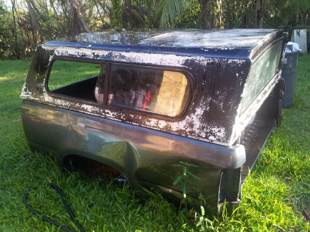

    Got a Snug Top camper from a friend for free.No back glass but over all pretty cherry just needs a paint job.The window looks cracked in the pi but its a reflection of my clothes line in the background.I painted it late yesterday afternoon and it should be ready to mount to my 4x when I get home from work today.[​IMG]

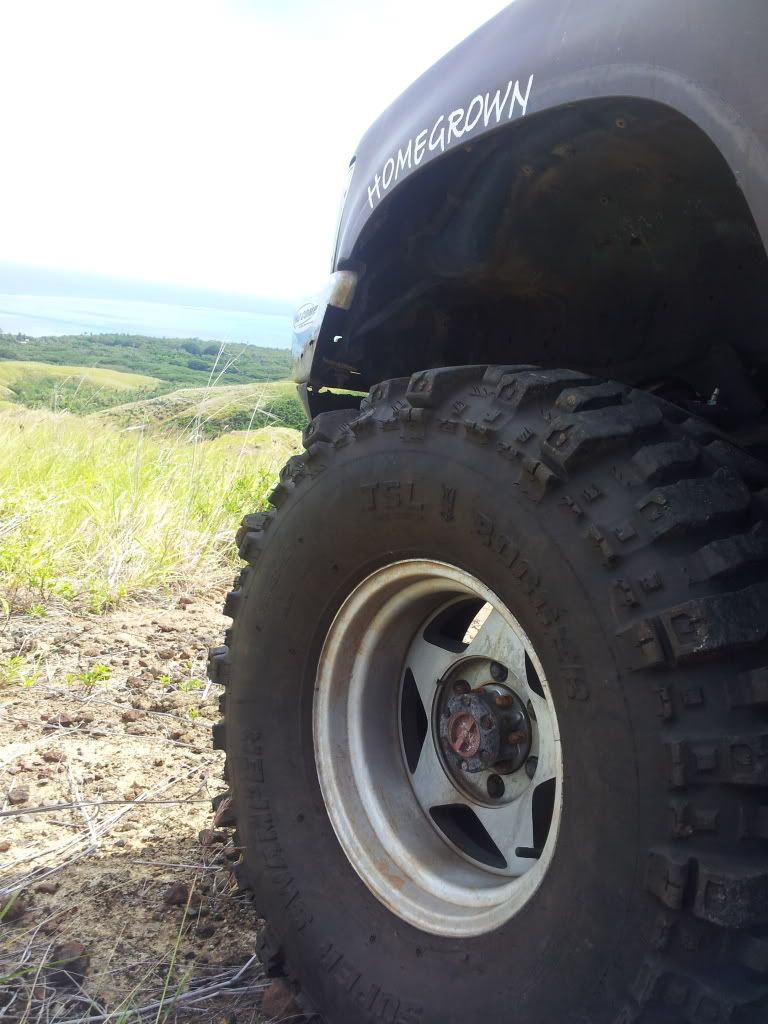

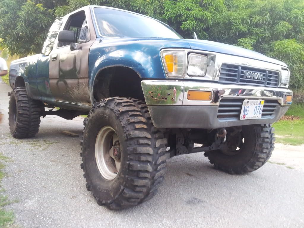

    Sunday with the fam at the beach.Here's a pic of the camper.Makes the truck feel bigger.[​IMG]I took the 4x4 on it's first test run up to the mountains on some pretty crazy terrain and besides a busted brake hose she did good.[​IMG]

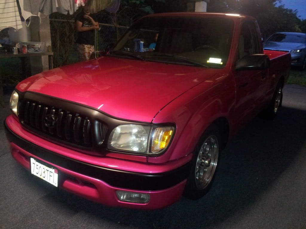

    Here's a pic of my bro-in-law's freshly painted Taco.Candy pink.Sounds crazy but it looks awesome.It changes all kinds of ways depending on the lighting.They used a silver base and some other expensive sh!t.I'll take some better pics later.This truck is going turbo soon so I hope to be apart of that build so I can learn.I will def post pics of that build.[​IMG]
