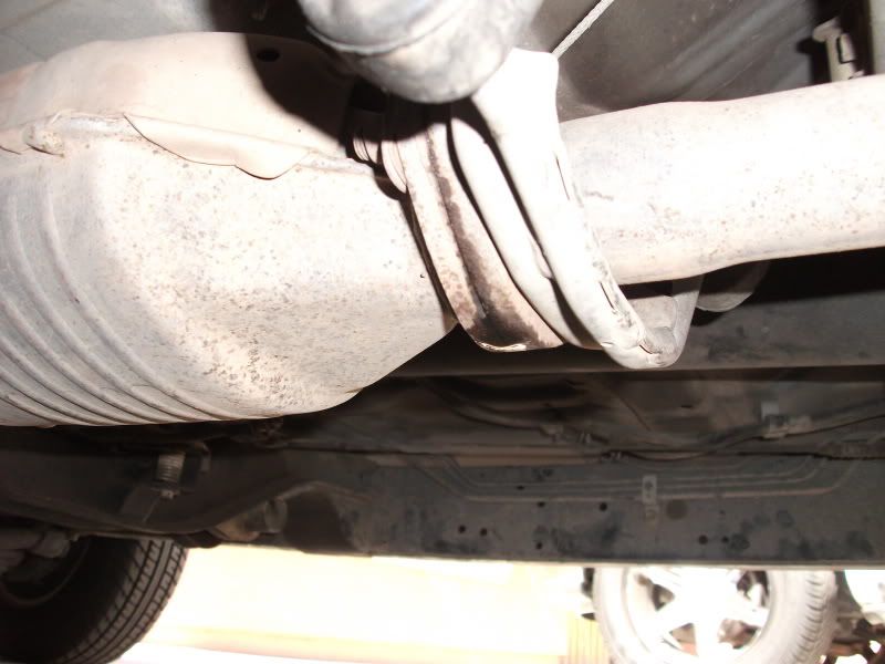

    Guess its time for a full rebuild, was just out this morning tearing into it and trying to figure out whats wrong.....then i saw to small puddles under the cab, oil leaking from the cat! More than likely thats piston rings right?

    oooo not good ^

    Seen that before... Looks more like water mixed with carbon, if that's oil there no way in hell that motor will run... Just my .02...
    Strap in for another HG job bro, it's definetly the culprit. Just cross your fingers the head isn't cracked or water ports corroded.
    You can do it!! :waytogo:

    thats wut happened to my o.g motor, i got oil in the intake, that motor was toast.
