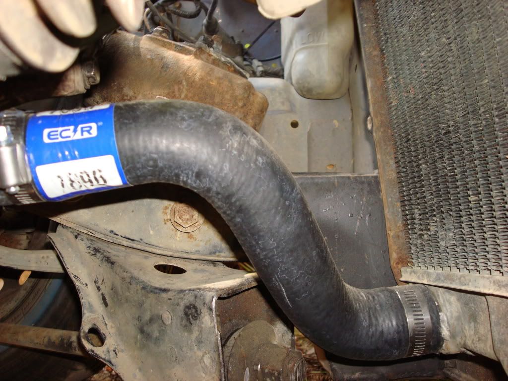

    I know I've been laggin' bro, but here's the only pic I have, and I'm not sure it will help much....
    If you notice the bar I welded across, right behind the front horns, I realized later that, once I test fitted things, my lower radiator hose would run smack into that bar. So for me all I would have to do is cut that bar out and possibly extend the hose a couple of inches, that's it. Again, sorry it took so long yo....
  14. Shadetree Mechanic
    Shadetree Mechanic Addict
    May 14, 2009
    602
    Emerald Triangle, CA
    '79 4x4,'89 short-bed 2wd, '85 4Runner
    Thanks for the info. No problem about the wait. It looks like I am going a different route with the lowers anyway. I am going to add a brace with a bushing like the ones that GrantH is running (a few posts back in this thread). Then I can eliminate the need for the crossmember and make a little more room for my lower radiator hose. Thanks for posting up the pic.
