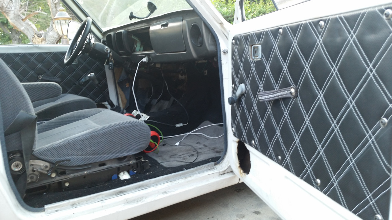

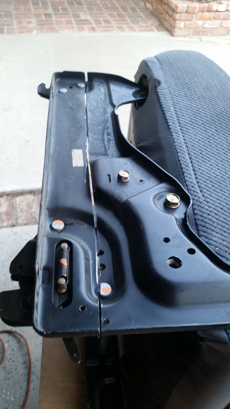

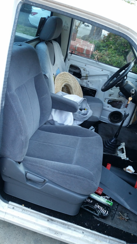

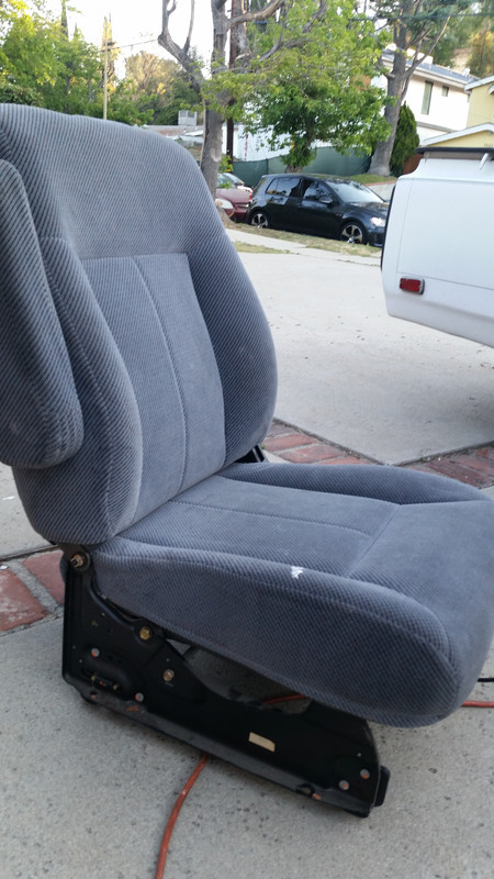

    I have made a little more progress on the interior of the truck, its a slow process but man is it fun. I was able to install the door panels and some seats I bought from junk yard. I found a second row captain seats from a Chrysler minivan in almost new condition. Then only bad part is the mounts are 4.5" tall its way to tall for the truck my head almost hits the ceiling and I'm not a tall guy.
    Passenger side of the seat, got a small paint stain but I will take that out.
    This is where I cut it cause its way to tall the seat it self is a bit bulky as well.
    This is what it looks like installed not cut yet its just to tall.
    Cut and installed(well more like placed in place). Not secured to the floor yet need to make/fabricate some sort of mounts or L brackets I can secure to the previous wholes in the floor. Also finally installed the door panels made the handles out of seat belt material just fold it and sow it. The rivets I installed previously worked great for this installation.

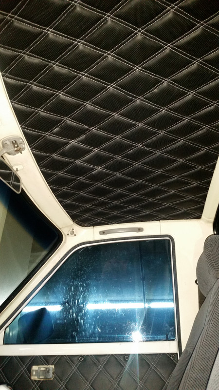

    Also installed the head liner in had to get this professionally installed. Could not do this on my own needed the special glue and some one with expertise in this. Cause the first one I tried I ruined and it did not stay on there longer then a week.

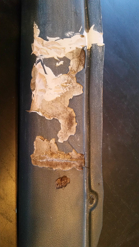

    Did more patch work on the dash, I dont know about you're guys dash was all cracked up and full of wholes. I plan on wrapping it with vinyl just cant have all the wholes in there.
