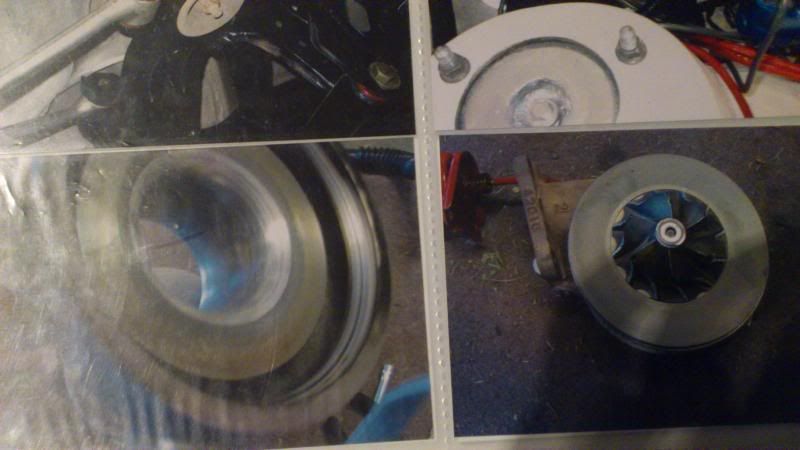

    I think I figured out that the failure was caused by compressor surge upon closing the throttle body, whereas the BOV doesn't seem to be operating correctly. I took the HKS SSQV III apart and everything looks ok, so I'm going to rig up a way to pressurize the pipe and test it with my vacuum pump. I'm wondering if it has a strong enough vacuum source, ie. if the vacuum line is too long, not big enough, or something.

    Your running such low boost. I bet it was just miss hap with the thrust washer then ate barings abit from a miss balance

    Well, I'm not running as low as I did before. I have MS controlling boost at 200 kPa and the thrust washer still felt great, no in and out play at all, just the side to side slop I'd expect to see from the surge I've been hearing. I was told that the HKS's sounded a bit like surge, but upon further research, that isn't the case. I'm testing the BOV with a rig I built today. We'll see.

    Wow! Interesting. I honestly think that I was getting some surge with that BOV, so I've purchased a different style. And I heard from Raffi at Turbonetics, who told me that it was actually a heat soak-back issue that destroyed the shaft and cartridge dimensions (took them out of spec), which then ate the journals. A timer wouldn't have helped with this, as I don't drive the truck hard before shutdown, and there were no signs of oil coking.
    Anyway, he offered to send a brand new water cooled unit covered under warranty, so I can't wait. I miss it so much.:cry:

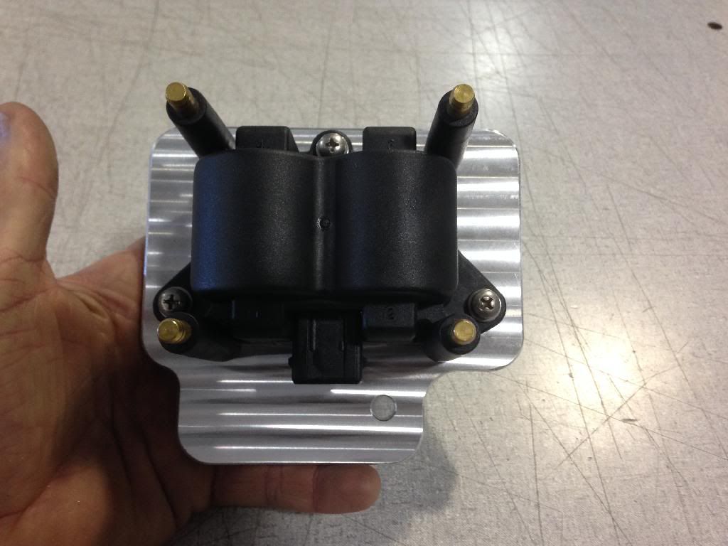

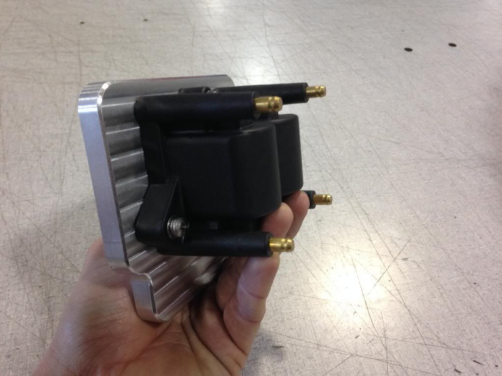

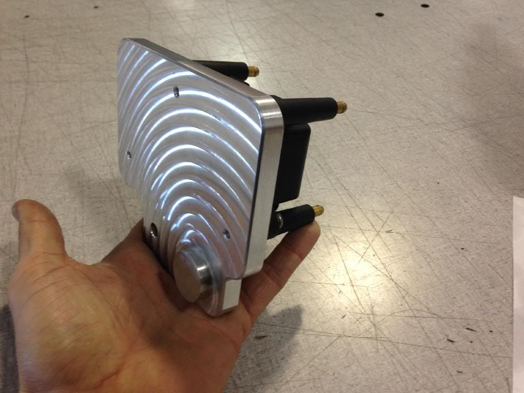

    Looks like I get to convert to a wasted spark setup today!
    Part I machined to block off the distributor and mount the new coils.
    I'll post pics later of it installed.

    magnetic trigger input on the crank pulley?
  19. Litneon
    Mar 29, 2007
    2,414
    50
    Cocoa, FL
    94 xtra cab
    Basically. Hall Effect sensor.
