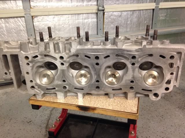

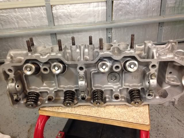

    Well, got my new Devil's Own water methanol kit installed. I'm running two nozzles. Wow does that make a difference in air temps.
    I'm currently running about 12 pounds of boost with a (still) conservative timing map. I figure it's putting down about 180 to 200 to the wheels right now. I finally decided to build my new head with the oversized valves and dual springs/ titanium retainers, so I'll probably swap that in on Thanksgiving weekend, taking care of a few other odds and ends while I'm in there.

    Did you do any porting or polishing of the intake or exhaust?

    how big did you go? my guy wanted to run ferra valves and they were trying to get me to buy some huge ones... full race motor status lol. told him id have to dial it back and we can redo it later when im ready for my big boy build lol

    Well, as of right now, I don't have the money to buy a different cam. I'm currently running a carbed 22r cam, but unless I can get a sweet deal on a better cam before next weekend, I'll stick with the same. You've got me thinking though....
    Did a bit more research, and these valves are only 1mm bigger than stock not the biggest, those would be the 48's that LC has. (These are 46's....)
    Yes, I did do a minor port job again. Didn't think to get pics before I reassembled though.
    I'll try to get another video up soon. That one was before the water meth injection.
