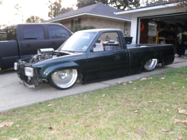

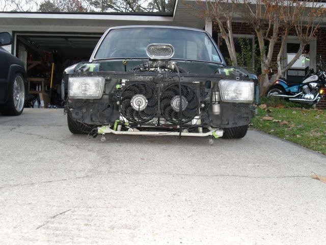

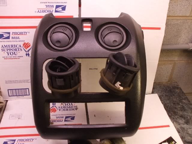

    I've been working on finishing up the core support so I can start this puppy. Also picked up some ebizzle parts. Vents to glass into my dash for the A/C.

    Nice, Hey where did you get your fenders from?
  3. V8_TITAN
    V8_TITAN Toyotaholic
    Feb 22, 2008
    2,616
    Tampa Fl
    89 std cab
    what car is that from ? looks good

    my mind is saying 350Z or Subaru, but i don't know. I'm wrong.

    those vents look like some off a dodge stratus like my g/f has

    They are. Stratus/Eclipse. All the same.

    The front cap came off a 4runner. Except hood. Hoods are all the same.

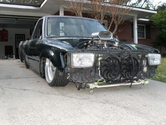

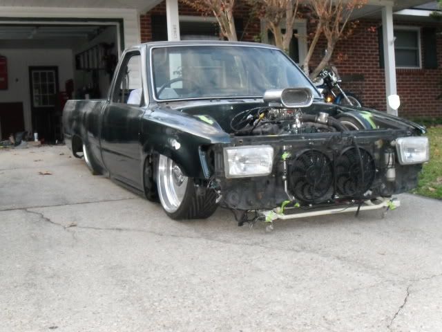

    My bad man , what i meant was where did you get those trailer fenders from? The ones in the pic

    They are trailer fenders I got from a local supply place. I buy the ones with Backing plates for the rear and open ones for the front. These were way too big and I ended slicing the edges every 3" and collapsing them. You can't even tell.

    Nice, about how much do they run

    Like $30 for the pair.

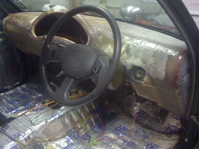

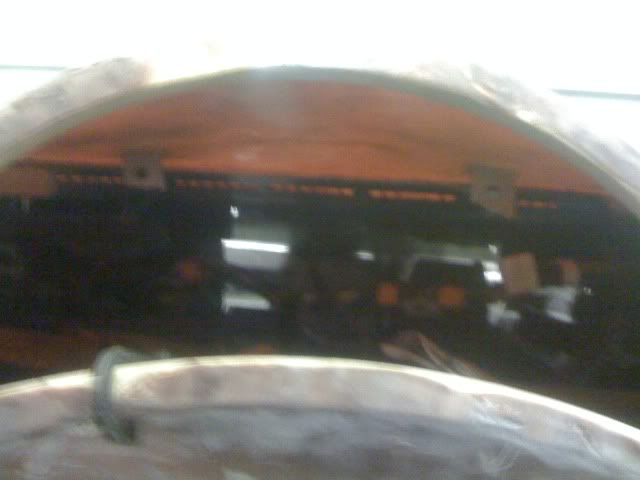

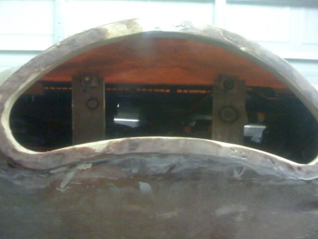

    I glassed these tabs in behind the gauges.
    Added some sup
    er solid mounts

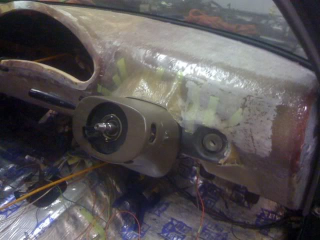

    And glassed around the column. I wanted to keep it seperate because the column tilts. I usually have it all the way up, but it does tilt. Also epoxied in the key hole piece and smoothed it some.
    And with the wheel. I wanted to run the yota column because it has all my light controls and blinkers, and I built a circuit board that replaces the cruise control module and allows the steering wheel buttons to control the airride.

    super sick man, I thought i liked the wheels till I saw what it looks like when its moving.. still looks super awesome mannn

    with the chevy motor are u running automatic? or standard? i was wondering cuz ur firewall is smoothed out and it looks great. i was also wondering about your brake master and booster???
