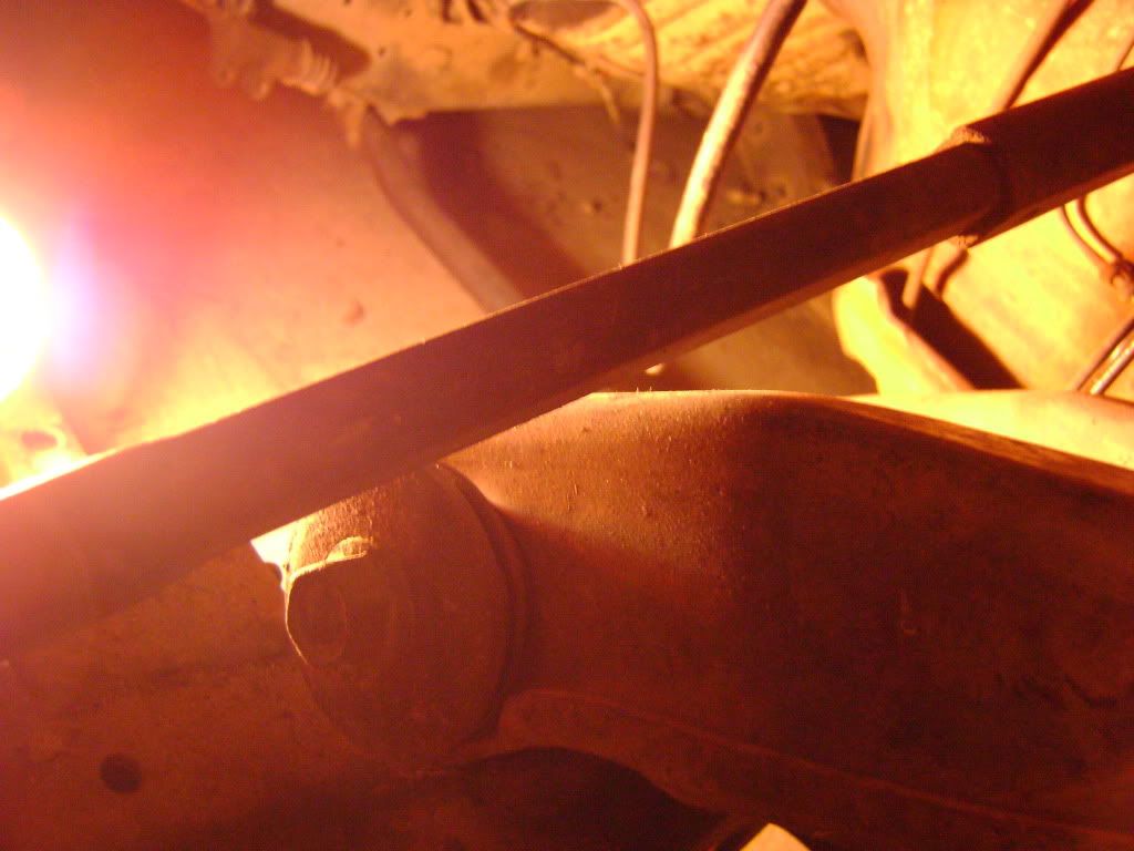

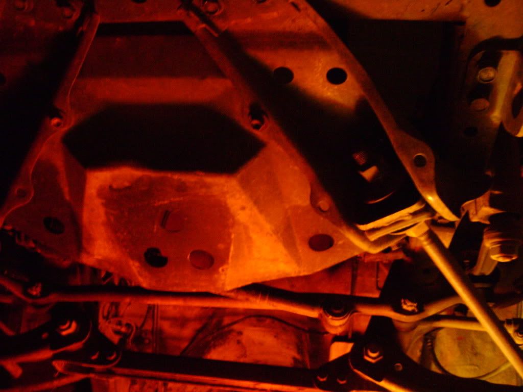

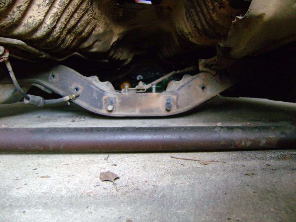

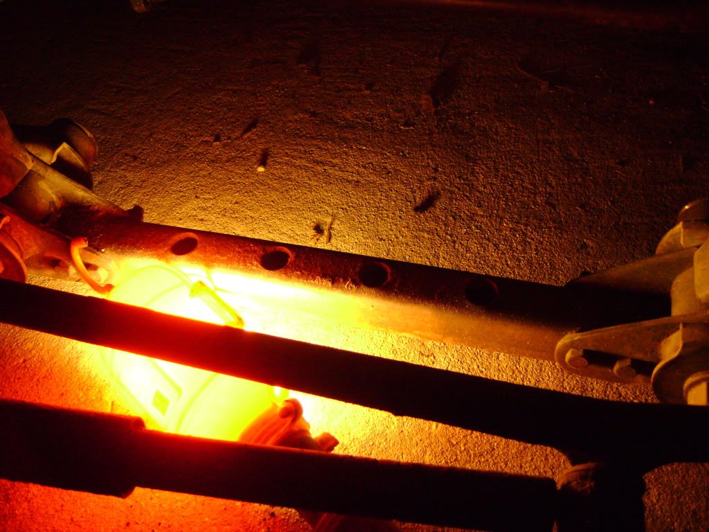

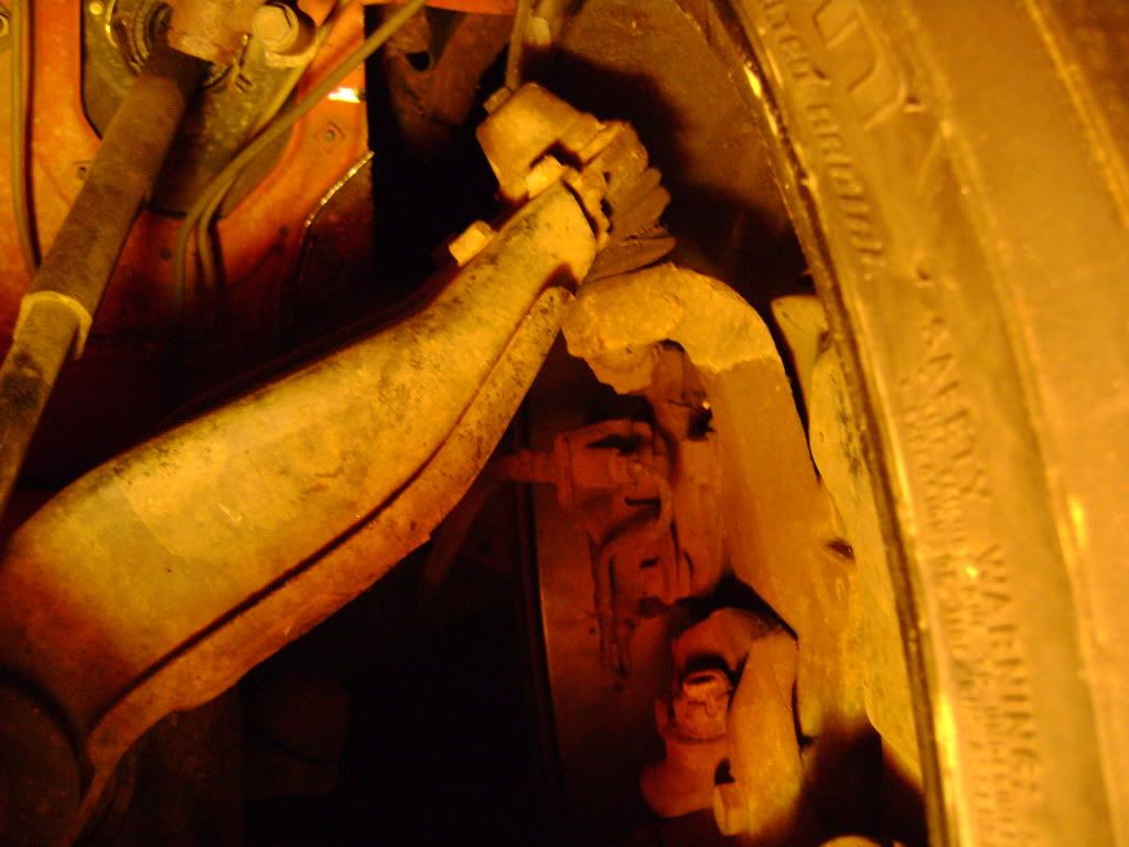

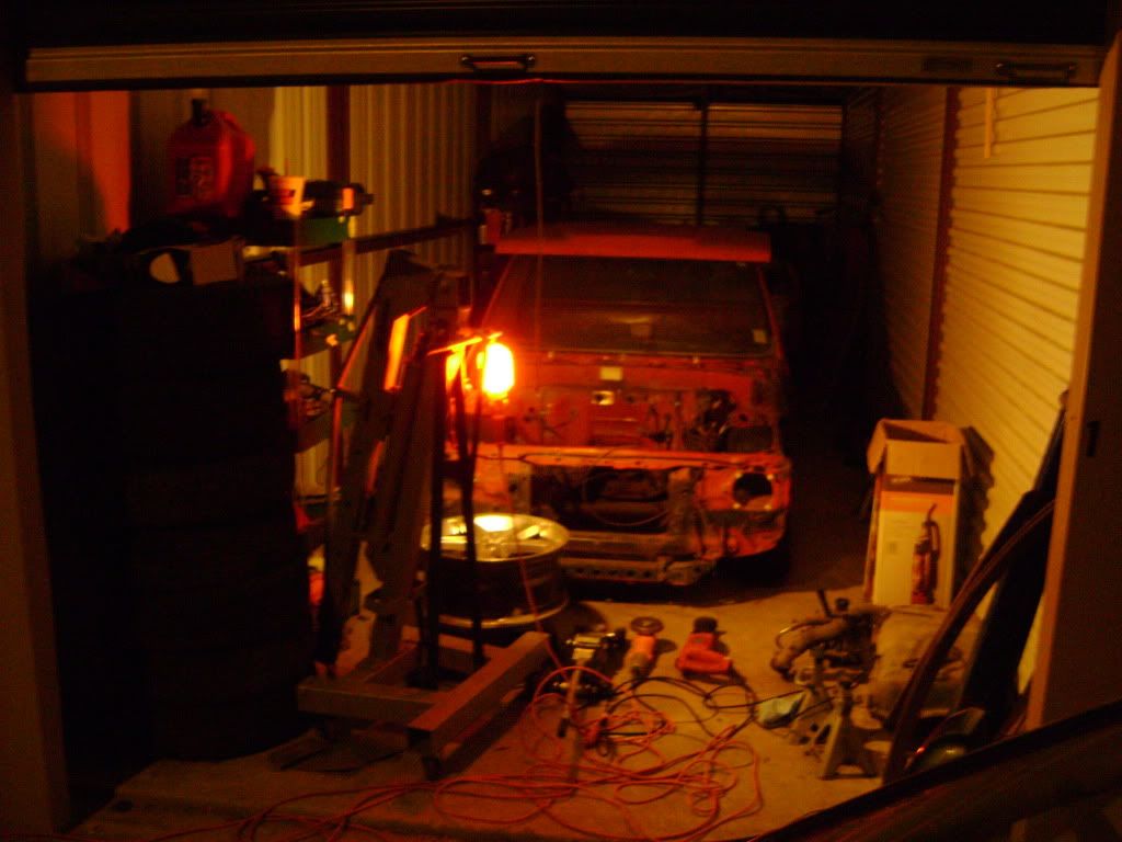

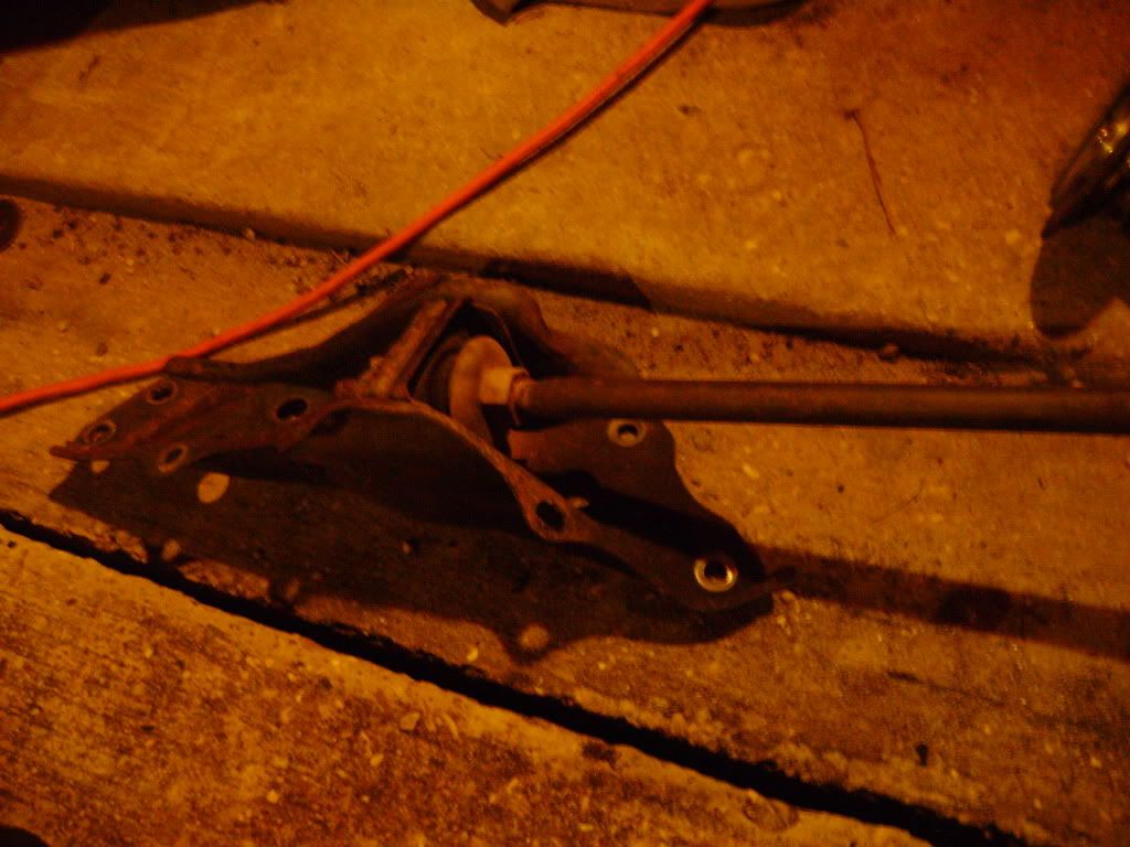

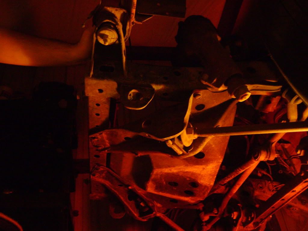

    Nothing too special this evening, but i went out, jacked the truck up, pulled the "triangulated stabilizer bars" from the front out. I'm not sure what to call these on the Toyota suspension setup. On Honda's with front wheel drive they are considered traction bars, but they look to serve the purpose as adjusting the toe in as far as i can tell.
    For now they are out of the way, and tonight i took some extra crappy pictures.
    Anyways, here is the beast, in its cave..
    Got them out..
    Lowered the truck back down, and yes Burnzya you were correct, the ball joint is getting into a bind, and this is indeed putting a damper on my endeavor to lay that frame... So some drop spindles are soon to be in my future.
    Also noticing that my steering shaft is getting very close to the upper control arm.
    Getting pretty close though, its a matter of going 1.5-2" more inches to lay cross members/bracing.

    i believe the proper name for the bars is "strut rod" on a toy.
    and you'll need to keep them unless you go with tubular arms or triangulate the lowers :waytogo:

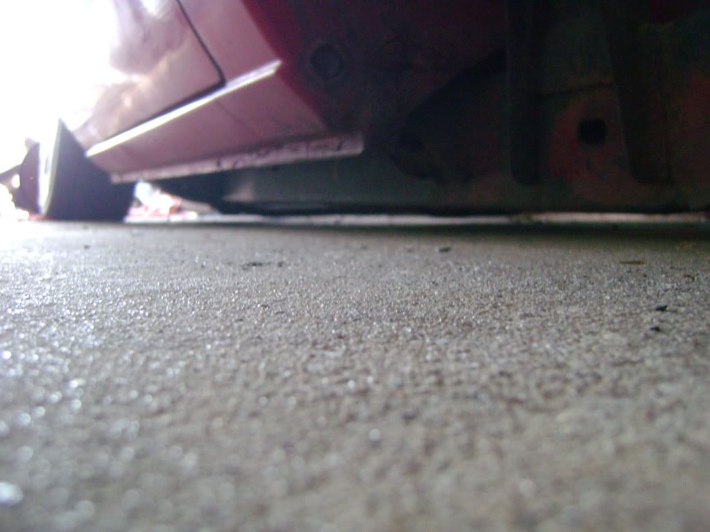

    Ok, so this was a pretty sweet week for the truck!
    First of all.. Craigslist is the shat!

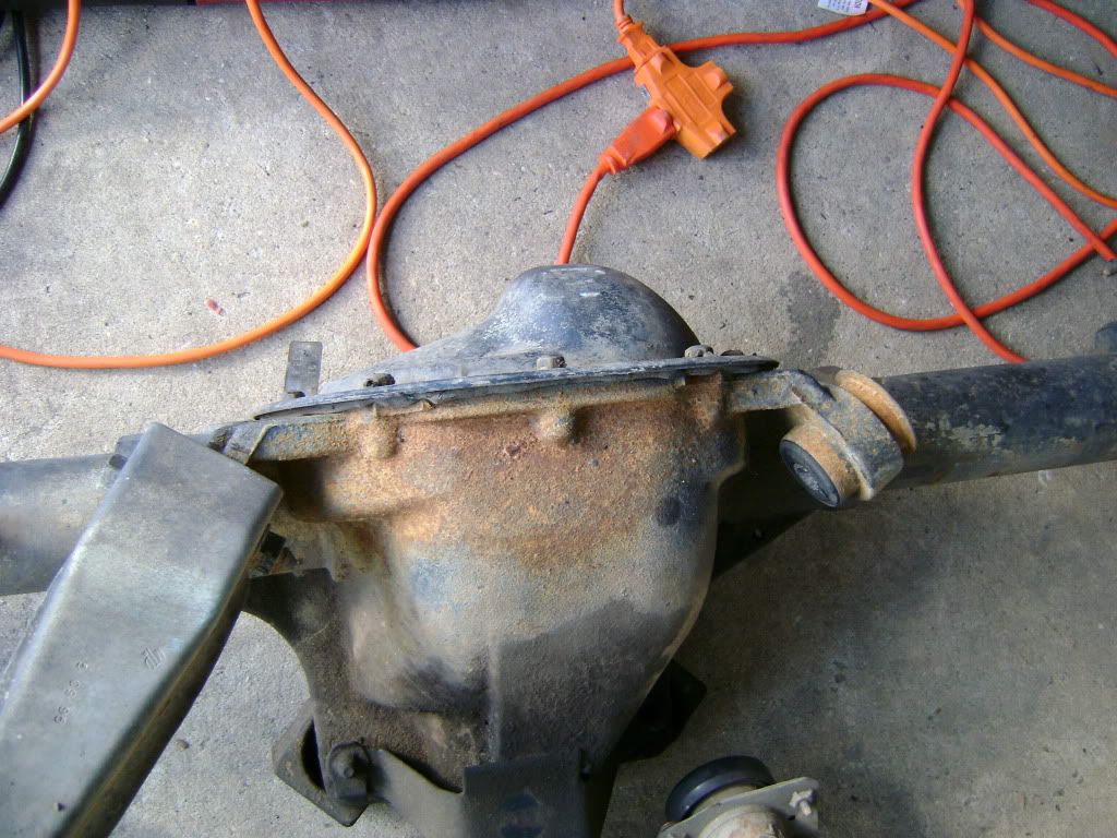

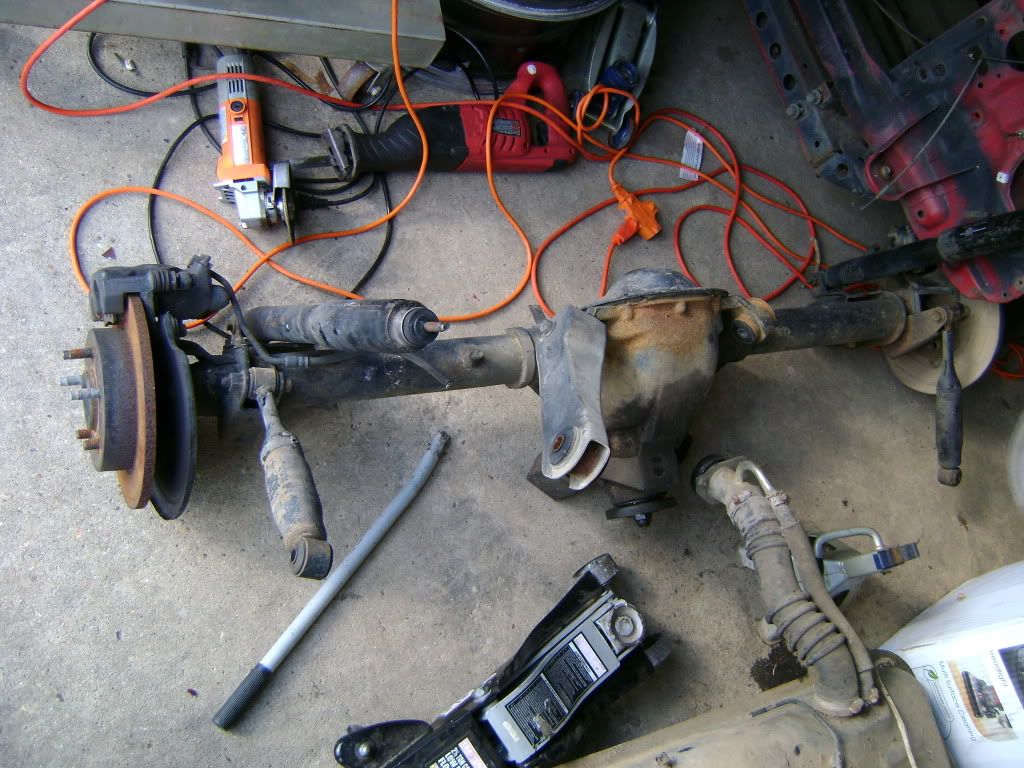

    I posted some truck parts i don't need anymore on there (bed,fenders,engine,tranny) well just randomly this guy contacts me and ask if i by any chance have the rear end still from my truck and if i wanna sell it.. So i told him yes, because i been wanting to upgrade to a ford 8.8 but was not looking to at the moment, it was on the to do list for later on.. so i told the guy yes i will sell it to him for $120, so he came and picked it up.. so that took me 0% effort to sell it, which was awesome.

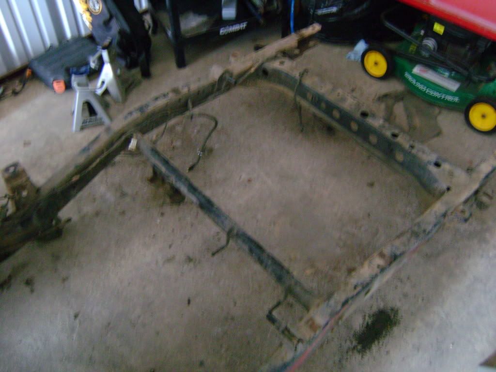

    So here is the truck with no rear end.
    Still not laid out, but hey we're getting there! Cross member needs modification and i need to finish hacking off a leaf spring bracket on the passenger side.. and notch it, but its fun to look out without a rear end on it.

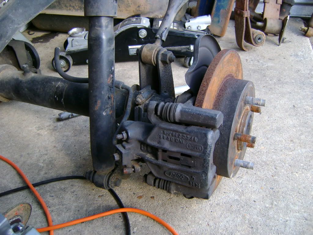

    Anyways, sold the rear end on Wednesday, went back on good ole craigylist and posted that i needed a 94-98 gt rear end.. by Friday night i picked up this beauty for $100, $20 less than i sold my 375k mile toyota rear end for! so i got a twenty left over after this deal, freakin sweet! If you haven't noticed i'm kinda excited about that deal. ha
    It's a Mustang GT 8.8 rear end from a 96 model, posi, disc brakes, has the factory linkage brackets on it, and previous owner already installed 373 gears, all this for only a bill!

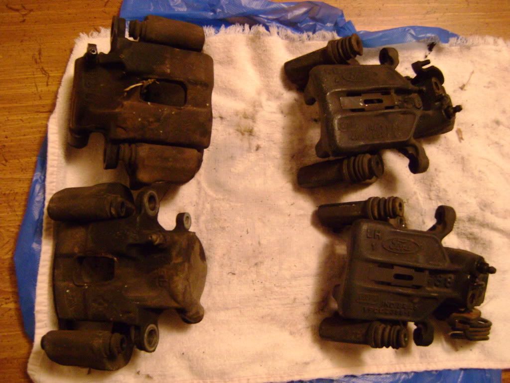

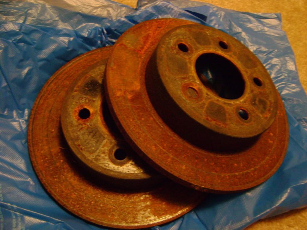

    Ok, went out and pulled the Rear Mustang GT brake calipers with brackets and rotors, as well as my factory Toyota Calipers and brackets from the front.
    Yota on the left, mustang rears on the right
    Gonna take the rotors (as well as my fronts once i pull them) and have them turned. Then going to disassemble the calipers, have my friend powder coat them, then rebuild them and back on they go. I'm thinking once the truck is done i want a high gloss deep gray paint job, with a dark cherry powder coated frame. But i think the calipers will be a 20% or high gloss, have not decided yet. Anyways these pics are mainly in reference to be a "before and after".

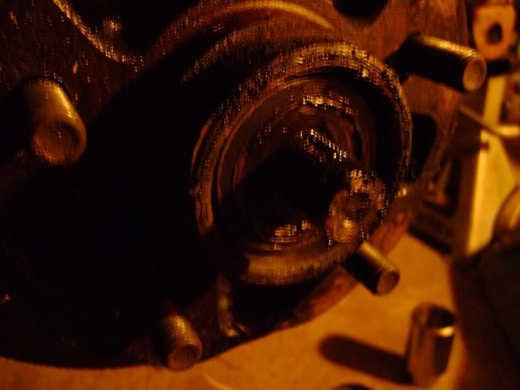

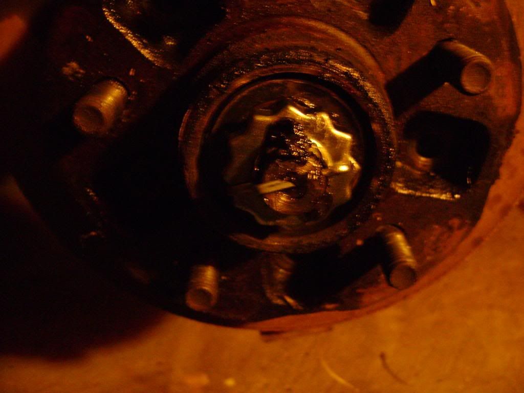

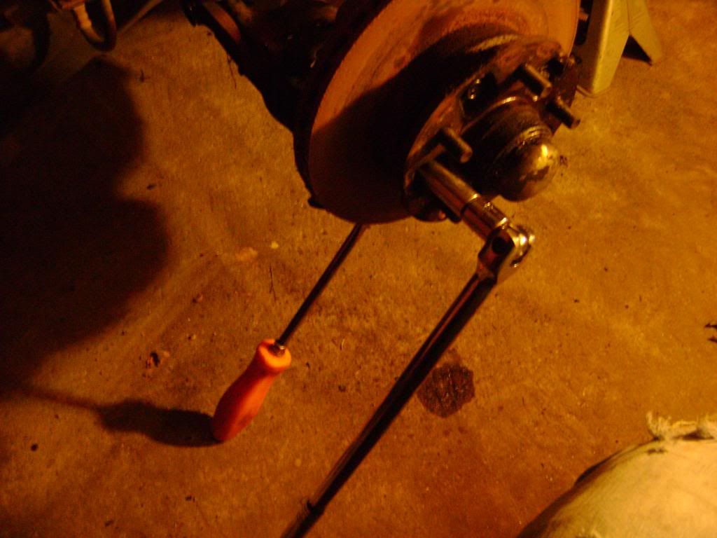

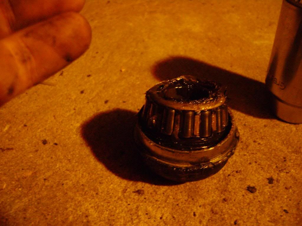

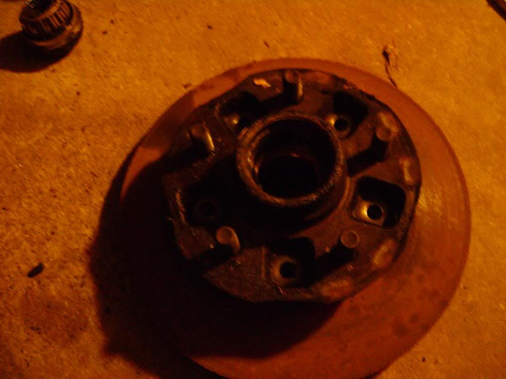

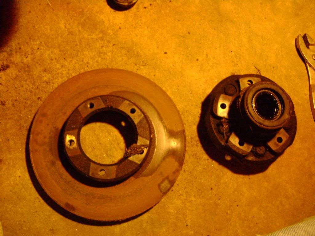

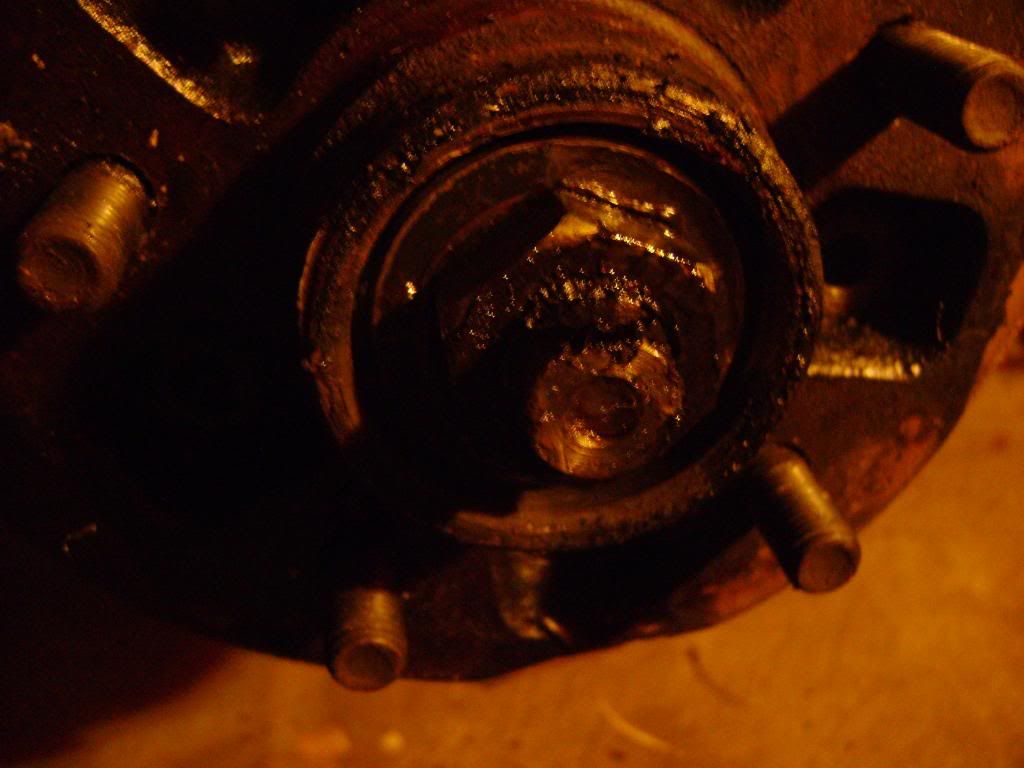

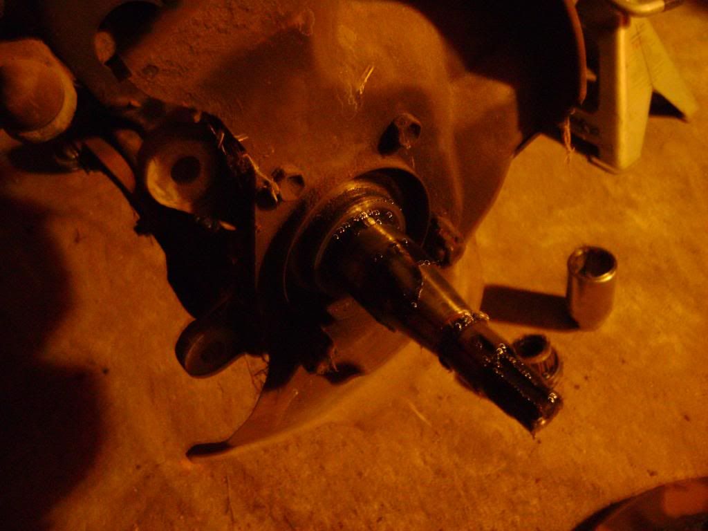

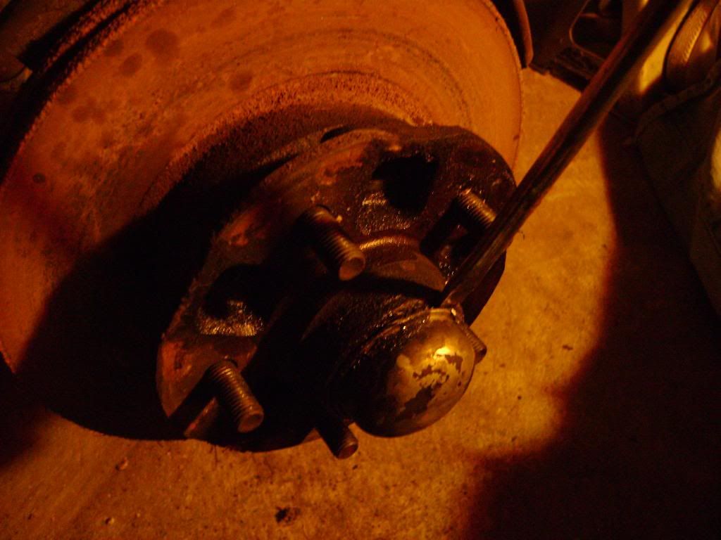

    Went out to work on the truck tonight. The goal was just to pull the front calipers and do the ball joint flip. Well i didn't realize you had to pull all of the hub to get the calipers off.. well not big deal, off they came! I took some step by step pictures just for anyone who may not know how to remove these. For hubs that have not been removed ever, they came off pretty easy. Here goes..
    First i broke loose the 14mm head bolts that held the hub to the rotor. Since i did not have any brakes i used a screw driver to brace the rotor against the concrete.

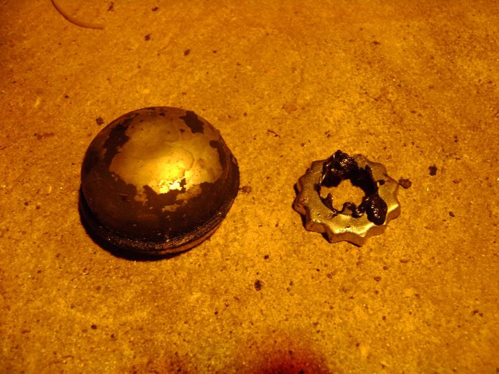

    Then, using a flat head screw driver and a hammer, i gently broke the seal of the center shield off. It just pry's off, mine had lots of gunky oil/dirt build up.
    Behind it is a cotter pin, remove, then a washer/shield of some sort. It easily comes off.

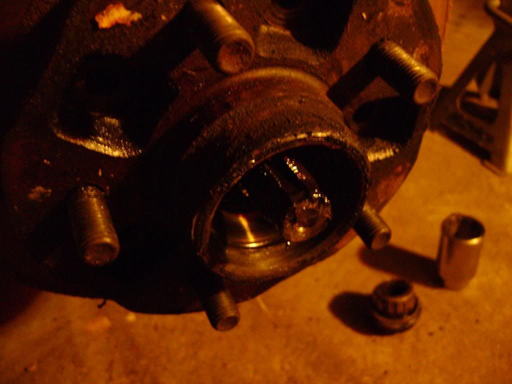

    Then i thought this nut would be tight like a cv axle nut. I put a 32 mm socked over it, but the nut is about a 30mm, but it still turn it by hand. It was very loose.
    Then with one gentle tap using a hammer, an open face bearing will fall out of the assembly.
    Then the rotor/hub comes right off.

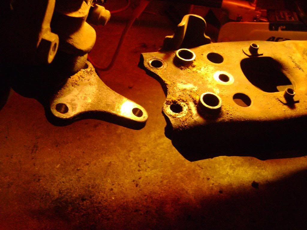

    Then i pried the two loose using a pry bar.

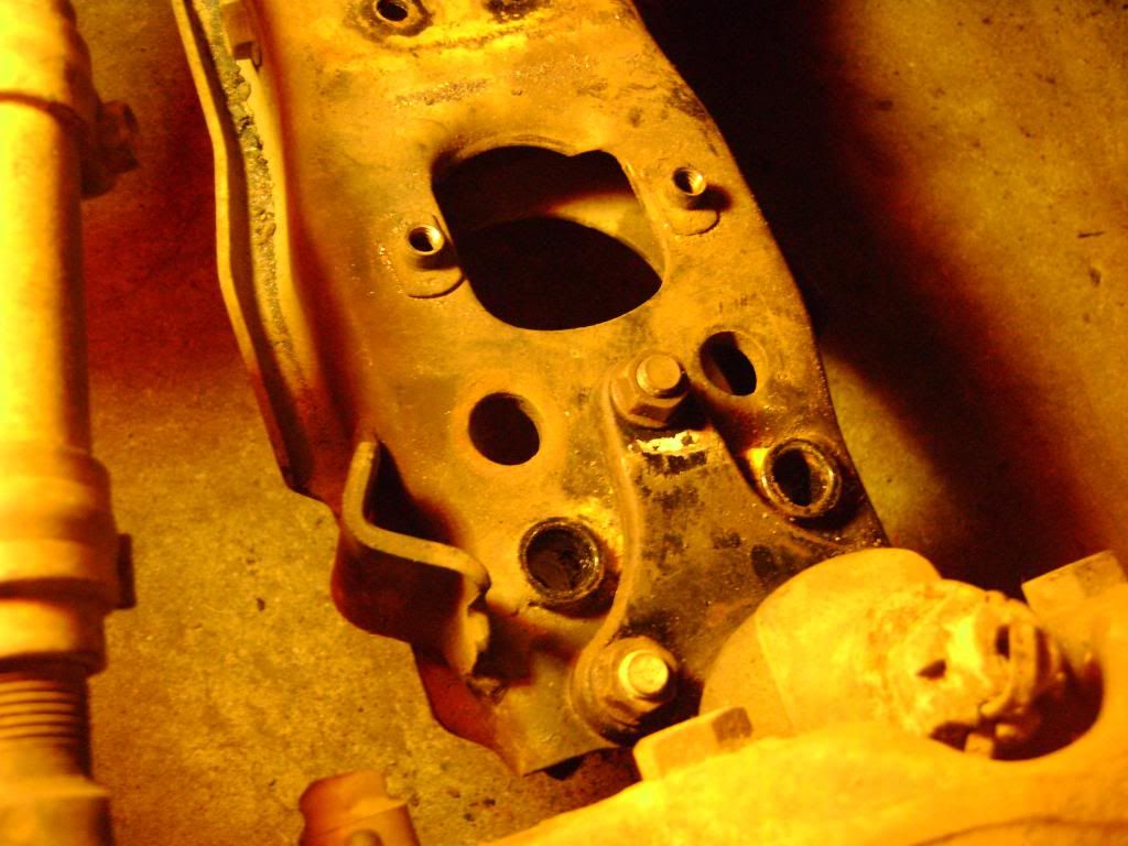

    Then i went for the ball joint flip, It was very easy. Just had to use a little force to break the bolts loose from their home for the last 25 years or so.
