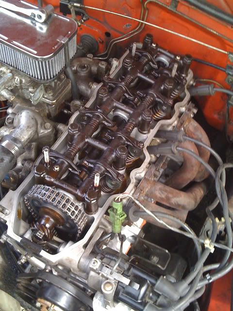

    Here's a few photos I took today when I did the valves.

    Looks all good from the last set of pics.

    nice!.........is the head all stock?

    The head is basically stock. Mild port to take the casting flash down, and larger valves by about 1mm. The intake and exhaust flow real well though.
