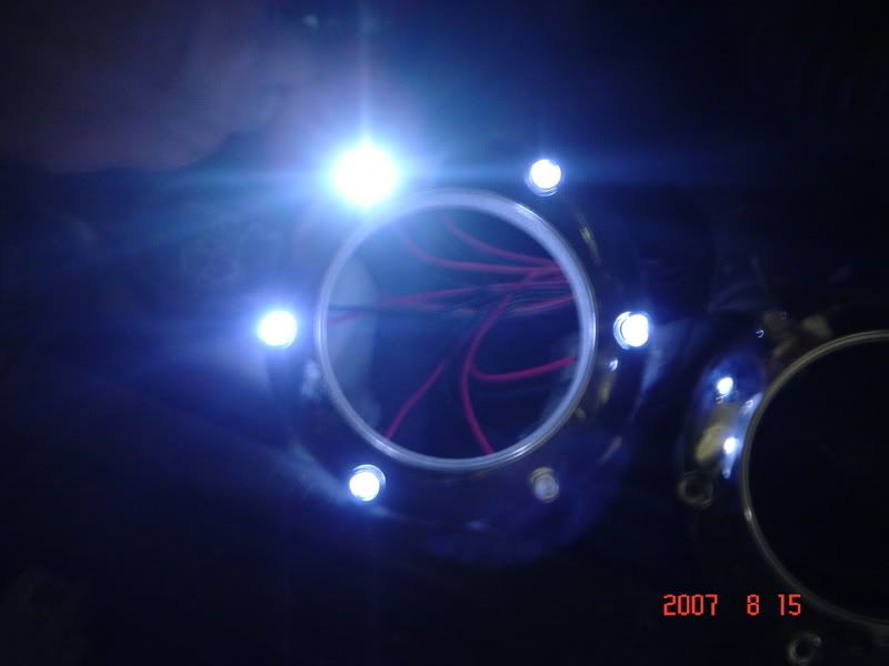

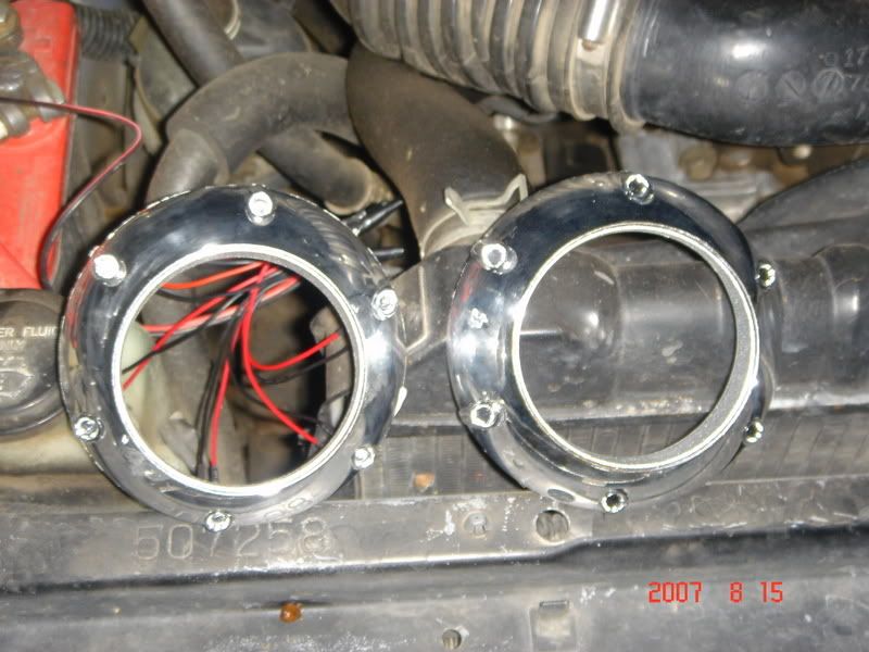

    Well I started working on a HID retro for my yota a while back and im picking it up again..I'm currently using some E46 Bixenon projectors but i'm going to switch to some E55s because they are shorter.as you all know there is limited room behind the passenger headlight with the battery..I picked up some shrouds from a VW GTI and as you can see im drilling out the holes around it and am going to install LEDs in there..Here is what i have so far
    started with this
    heating up the headlights to open them up
    shrouds
    what it will look like with LEDs BTW i think im going to hook these up to the parking lights

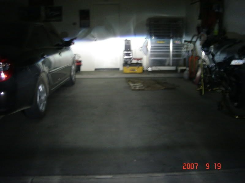

    now here is some comparison shots this first one is BOTH halogen bulbs on
    pretty crappy huh
    Now here is ONE E46 projector i played with the spacing and shield to get some more color,but again Ill post some pics up when i get the new e55s

    no i'm having fitment issues with the battery,so im going to try the e55 as it is a little shorter..if that doesnt work i'll have to relocate the battery..Plus they are not sealed yet..im working on it!!!
