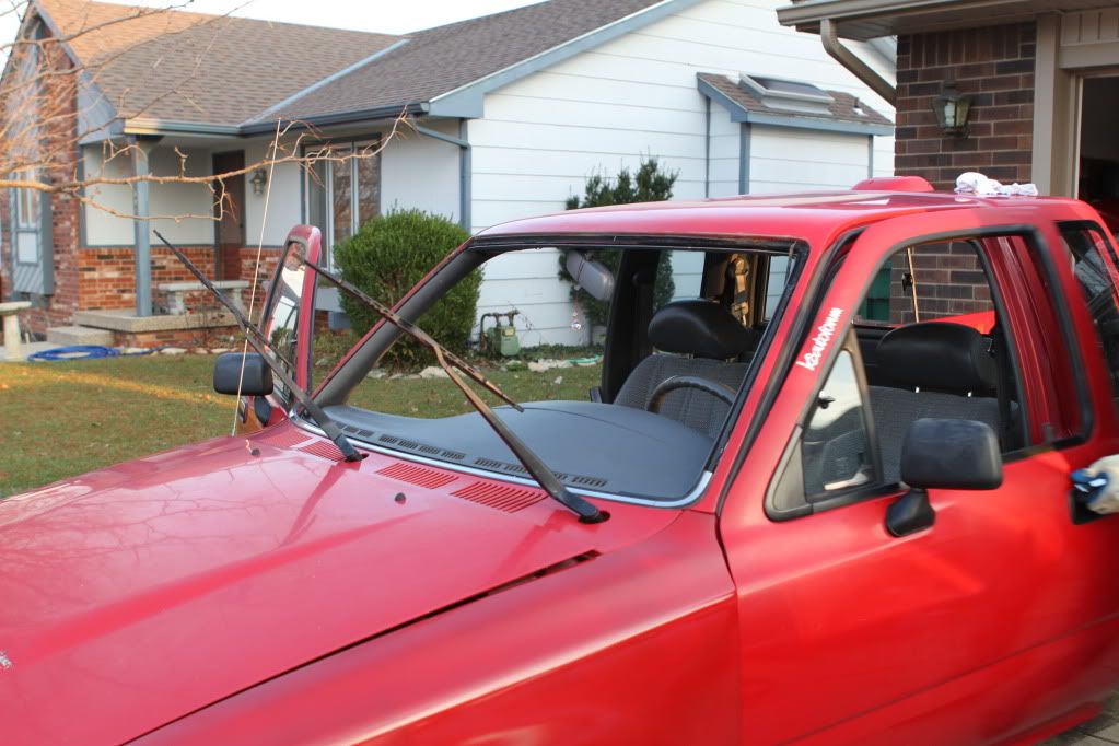

  13. IronNam
    IronNam Grand Toyotaholic
    Sep 11, 2008
    6,960
    Kansas -> NorCal
    94 XCab
    I watched the guy who did my windshield.
    cutting the rubber throughly is something that has to be done with great pressure, so you can get it all out.
    he got my busted windshield out.
    kinda thought about it
    maybe i shouldve left my grille chrome... no big deal
