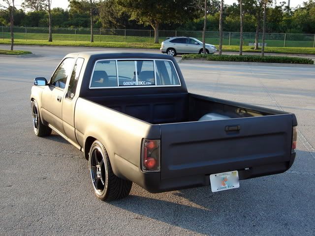

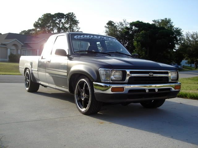

  17. Litneon
    Mar 29, 2007
    2,414
    50
    Cocoa, FL
    94 xtra cab
    The stock wheels have a +38 or +42mm offset. This will put the wheels pretty far back in the wheel well, especially if you've done the 4wd fender conversion.
    Besides being tucked pretty far back, you'll notice that the wheels' center caps wouldn't fit over the grease cap on the hub.
    A set of spacer fixed that, I chose a rather large 1.5" set of spacers, which then allow the wheel to fill the fenders rather nicely and match the rears.
    My wheels are 18x7.5" fronts and 18x9.5" rears with a +42mm offset. the offset is the same for both front and rear even if the set is staggered. And just so you know, 9.5" wide is really all the wider you can go unless you narrow the frame rails.
    I like 'em staggered......
