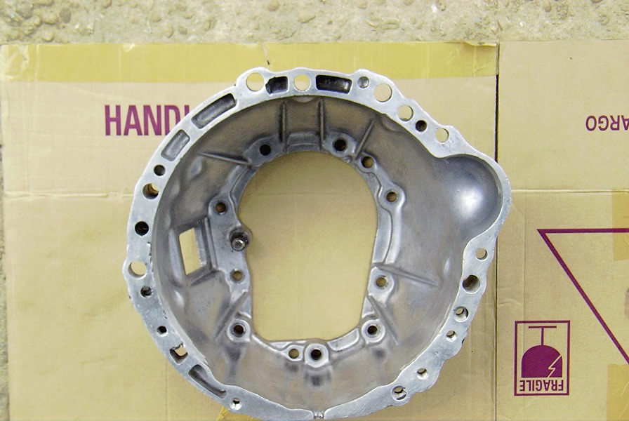

    the pattern on the front of the gearbox is the same for W55/56/57/58/59 and the G series alloy Hilux and Hiace boxes (G52, G55 I think), a sort of tilited over oval shape.
    The older steel case boxes (W40, W50) have an almost square bolt pattern with only 4 bolts. You can sort of see it here.
    Your issue is getting the bellhousing to fit a T or G series engine, the other end should be relatively easy to source. Depending how carried away you want to get though you can grab any T series bellhousing and weld it to the bellhousing from whatever gearbox you get, just need to be very accurate.
