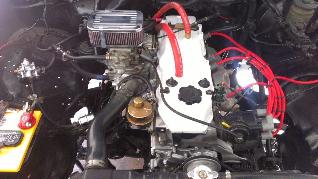

    I put a breather filter on the forward port of the valve cover, the weber is hooked up to the PCV valve, and the front vent filter spits oil, not a lot, but after I drive it 30-40 miles, I always wipe residual off the valve cover. Couple of thoughts, its a bran new rebuild and I couldn't be happier with the performance and how smooth it runs. It runs better and better each day. The oil PSI spikes until the relief valve opens then its fine, never over 80PSI before it drops back down to 60-70 psi. I am 600+ miles into the break in and the oil has already been changed. I also have ZDDP additive in the oil to assist in the break in... here is the pic of the set up, [​IMG]
    so I am curious why the oil blow out of that front filter???? :shrug: Isn't the design to suck out the PCV and vent from the front port? I certainly don't like oil, not even one drop, where it isn't supposed to be. Any thoughts would be appreciated. The valve cover has the vented oil shield installed and I am not sure how oil is getting to that front filter to begin with unless the pressure is so good that it is finding a way... Need some expertise out there to help me out.

    While cruising there is plenty of vacuum to keep the pcv valve open and sucking the crankcase gasses out and fresh air through the breather. When under full or heavy throttle there isn't as much vacuum so the crankcase gasses go out the filter.
    I have the same setup and its just a fact of life. I thought about making a direct return to crank case setup with a filter on it so the issue goes away but it doesn't bother me enough to fix it.

    Couple of friends running catch cans on that port. No oil anymore.

    I had this same problem but now since I got some cheap filters from ebay the filter cathes da oil instead of spitting it out

    Breather is not large enough and it sits very close to the inside valve cover baffle. Try larger breather or install a longer hose to the breather.

    I had same problem until I switched to my ghetto catch can system during auto cross that thing would spit up a fine mist of oil making my engine bay smell no PVC valve just straight hoses to a catch can

    Thanks for the kind words thank goodness that's an old pick and all the loose wires and tid bits are no longer visible as well as the fuel regulator switched to black hoses a little smaller if I can get mine as detailed and on cue with your 78 I'd be set ..This might not work but if u stuff the inside of your small breather filter with a medium coarse steel wool it may slow down the oil seepage . Not to much tho just a off the wall idea

    I fixed my issue awhile back. This thread made me decide what to do with the catch can I bought cheap a few years ago. Works like a charm and it has a drain valve on the bottom to drain any excessive oil vapor. :D

    WT, that is a good looking catch can... I have been busy trying to get moved but I managed to find the time to address the "oil blow" out of that filter. I removed the valve cover to get the final valve adjustment after rebuild and while in there I took the oil shield off the inside of the valve cover. I found the most coarse steel wool and filled the cavity right below the breather hole. The oil shield has these great baffles and it worked perfectly. It doesnt blow oil anymore but there is a little itty bitty spot where the oil exists at the base of the filter. So, for me it is fixed until I can get that same can you have. I like that solution better! Where did you get that catch can???
