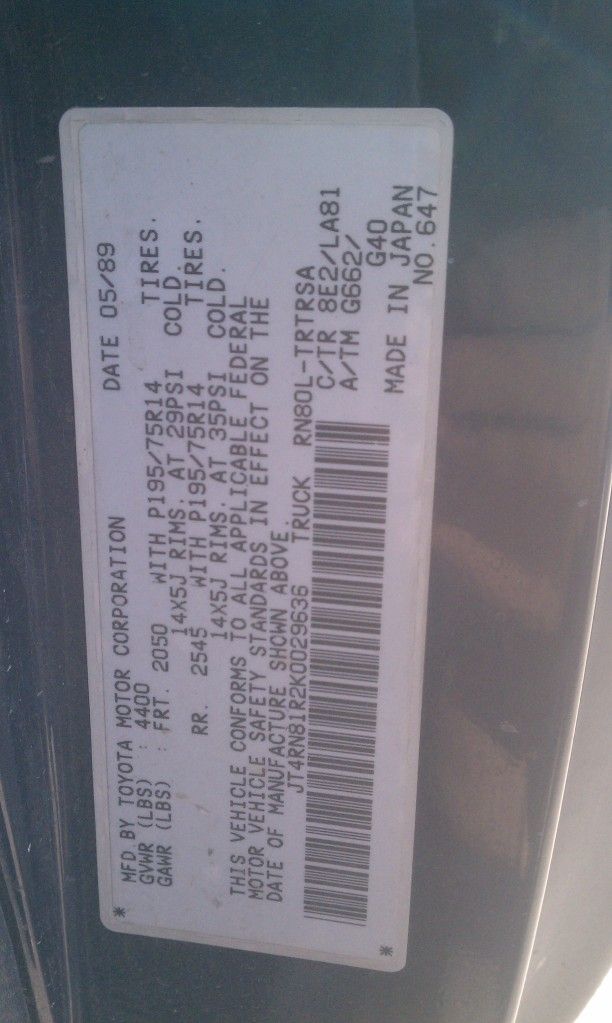

    Best way to check is if you look in the door jam the id tag will have your trans code. Tell what it reads and we can tell you.
  3. TonyTDE

    Aug 30, 2012
    28
    Pocatello
    1989 Single cab short bed

  4. scrub88
    scrub88 Toyotaholic
    Apr 14, 2007
    1,685
    10
    tn memphis
    88 toy short bed
    G40 4 spd same as me so does it grind in first and reverse
