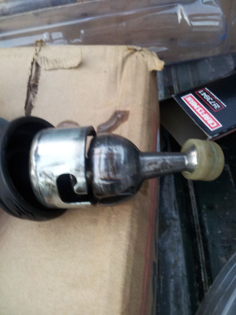

Unscrew the 4 screws holding down the boot, slide that up and where there shifter comes out is metal cap thing thats holds it down.this needs to be pushed down and then turned counter clockwise abouy 45 degrees and then you can pull the shifter right out.I'll post a pic of this so you get a better idea.
This is the piece that holds the shifter in. I use a big flathead to push down and turn it from the top.
