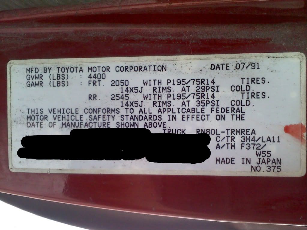

    Ok Ihear all this stuff about w56's and whatnot so my question to you guys who know stuff is what tranny do I have????? Called a few parts places and they want the code apparently they dont have one of those systems they can just type the model and make into and find out:brickknock:. I have a 94 2wd 5speed manual that needs replaced its and ex cab if that matters, dont know what other info to give. :shrug:

    Look on the vin, should say. I think its a W56 though

    look for the build sticker in the door. says on there. here's mine:
    see on the bottom right where it says A/TM F372/W55? A/TM means you're looking at the diff and trans codes. F372 is the diff, 7.5" 3.5:1, W55 is the transmission.
