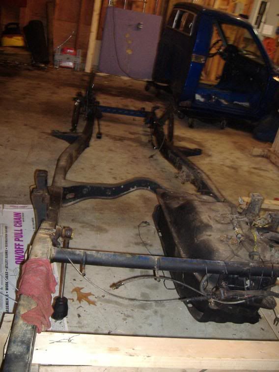

    As I bought it, October 2007
    The bed was bondo'd and beyond repair
    The frame had mouse nests in it
    The headgasket was blown

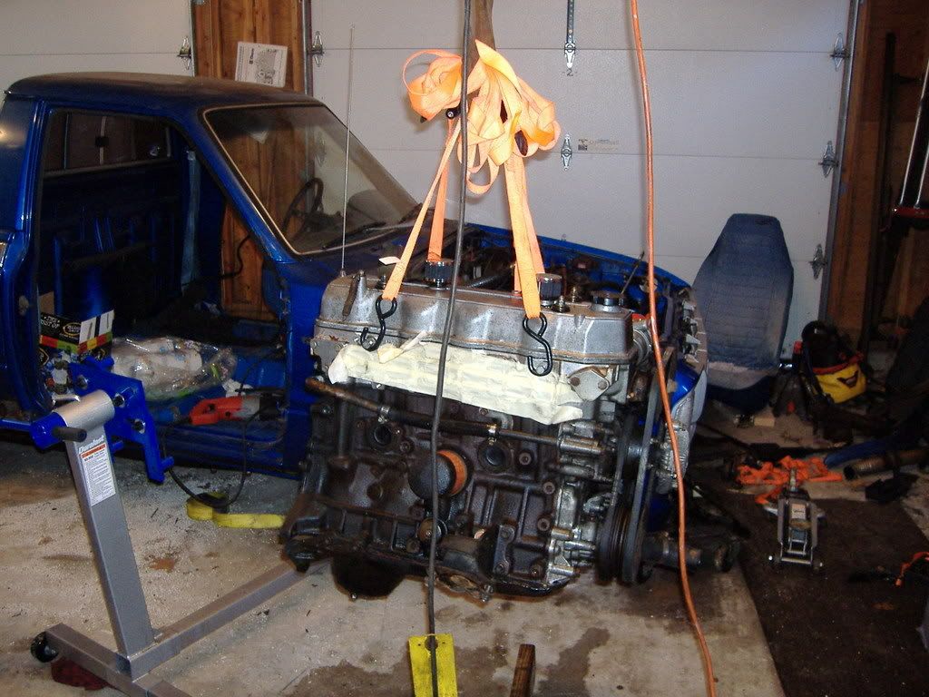

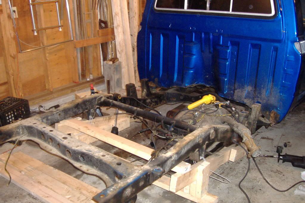

  3. Erick561
    Erick561 Veteran
    Apr 28, 2014
    442
    I ship from New London County CT I Price Match
    79 Toyota Hilux 4WD WHEELING DAILY DRIVER
    Dismantling for a ground up restoration

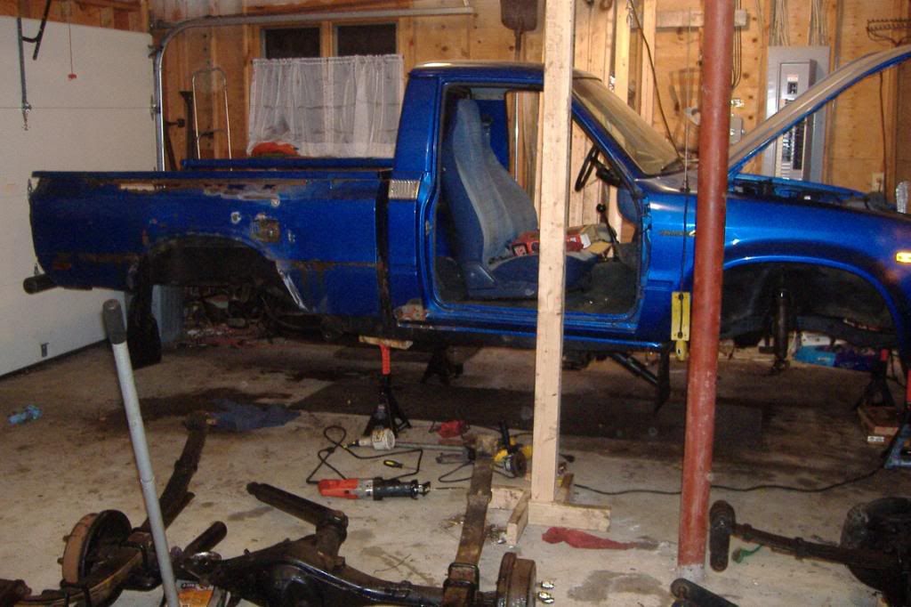

  4. Erick561
    Erick561 Veteran
    Apr 28, 2014
    442
    The cab was in rough shape so I gave it some TLC
    The previous owners had done some half ass repairs.

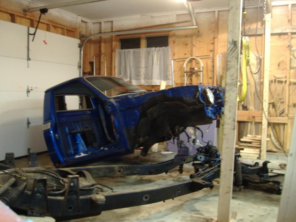

  5. Erick561
    Erick561 Veteran
    Apr 28, 2014
    442

  7. Erick561
    Erick561 Veteran
    Apr 28, 2014
    442
    major cab rust repair
