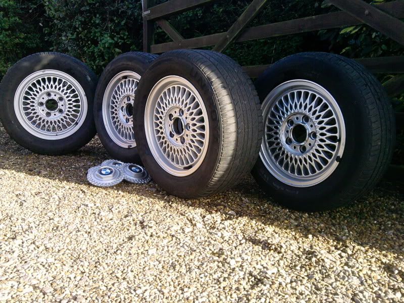

    Usually we get a bunch of guys coming here asking the same thing, for that "stance" ****.
    well, if you want to keep the drivability and without sacrificing top end...
    225/55/15
    Little small, but not completely small...
    Your wheel will be an inch wider compared to this wheel.
    245/50/15 Gold (15x9)
    205/55/15 Silver
    15x8's with 235/50/15
    15x9's with 235/50/15
    Mind you this Yaris is actually raced.
    235/50/15
