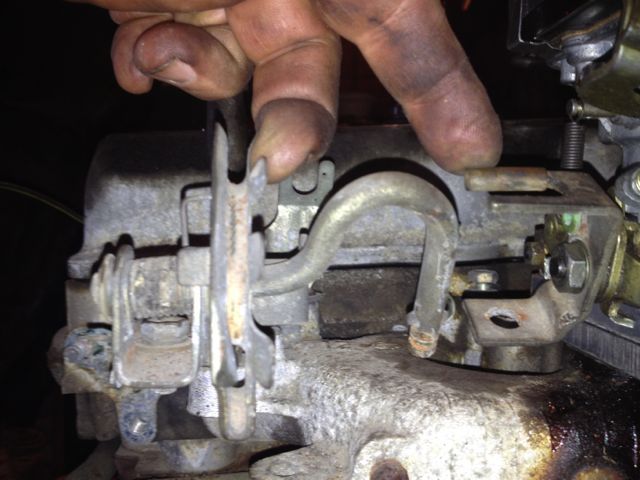

    Where do I get the part to make these reach each other? I think I need a long version of the thing my index finger is on.

    Let me check my parts box I do think there are to versions of this
    If at all that peace can be maid and extended fairly easily
    Edit my peace is the same length ..I recall installing a rebuilt carb on my buddies auto trans 22r and the bracket attached to the carb was longer ..

    a new weber comes with a longer bracket for the linkage, meaning the C shaped piece with a hole and a slot. looks like you re-used the stock one, your index finger is on it.
    real easy to make a new one, just need a small flat hand file because the hole to connect to the primary throttle shaft is not a circle, but round ends and flat sides.

    Yeah, that's the other option. To make the oblong hole, I'll probably try using a chain saw sharpening dremmel bit to cut between two drilled holes.
    Yes, this is the stock one off the OEM carb. But this is a used Weber I'm trying to get hooked up. At least the adapter plates line up right.

    Check webercarbs.com think they sell al types of brackets accessories and throttle hook up parts

    i see a flat plate of 1/8in with 2 bends, 2 holes and a slot in your future :D

    lynnwood, wa
