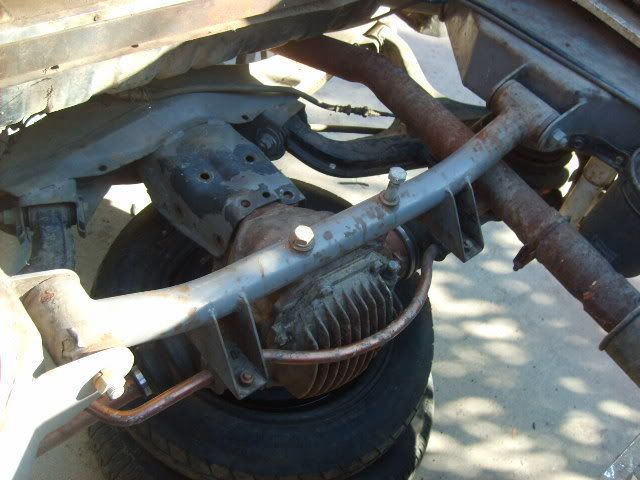

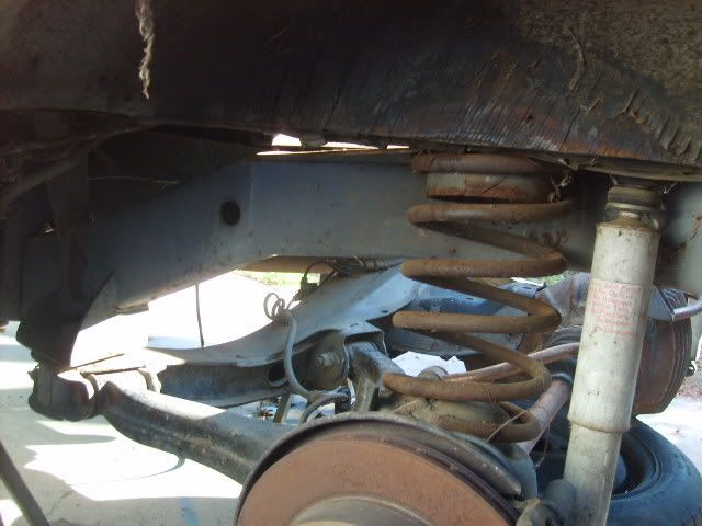

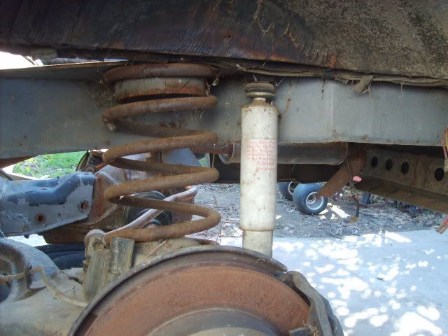

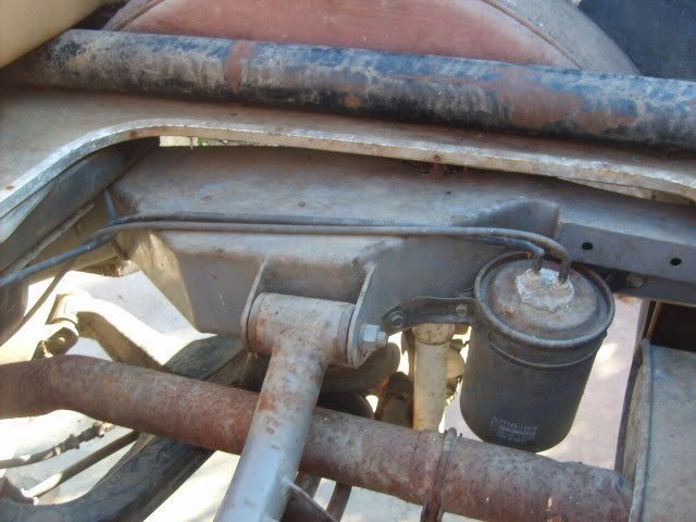

    here are some pics of the rear end set up on my truck. if some of you guys want more pics let me know.

    woot! i knew id dig up this page again. thats a 2nd gen supra rear end huh? did you narrow it at all, or does it tuck the wheels? whats the width on that setup? im tossing doing independant on the rear of my 78....static. to get the thing lower and clearing the bed.

    So how high does it sit off the ground?

    I wanna know how wide that era setup is. I gotta figure a way to go lower. I'm almost about to just cut the bed and do what I gotta do to static dump it even lower.
