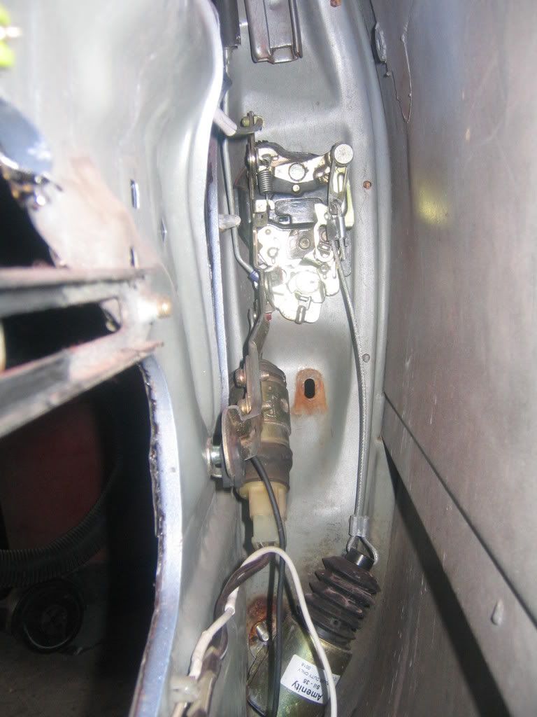

    I use Spal solenoids, here's when I first did it
    Welded nuts to the solenoid bracket so easier to install,mounted it @ the lower front corner,cable is a straight downward pull.:cool:

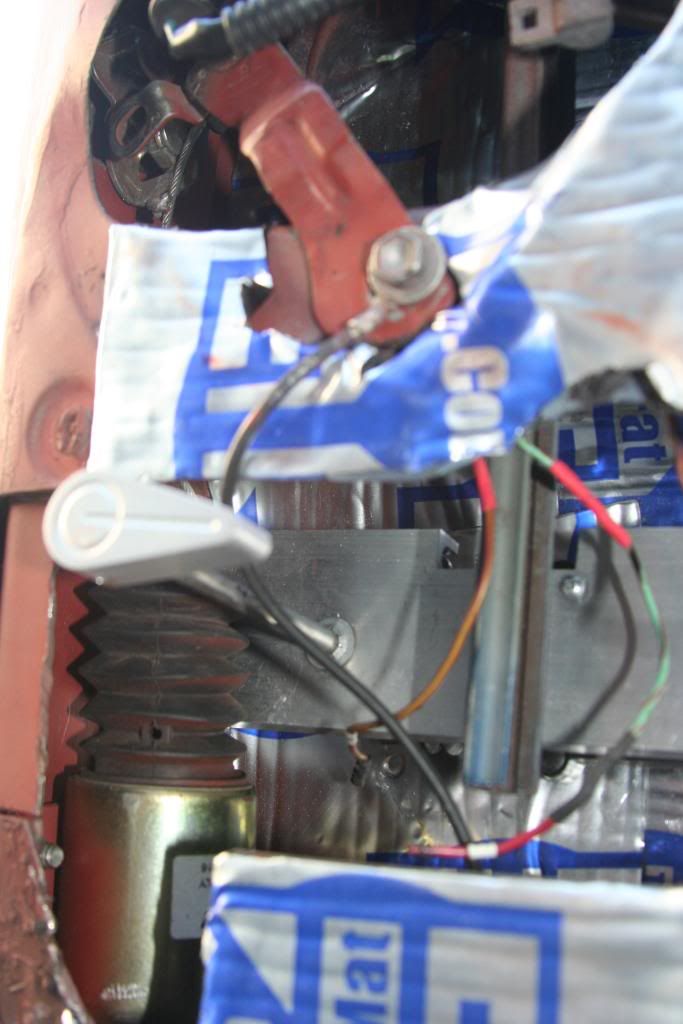

    When I suicided the doors I moved the solenoid to the other side & added a safety latch:cool:

    Now needed to add some pulleys into the mix. I added a 2nd one to make the cable clear & run smoother.Will have photo when I have pandel off in coming weeks.
    Still pulls from the bottom,but to get to the handle routes across the door from the latch. :cool:
