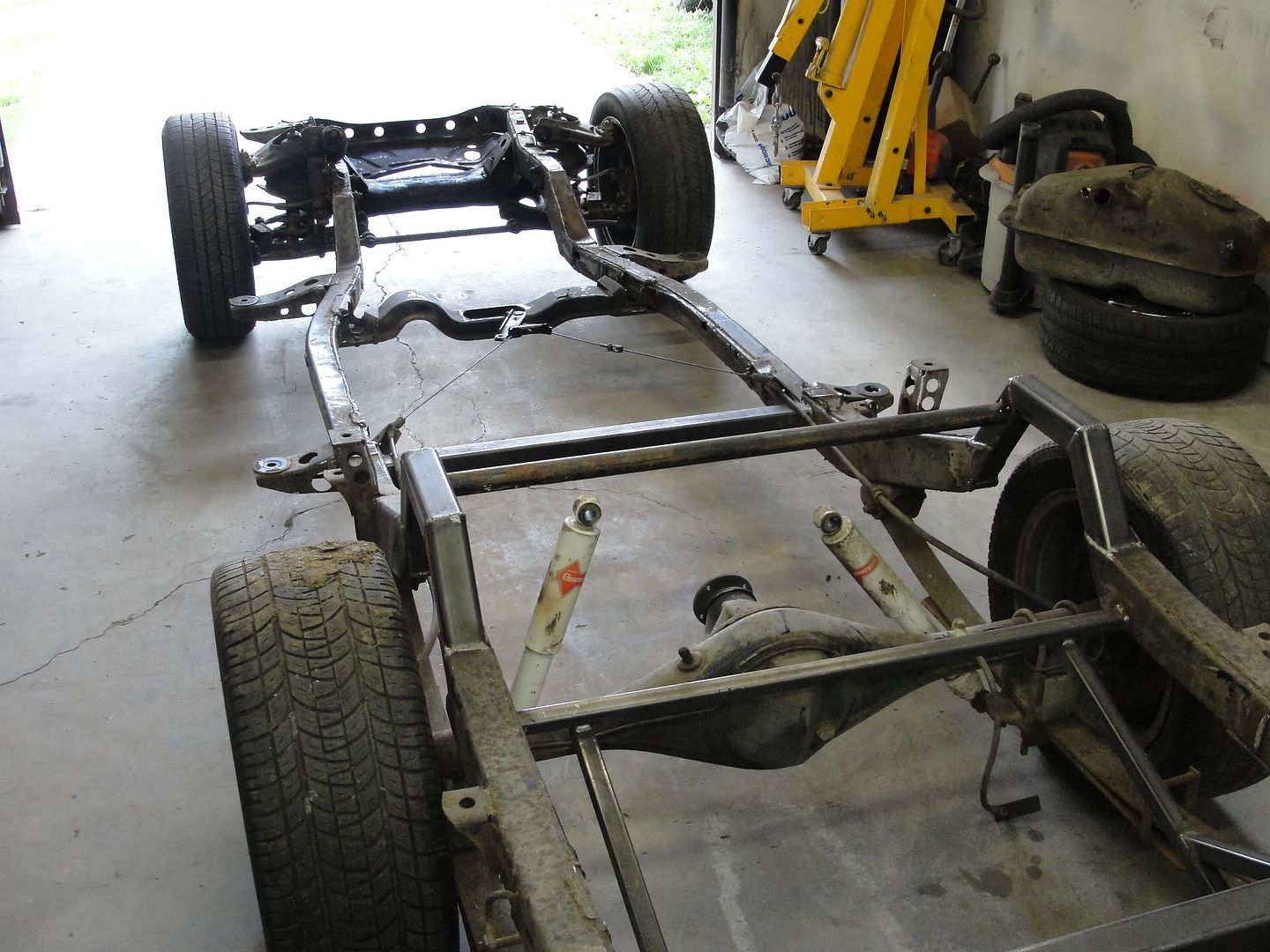

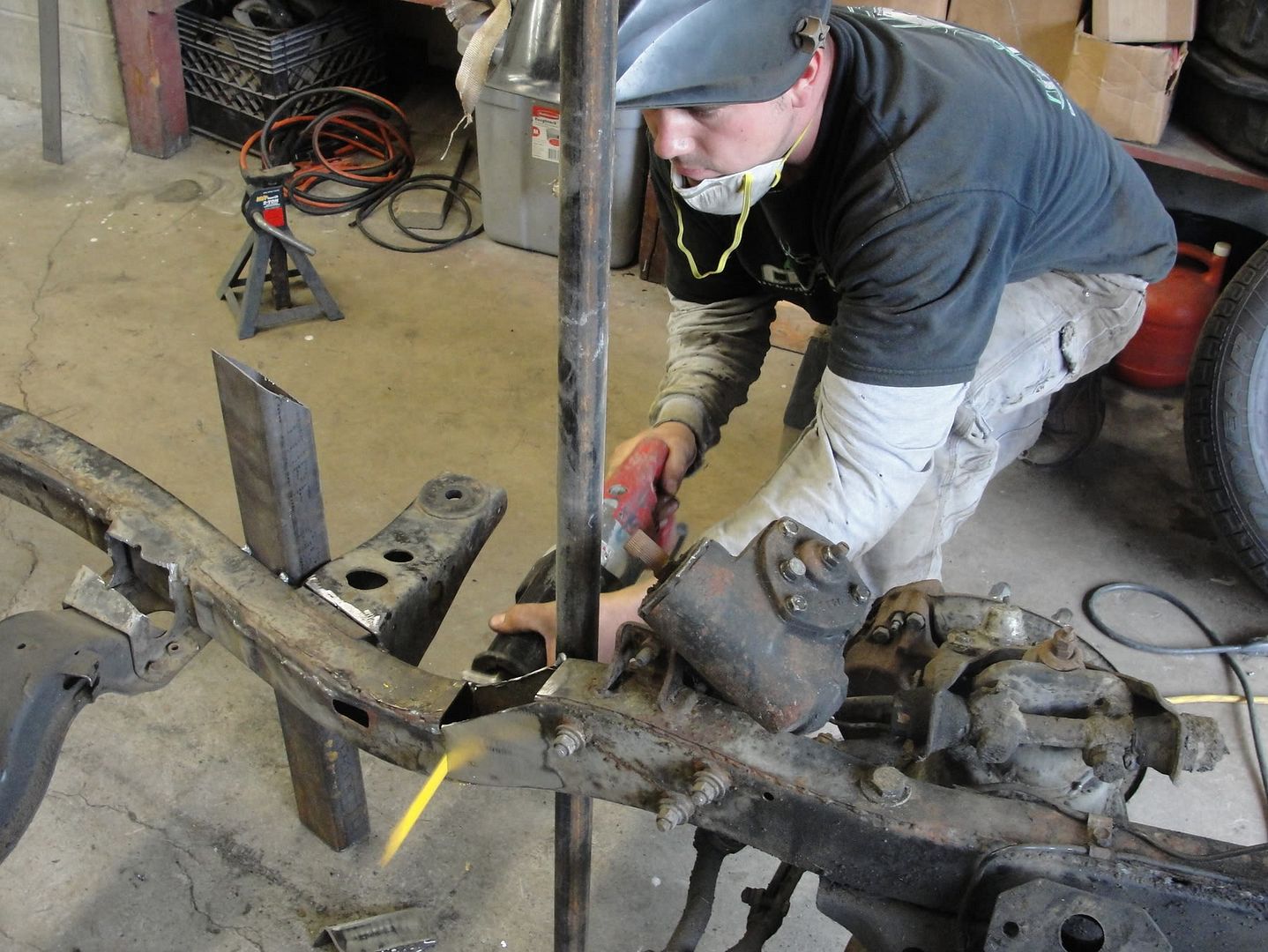

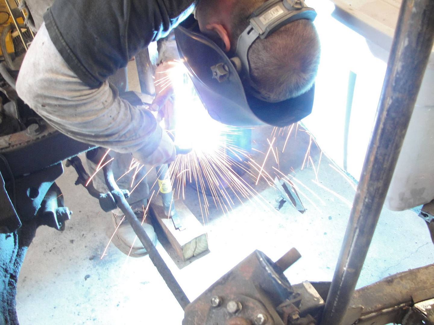

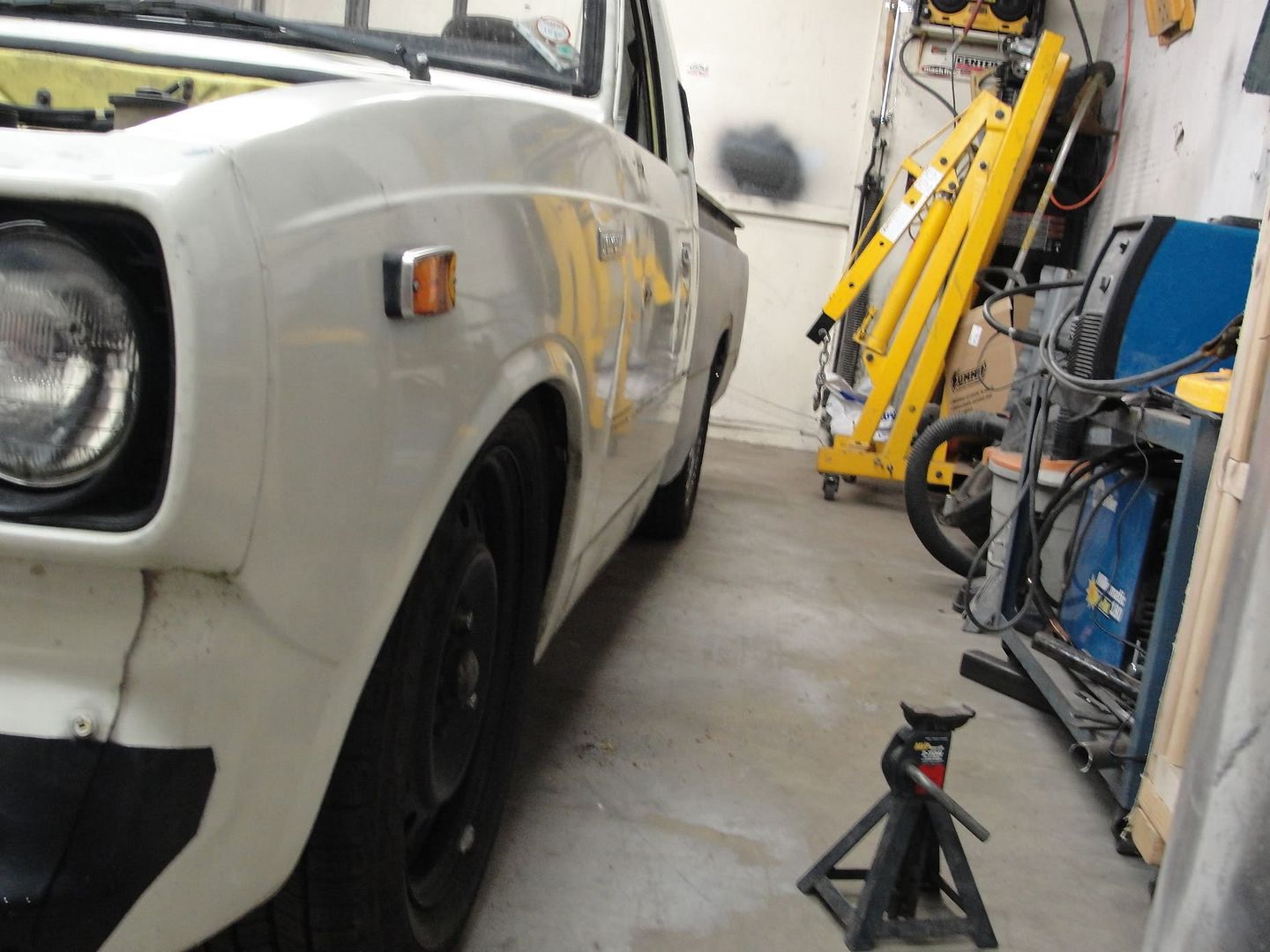

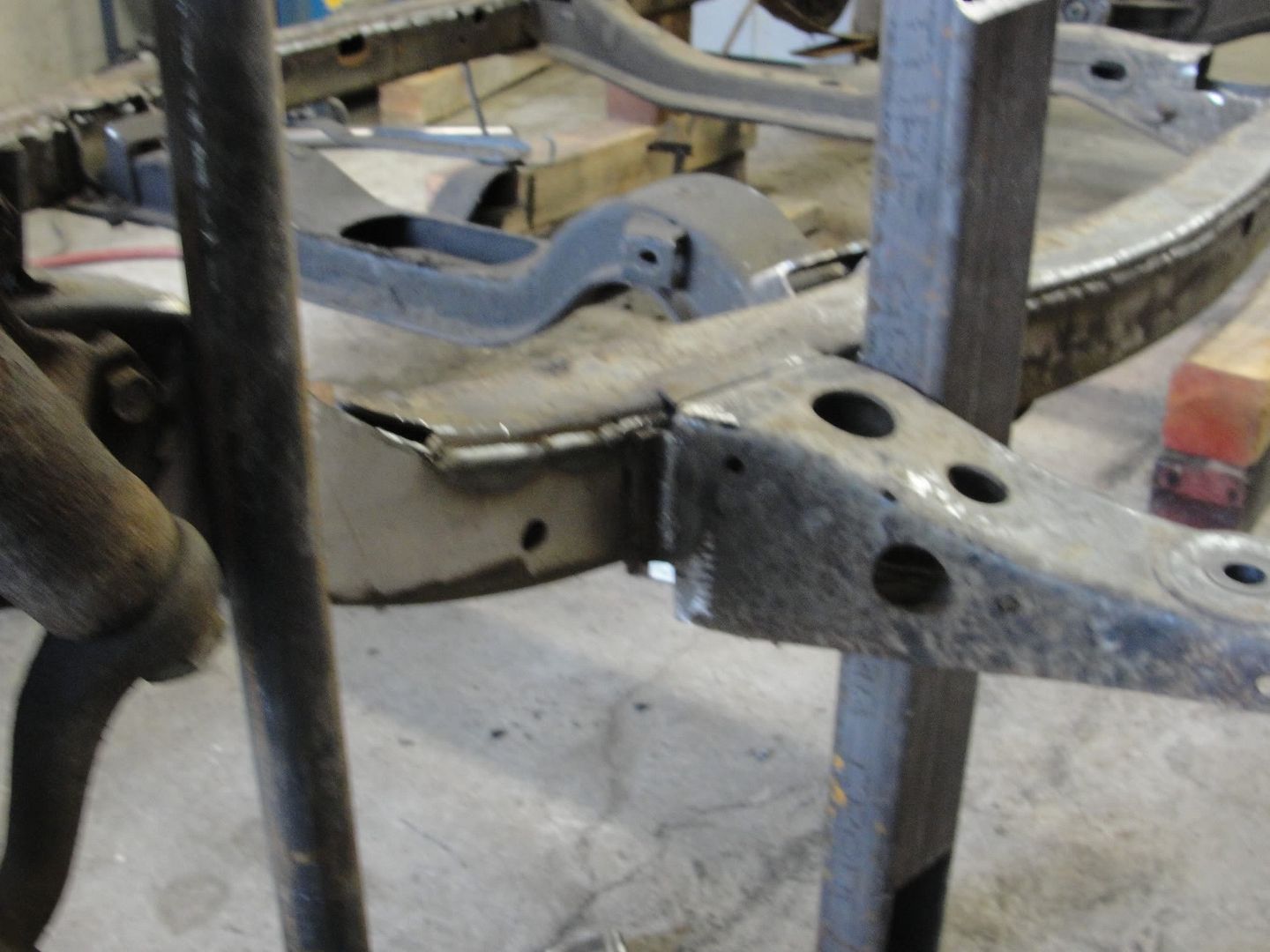

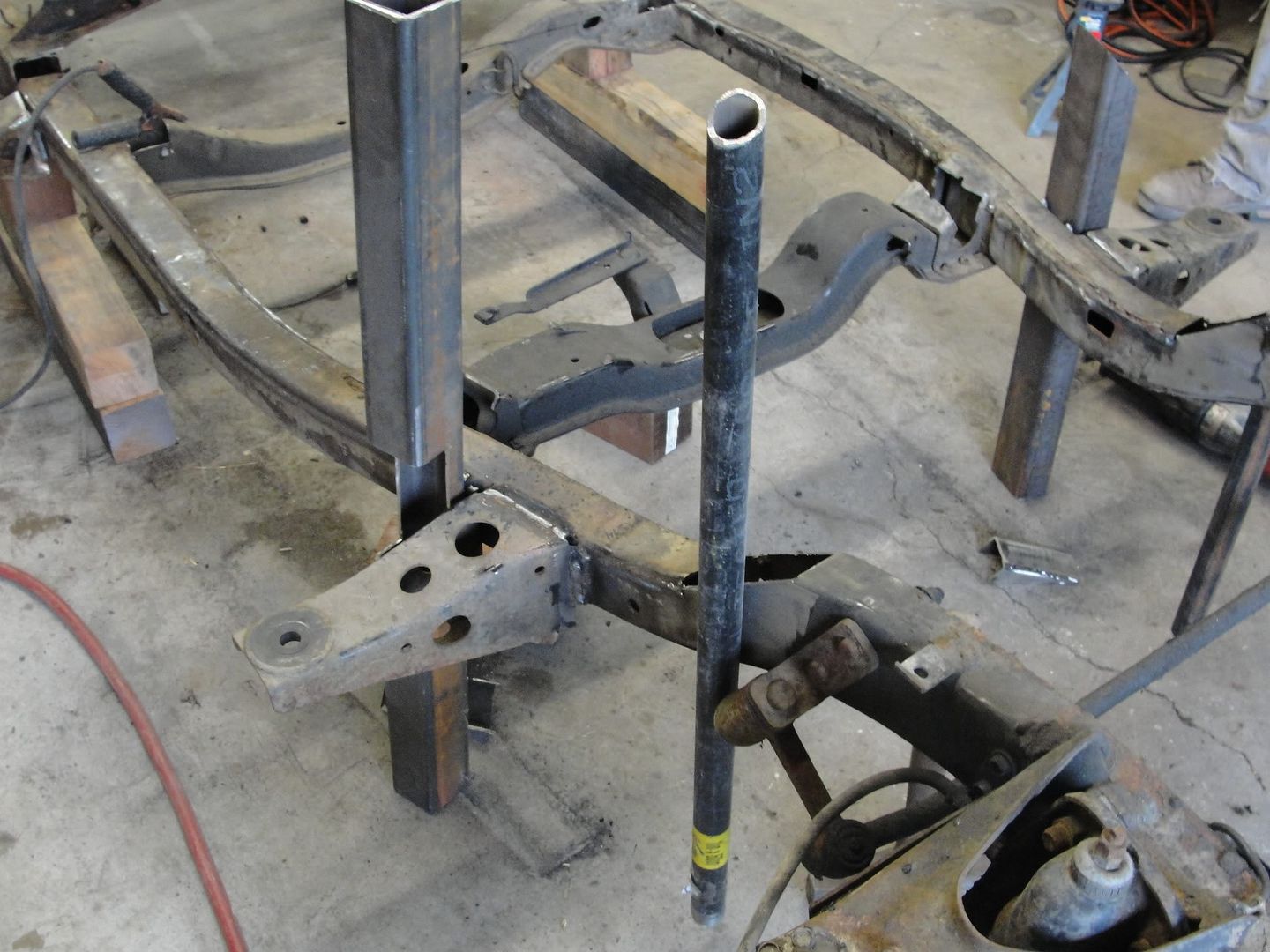

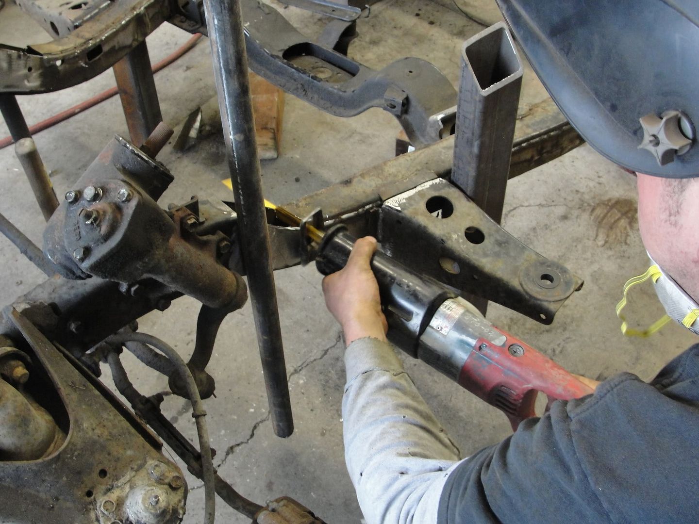

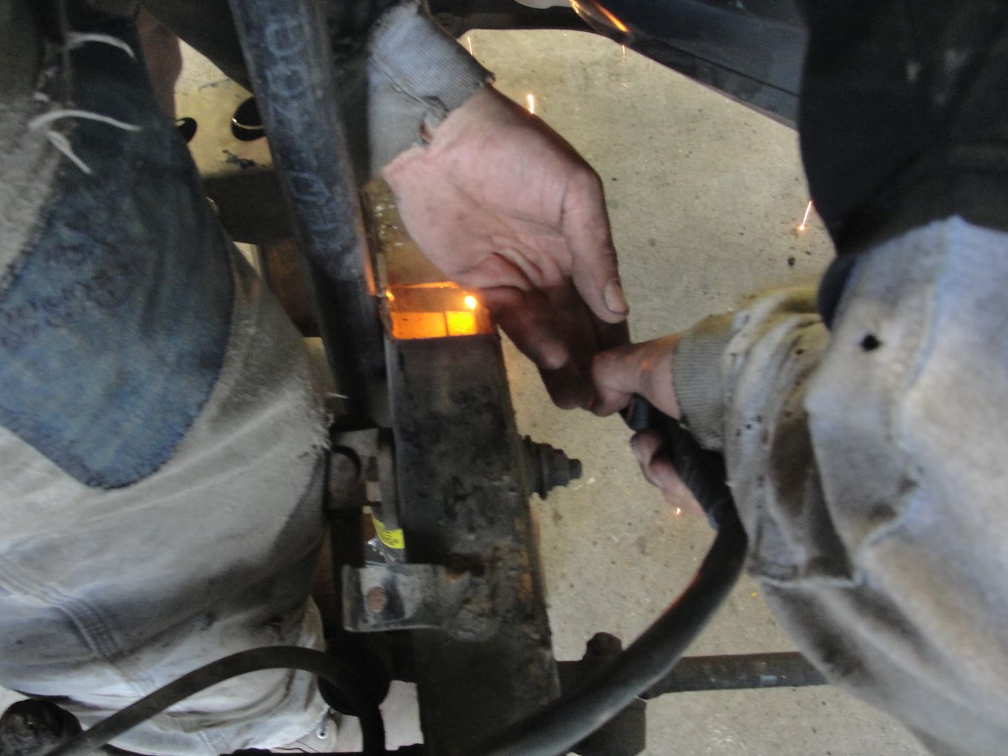

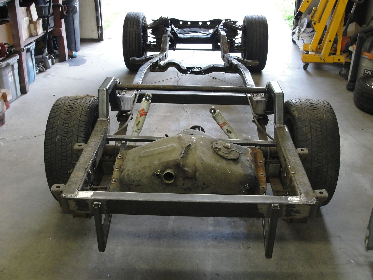

    i got the stock floor body drop done today and frame Z done just need to gusset it. i dint have any metal to do that or it would have been done

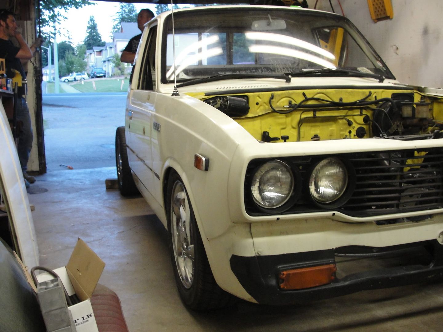

    the guy that gave me the truck stopped by to help...drove it in the rain too:D

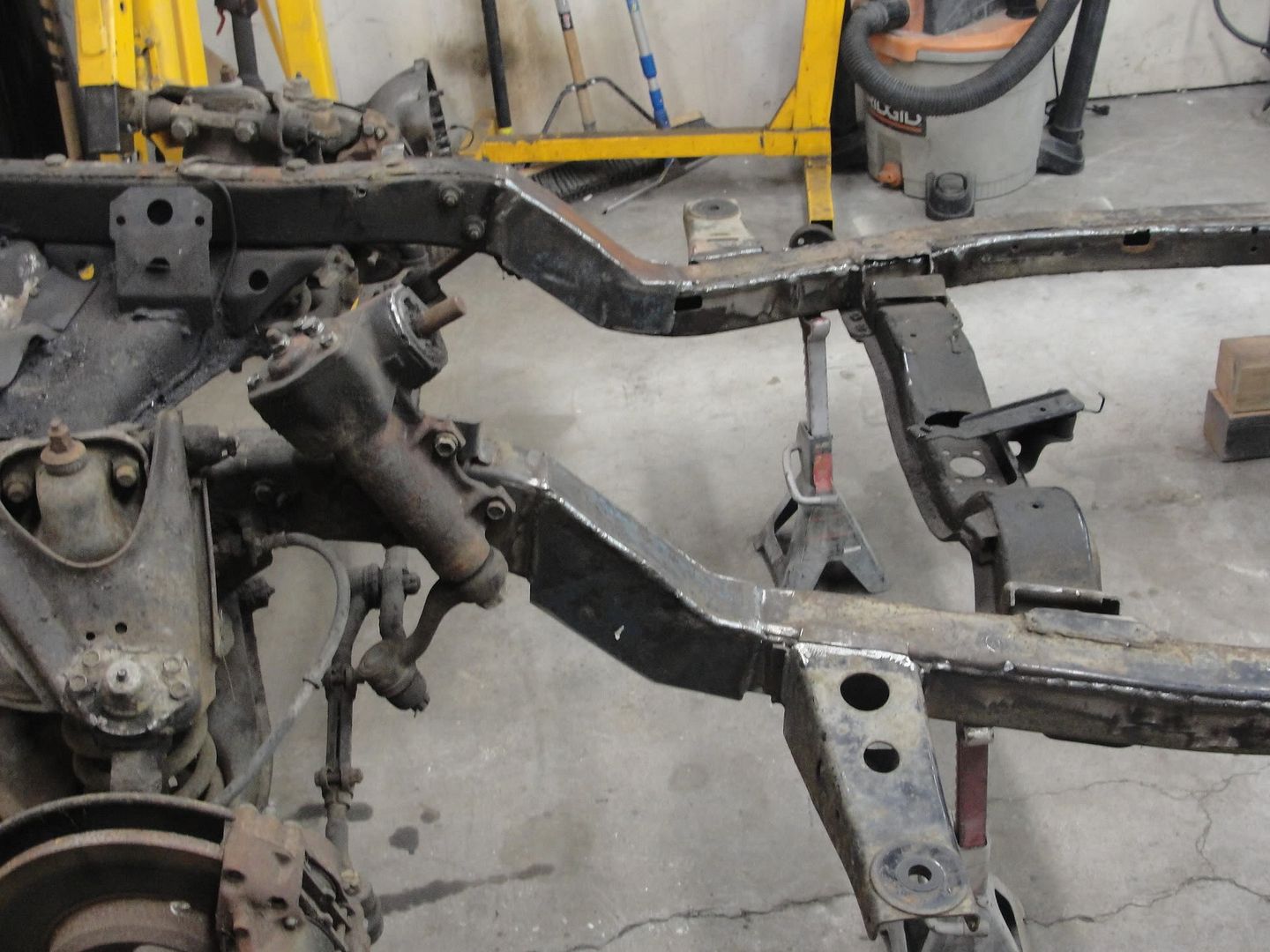

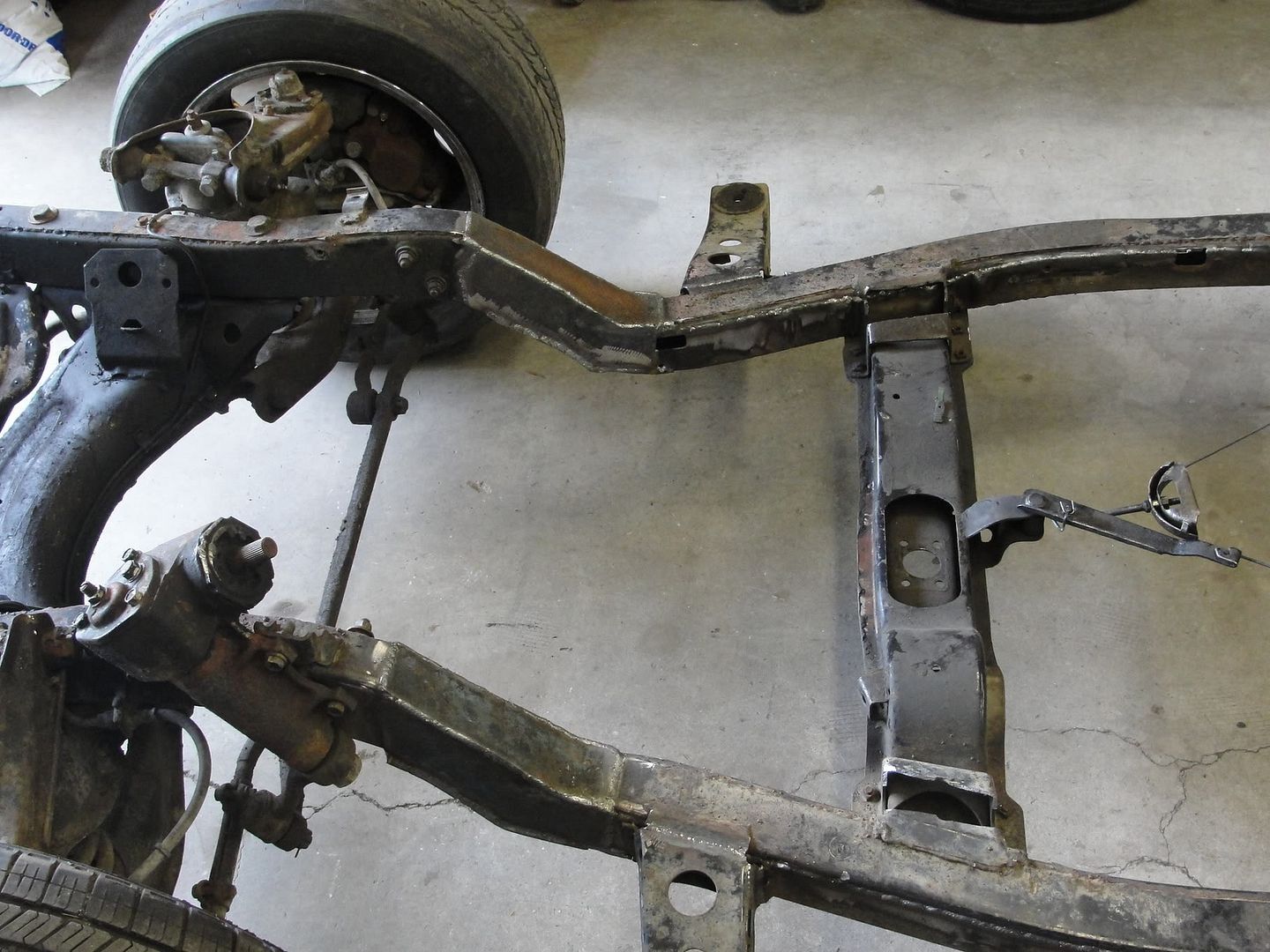

    Dave, you gonna help me Z my 78 too? How do you plan to handle the steering shaft? Looks good so far.

    and i have to notch up for the steering shaft. prob get a tilt column from later truck. well see how it feels.
    so 2" z plus 1" body drop plus bj flip with later spindle. i will have a 5" front frop with stock coil springs:nana: take that joe

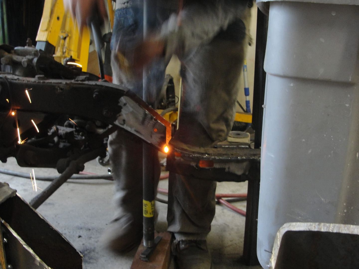

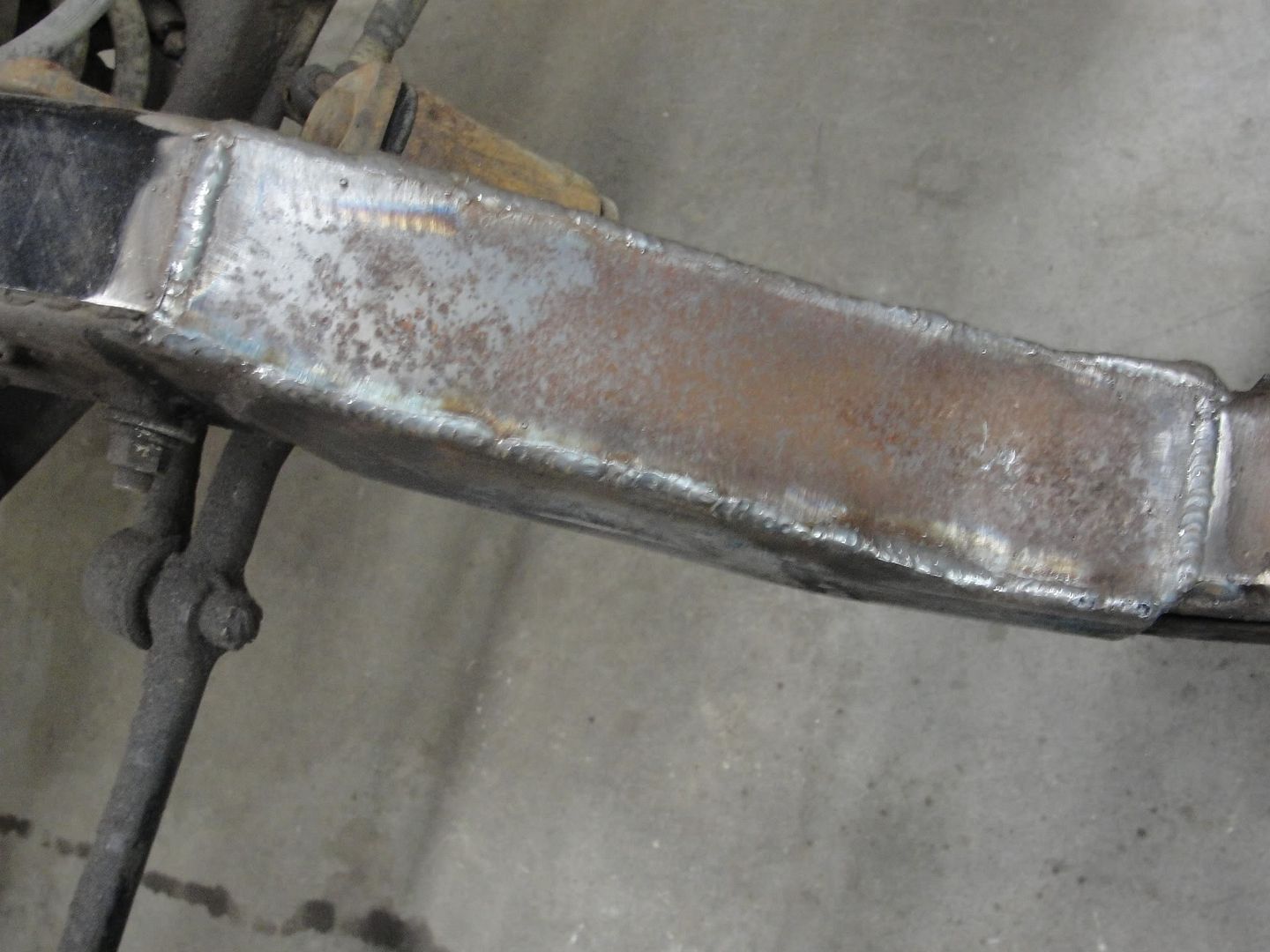

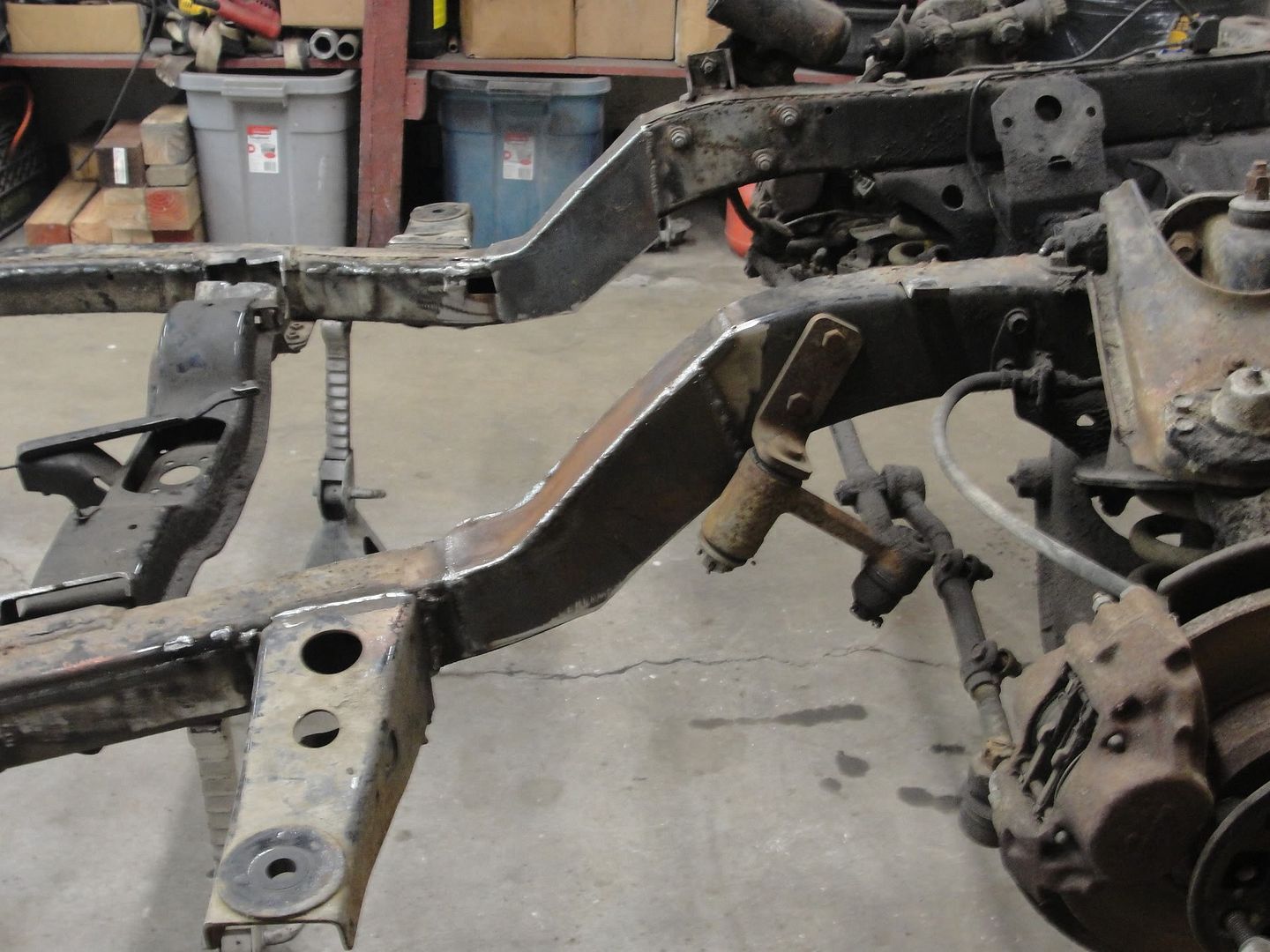

    spent some time this morning and got the Z gusseted still need to do the bottom. but i got **** to do this afternoon. so ill finish it tonight.

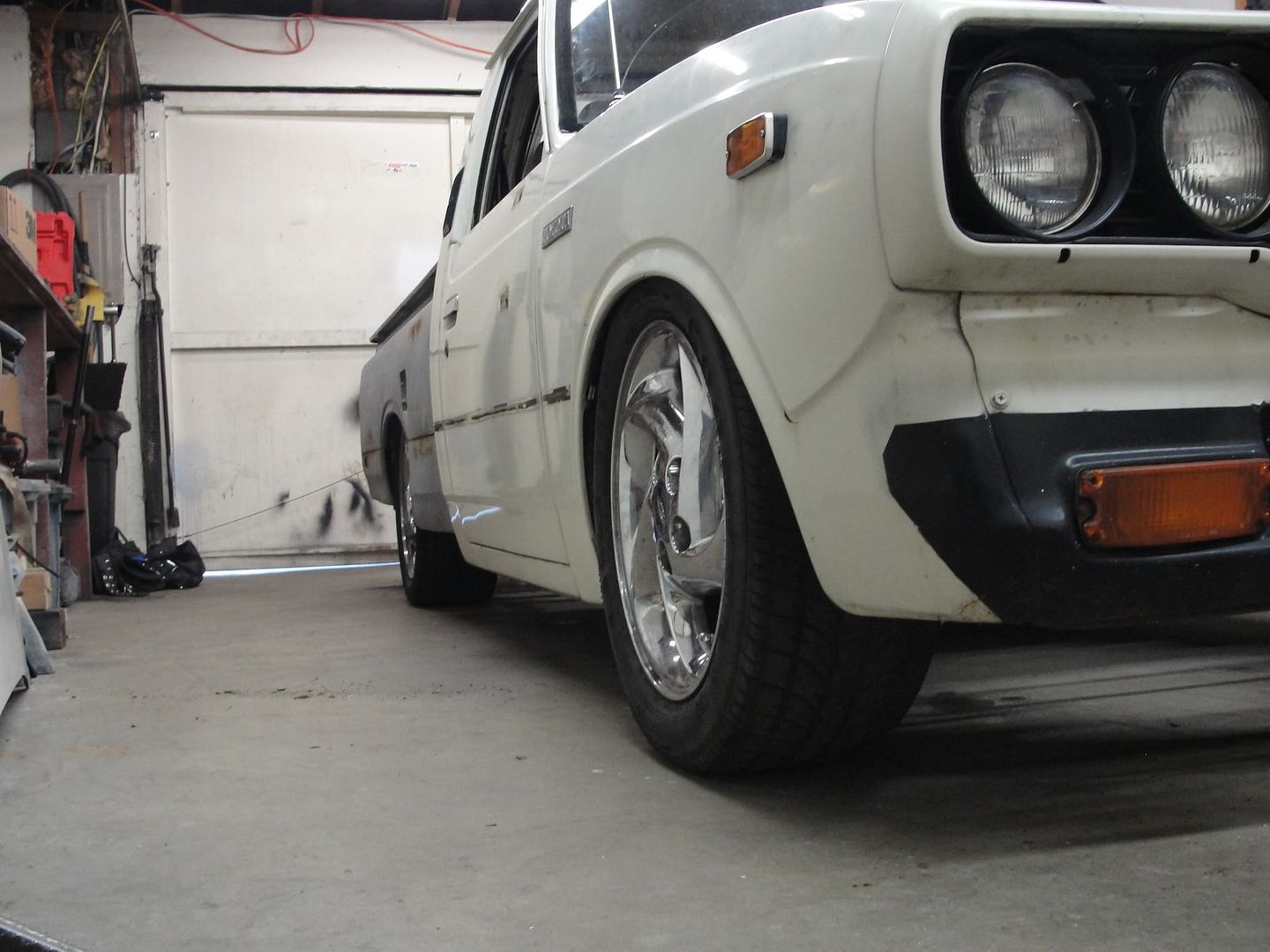

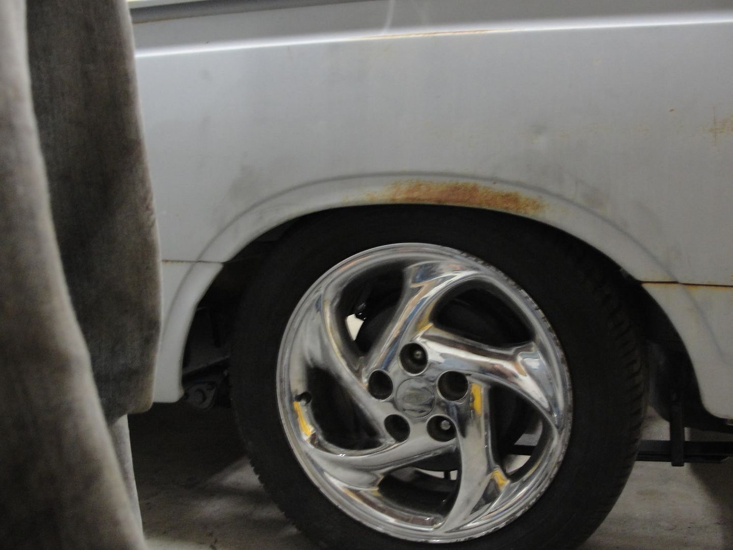

    looks like im having to change my order of new tires to a 45 series instead of a 50- series lol. these are 225/50/16 i ordered 195/50/16 but i think im gonna go with a 45 since they havent shipped yet and it doest even have a motor or tranny in it yet lol

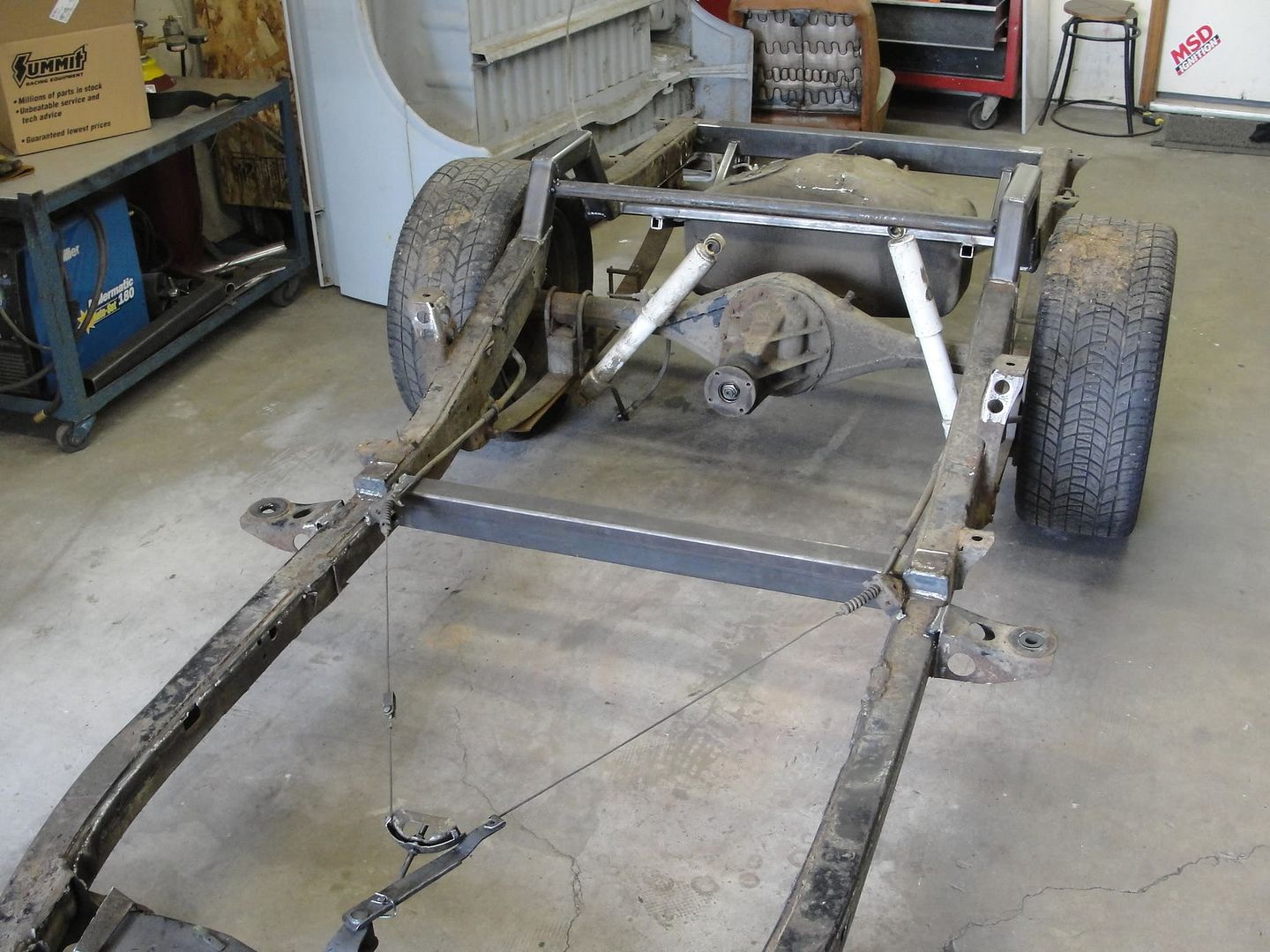

    Looks like the project is going good. Did you lower the back of the frame when you notched it? Or are you gonna b/d the entire bedfloor? Cuz otherwise the bed is gonna sit higher by a bit.
    I just put 195/50/16s on the front of mine, with similar sized wheels. And I have way more space than when I ran those probes. You may have to roll the fenders. I've got a perfect bat for hiluxs if you need help on it.

    yeah i dropped the rear clip behind the notch before i notched it so i dont have to touch the bed floor. i have 194/45/16s on the way. i just sectioned out the front bed mounts to lower it 1"
    thanks buddy!
    and im getting smaller tires. so that will lower it another inch. i know its all about being low but when my truck is the same as joes height with 3" of suspension travel it will be that much cooler. ill prob drag full frame on big dips on the freeway:clapping:

    nice work....how hard was it to cut a straight line on th frame? seeems tough..LOL
