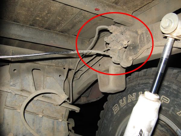

the brake lines in the back off this...http://i65.photobucket.com/albums/h202/yotaman_2006/lspv_oem.jpg
I don't know, lol. I've bagged well over 100 rigs (many of them toyotas) and never even heared of this. Strange. And what is the purpose if it?
when you put a load into the bed its supposed to equal out the braking I guess. but if you've bagged a yota im sure you've seen this. I heard you can just T the lines tht come off and into it. but im not sure on how to do that
Search LSPV. Load sensing proportioning valve. I know we've had this conversation before. Sorry, I have to get to work, don't have time to copy and paste.

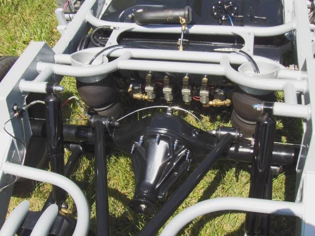

This what Im going to do below...its on a yotascene.com member's truck. Im sure you can get a t-fitting from any parts store like Napa or Advance Auto. Im going to redo the rear brake lines on my truck so they dont come near my c-notch.

Which is exactly why you don't want to just T the line. I, on the flip side have not seen an '86-95 without a LSPV. When you don't have much weight on the rear axle and send it full hydraulic pressure, the drums are likely to lock up in a panic stop. Maybe it doesn't seem like a big problem when you are going straight, but if you are going around a turn and it's wet, a little lock up can be a big problem. Since the drum require less pressure to actuate, the manual proportioning valve will allow you to adjust the amount of pressure that the wheel cylinders receive.
so if i just do this (follow link) a lock up can happen? ive heard of many ppl doing this http://yotascene.com/forums/viewtopic.php?f=3&t=4616&p=48991#p48991
