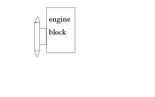

    seriously, consider getting that truck to me and ill trade for my 92 ex cab lol..
    also the timing gear on the bottom sounds like its backwards to me... re read your post and see if you see what im saying... the part that pushes the gear out should face the block to put the chain towards the radiator or timing cover..
    and to anyone who thinks they have worst 22r luck then me, I am pretty positive im on my 6th 22r in my truck and it has about 15k miles more then when I bought it....
  11. DROPT
    DROPT Addict
    Jun 10, 2010
    552
    Whales Vagina
    okay so it goes like this?
    if so then yea i put it on the opposite way

    yes that is how it goes.... thats is the problem... bro do us all a favor, take it apart and take about 50 pictures at all angles so we can see what is good and whats not good.. trust me you will do the job twice as good and take half as long the second time.. i get better and better every time !
