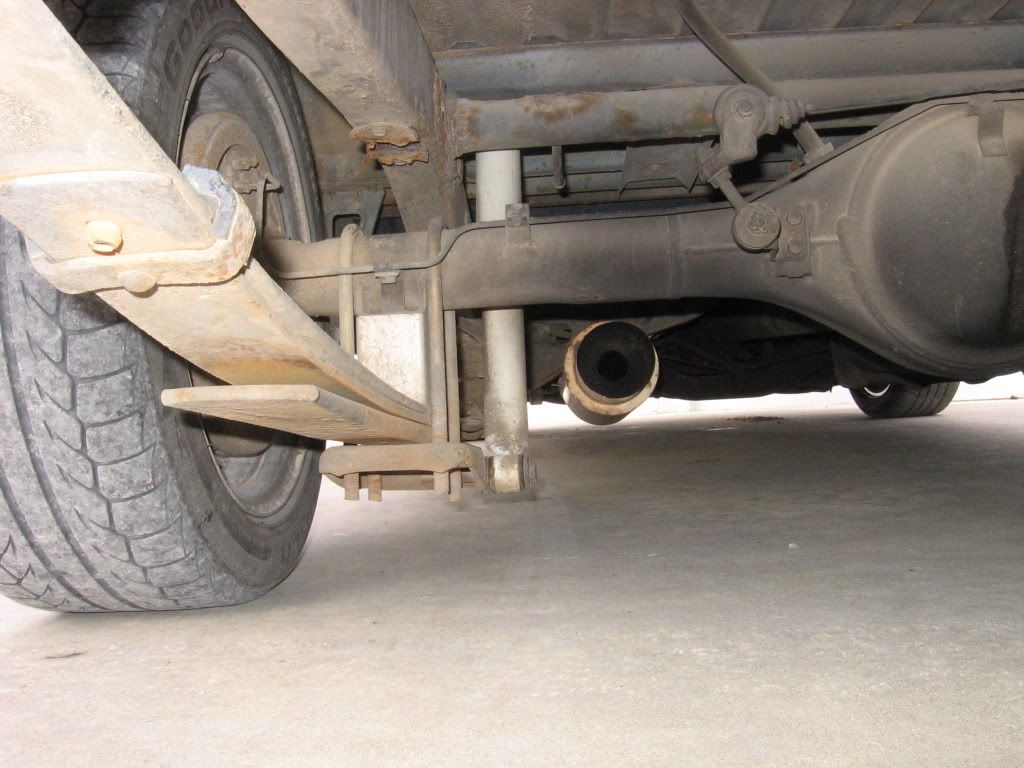

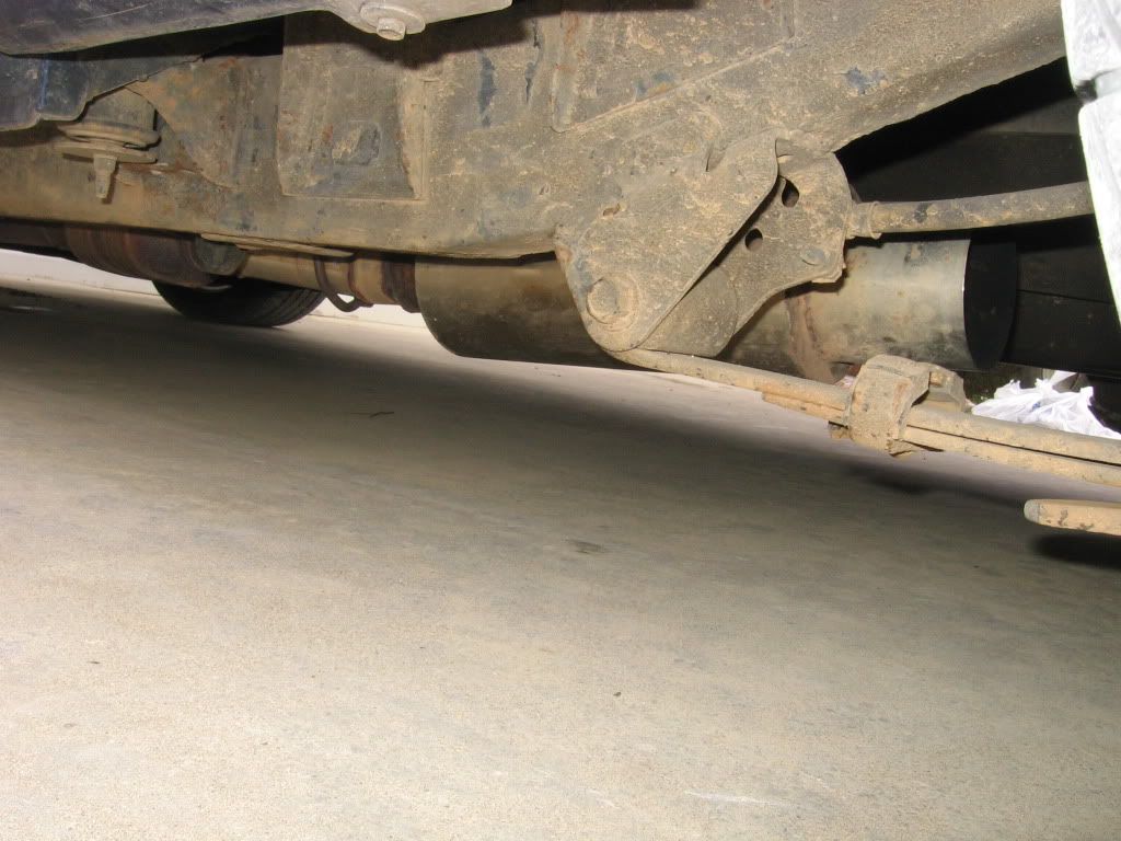

    here is a few shots of my exhaust.
  8. IronNam
    IronNam Grand Toyotaholic
    Sep 11, 2008
    6,960
    Kansas -> NorCal
    94 XCab
    unbolt it from the truck and start shaking it upsidedown :D
    what's the inside diameter of that thing?

    its about 4in diameter. it actually looks bigger than it really is. and the only place to unbolt it is at the flange at manifold. cant get exhaust at right angle to get out without cutting so when i redo it, im puttin header collectors on so it unbolts right before cat. unless there is some trick to getting it out without unbolting motor mounts and jacking engine up. and the way it looks, that prob wont work either.
    and as far as the sound, its not loud at all at highway speeds. sounds real good actually. its just the pulling from lights thats a bit annoying. hopefully i can get it changed this weekend.

    so someone cut off the flanges from the cat!?

    its just pretty much stock set up. and no flange at cat completely welded up. but that will change real soon.
