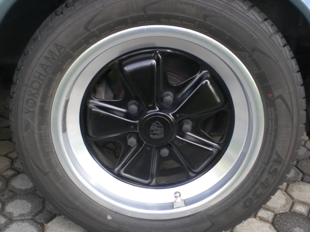

I've been looking at a few wheel / tire combos in here and really like the Porsche wheel look. I was wondering what wheel year / size / offset / hub diameter should I look at purchasing. They will be going on a 1980 short bed 2-wheel drive. I'm leaning towards a 15 inch rim. Found a full set of these (without tires) local for $300.00 is this a good price.

going by how high offset they look of a design, yet how far they stick out, my bet is that that truck has bolt pattern adapters. i think they can be as thin as 25-30mm.
The owner will chime in soon... As far as I know no adapters used, straight up bolt on... I wanna say these came off a 60's model porsche's... That's what happens when you live on a rock in the middle of the pacific ocean... Gotta try different things to make things work...
SUM DETAIL PIX, NOTE:THERE ARE NO SPACERS,THEY DONT STICK OUT,THERE NOT REDRILLED AND THERE 5X114 AND THERE 15" IN DIAMETER.THANX FOR ALL THE COMMENTS ON THE 79 YOTA GUY'S
this would werk fine if you just have the front hub and the rear axel redrilled.and redrilling the hubs and axels are pritty safe,i have a couple of frenz out here that had there four hole corollas drilled out to sport sum 5x114 bolt patern wheels.ill post sum pix of them soon.
Original Porsche wheels are 5x130 except the older ones which are 5x205 (also early vw style). There are a few companies making aftermarket "Fuchs" style wheels in different bolt patterns though. These wheels are very popular with the VW crowd, You can also get them in 17" now. Iozzio Wheels - Specs

porsche, audi, & volkswagen are the same company those are porsche wheels, not early wheels though, the bolt pattern is a "wide 5" pattern
