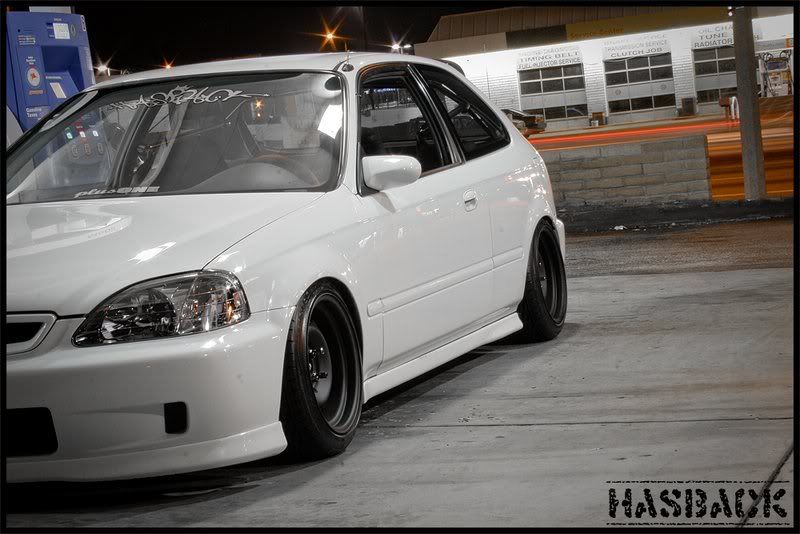

    Does anyone know of any shops who do custom steelies in Northern California (Bay Area)
    This is the look I want, cheap Stock but custom. Steelies with a lip and stretch.
    :waytogo:
    So underated but dope.
    on a civic.

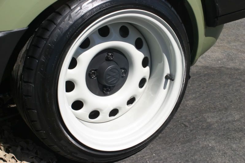

    msot the time its just a stock hoop flipped around 180 so the backspacing becomes a big lip. even my stock 14x5s would look like that if i flipped them. i want to put my centers into some wider 14" hoops. i have 3 spare stock design wheels now so ill experiment soon.

    I've also seen people cut the front off of one rim in front of the center. Then cut the backside off another wheel and weld the backside as the new front side. This gives you a wider wheel with deeper offset. Tip---Cut them on a Lathe and get them Tig'd.

    I considered widened steelies a longg time ago. nothing new, but its sick....
    I plan to stretch 14x6 to at least 14x8.5.
    deep ass lip hidden by my OEM hub cap ;)
