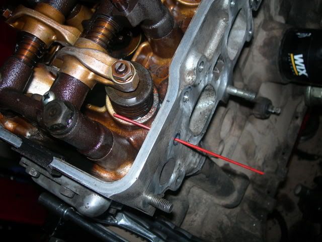

    as shonuff mentioned...... if there is no bolt there holding the egr, its as good as having a hole in the side of the head....................... well, cus thats what it is....... a hole in the side of the head.
    to make matters worse, thats the corner of the head that the oil runs down on and returns to the oil pan........ :doah:

    in this pic you can see all the posible places for a oil leak behind the filter/above the starter/ below the egr.
    the lil oil dummy light sending unit
    the round verticle shaft for the oil drain from the head (aka head gasket)
    and the only threaded hole on the intake that is open to oil (red straw)
