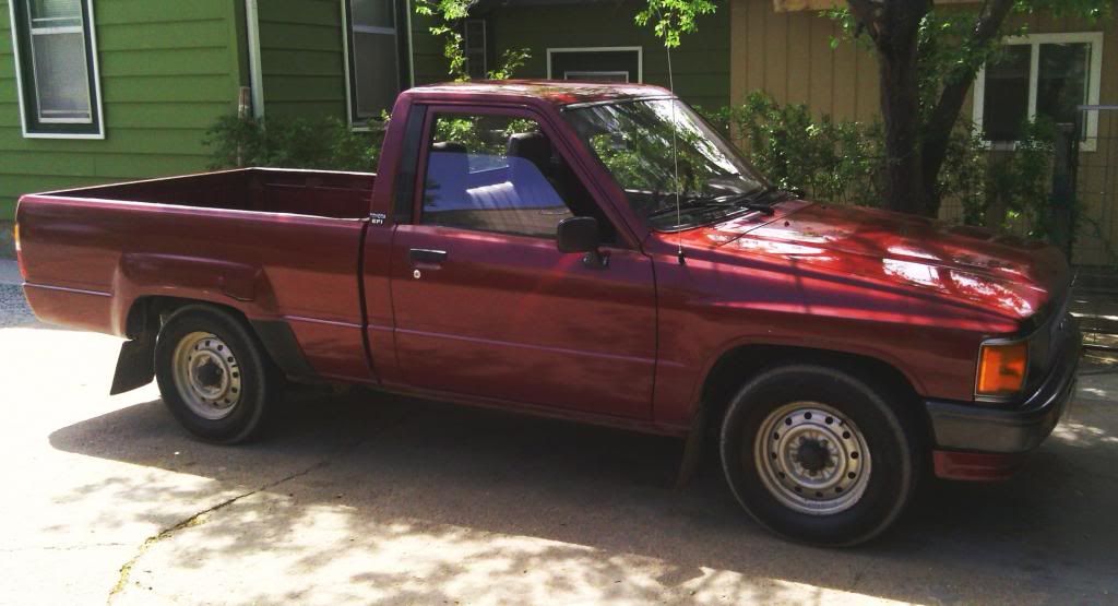

    So i just got my Toyota Mini and i want to lower it 4-5 inches all around, i know i can get drop blocks in the back under the leaf springs, but would that be all i need to get it that low in the back? Also, I'm not too sure how to adjust the torsions up front or where they are exactly located. I know, I'm new to trucks so its cool if you guys dogg on me for it haha, any detailed help will work, maybe post pics of your dropped toyota and how you got it to sit like that? thanks

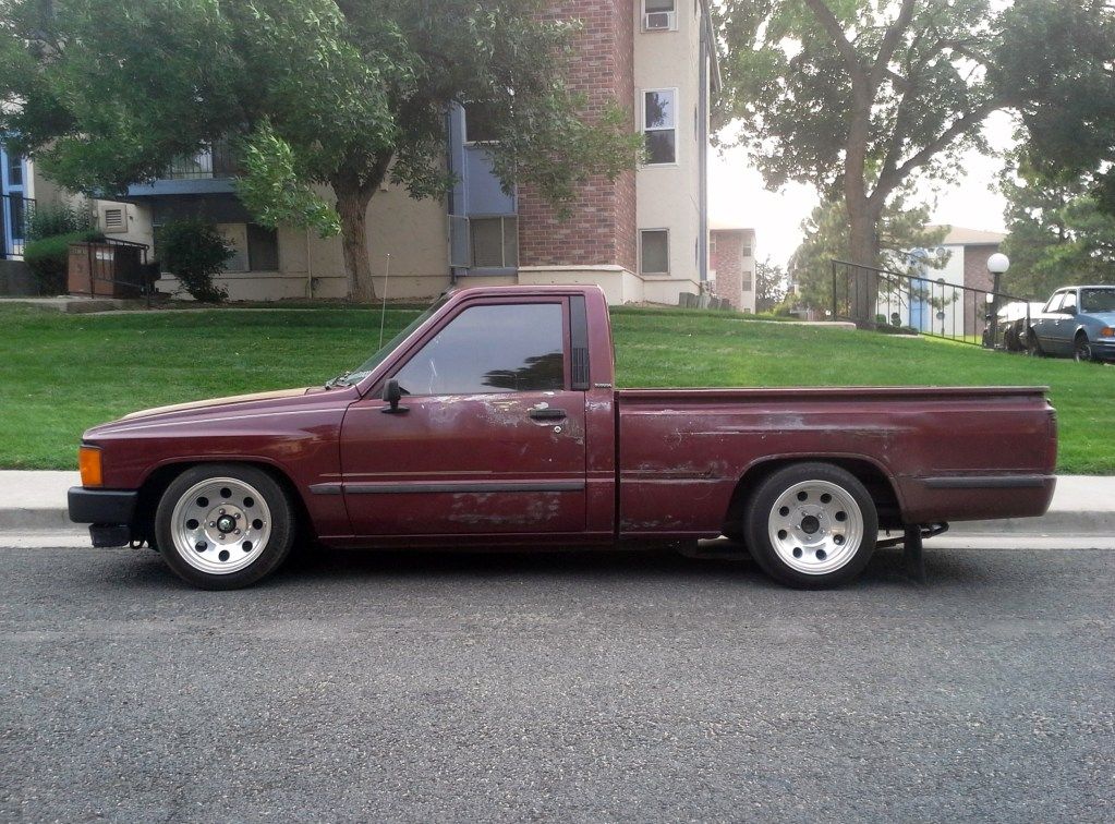

    I'm trying to go at least this low. maybe a little tiny bit more in the back to have no wheel gap.
