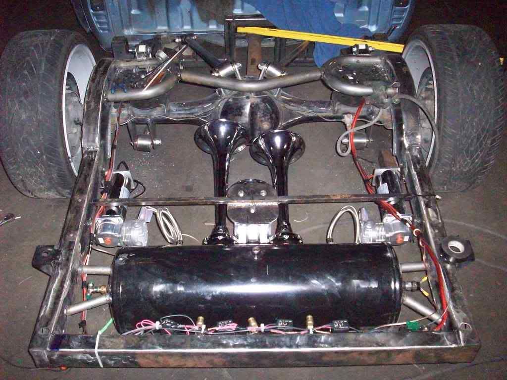

    bag on bar bro!!!!!!! its the only way to go... i have bag on axle on my nissan and its a rough ridin SOB... however, every bag on bar vehicle i have ever ridin in has rode like a Cadillac...
    here is my nissan...

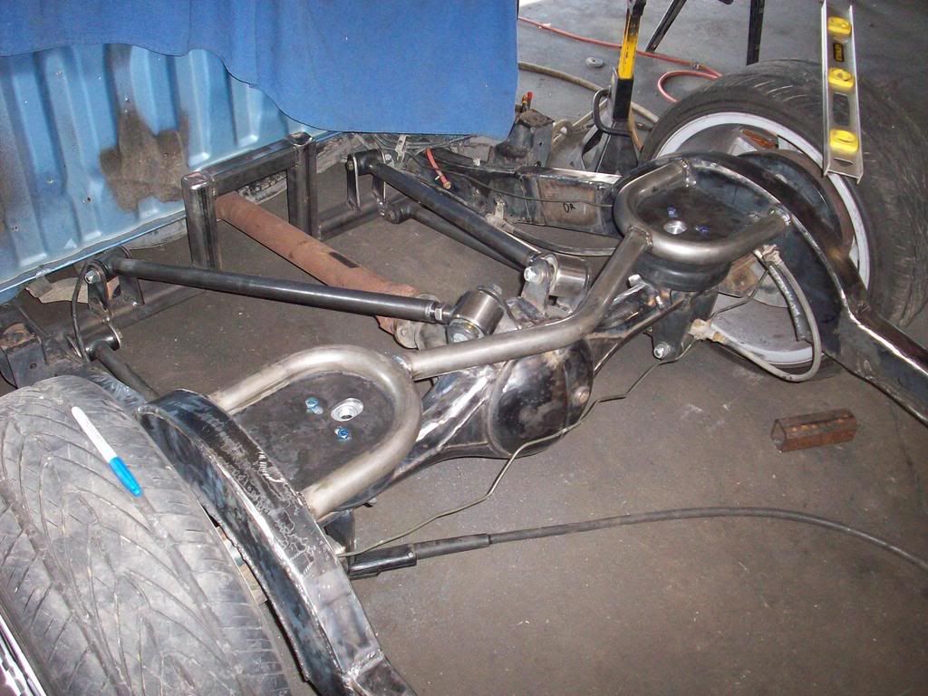

    Viair comps are probably the best out there. An I'd suggest a bag on bar. I've had two trucks bag on bar an I won't have anything else unless it's a cantilever. Just come up with a design an go for it
  8. standardbyker88
    Jul 30, 2009
    4,886
    10
    lynnwood, wa
    78 lolux and an 89 ramcharger
    If you want simple, I would suggest raising the stock tank to above frame level. If you have space, raise it up a good inch or more above frame level to protect it. And run a wishbone 3 link to clear the tank. You could run bags on bars depending on how much space you have around the tank, or run rear facing lift bars. Or a cantilever setup would work as well. Check out how Seth at twistedminis does his 3 link kit and use it for ideas.
