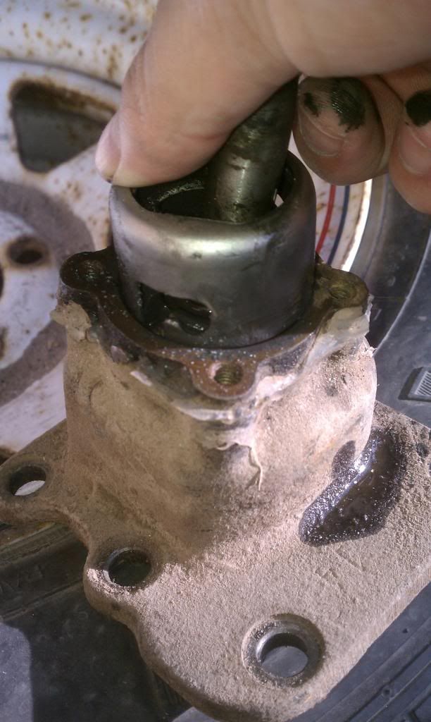

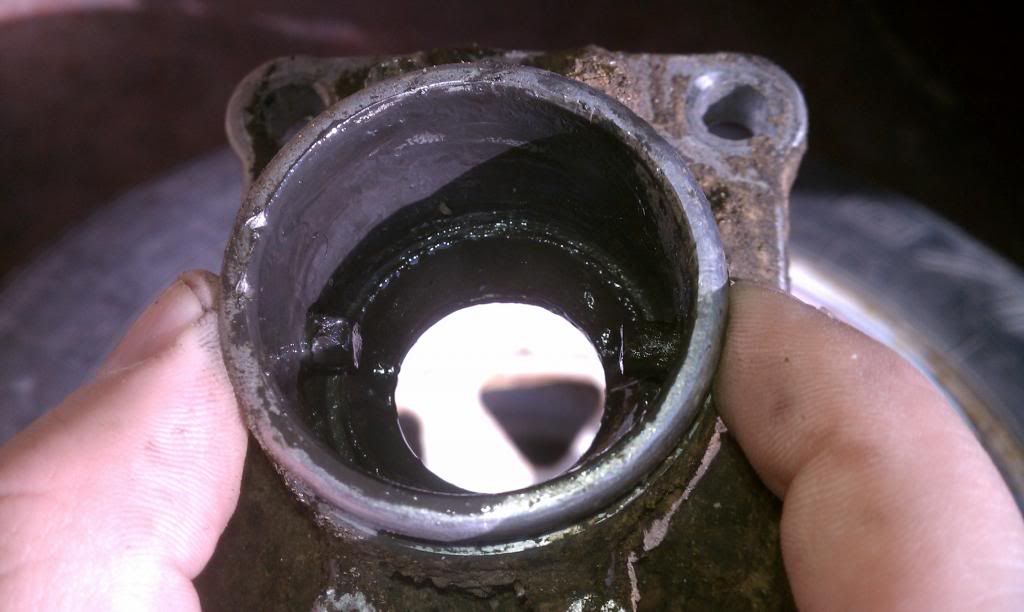

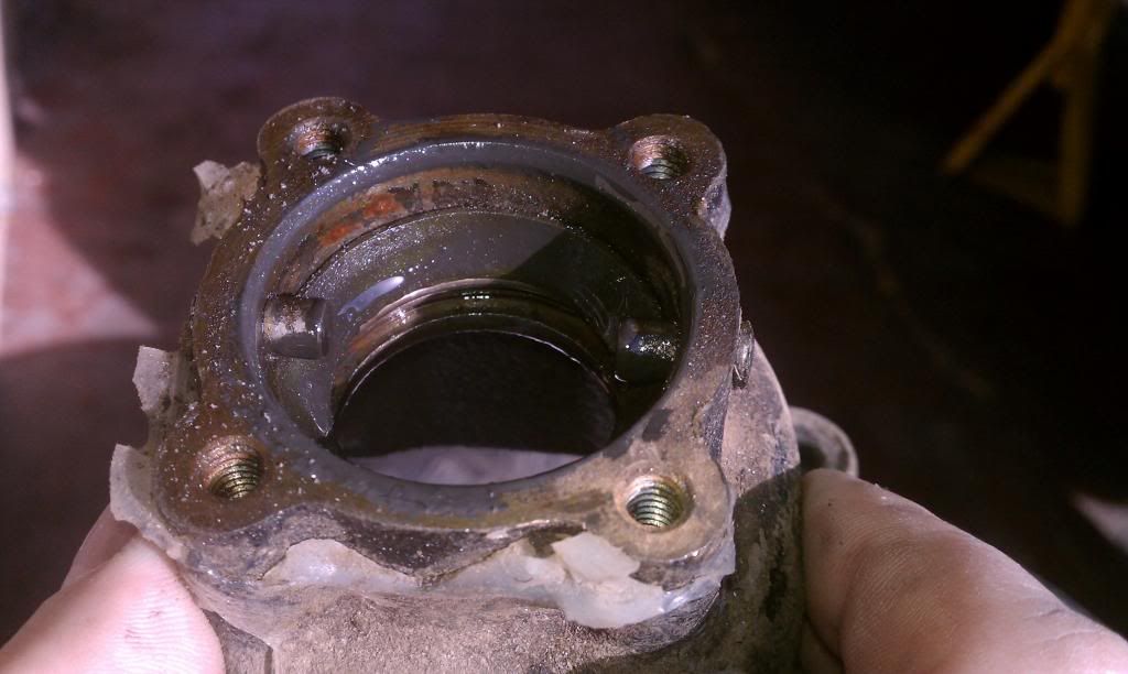

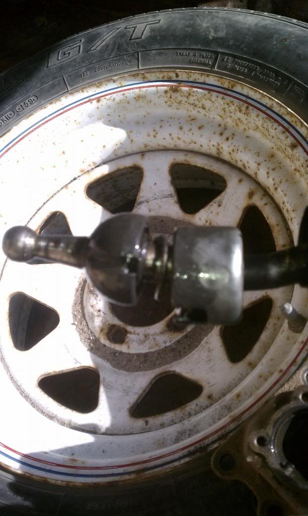

    Here is a pic of my shifter

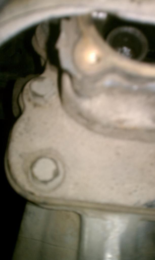

    and these are of my transmission
    There are three bolts on one side and two on the other plus a top peice that has four bolts. Im not sure of the model of transmission either. Im not sure how to make the old shifter work for the new set up

    Those are pics from the 5 speed?You should be able to push down and turn the cap(@45%)to release the shift rod from the mounting plate.

    The bottom two are of the five speed and the drive shaft is not in yet plus the transmission is being held up by a floor jack. I will also go try and take the shift rod off of the 4 speed plate and put it on the 5 speed

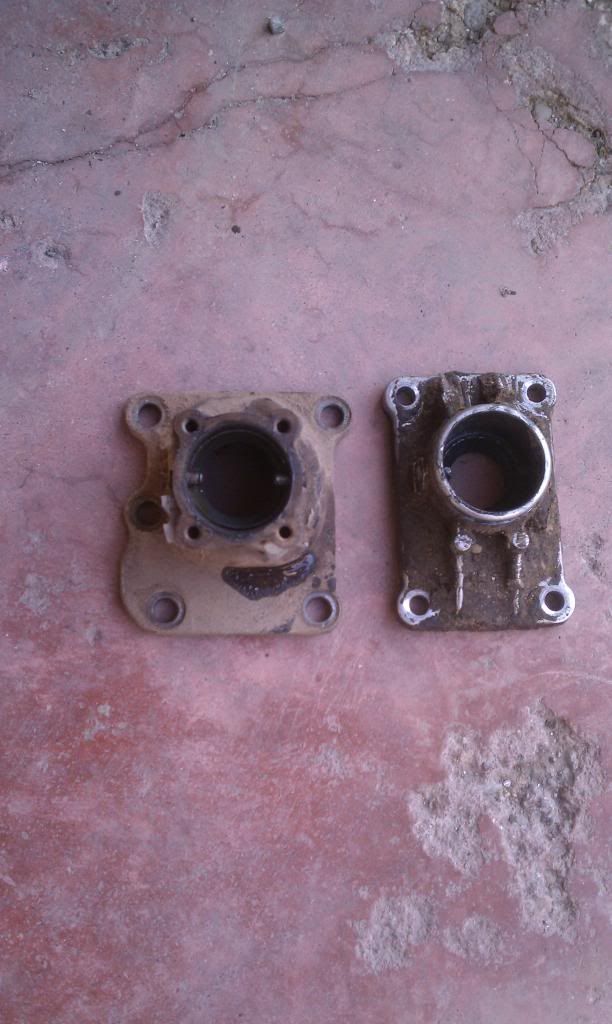

    Here are some pics of the shifter mounting plates. The one with 4 bolt holes is the old one and the one with the 5 bolt holes is the one that we need to work.

    ones from a older truck and the other is from a newer truck
    ones uses a push lock the other has bolt's and a plate
