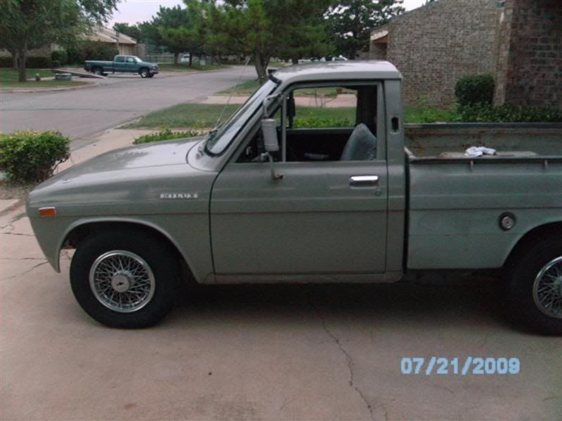

    bought it from an older couple like a week ago. Lady said her grandpa owned it, had been sitting awhile but put some fresh gas and changed the oil and she went, had brand new tires and brakes

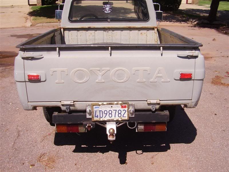

    So far I changed the oil and filter, new spark plugs, removed the toolbox and washed it. Plan on removeing the hitch and putting tailights back in the proper spots. gonna lower it, 3 in the rear and hopefully 2 up front atleast/ Wash it again and then try and wax it and clean the interior up. Oh got it for a grand if anyone was wondering.

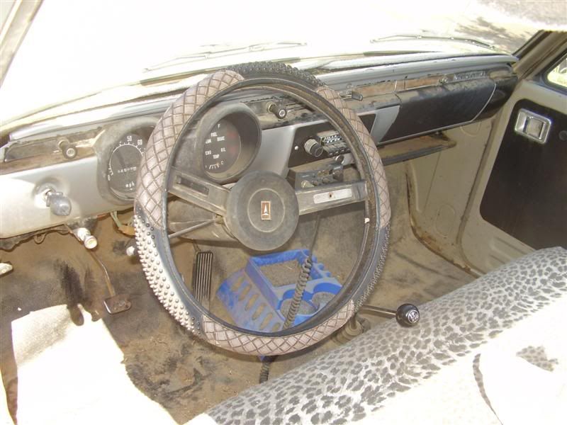

    Looks like a great project. I can't believe your going to redo that leopard print on the seat. LOL J/K.

    yeah, id take it off now but the seats really beat up, its a nice truck, guy was real helpful with getting it up and going.havent noticed and real bad rust spots, theres some surface rust here and there but nothing major. Its tiny though, no leg room at all but im glad I found it and picked it up. Just hope i can actually fix it up they way id like. I might do some minor body work and then flat black it, im wanting to get some 17 inch centerline smoothies, kinda make a more modernized rat rod i guess? idk

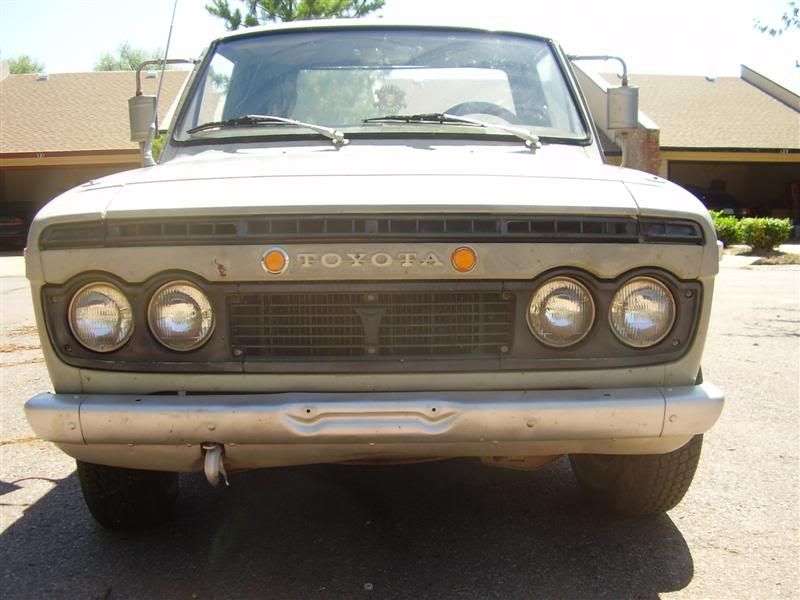

    awww no fender blinkers:(
    looks like a killer start, only hard parts i see is the missing dash pad and maybe the blinkers if ya like that look.

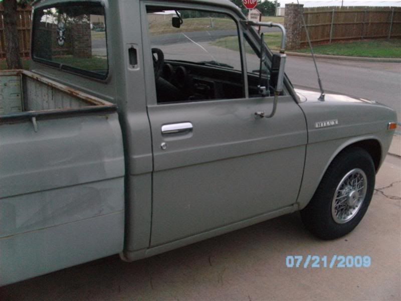

    Im halfway through waxing it, its taking forever but the results r worth it. pictures r crappy but u can still see the difference, whenever i get some money im still taking it to a detail place cause id love to see what they could do

    DANG!! That came out really really good. I like it even more now!

    it still has its imperfections but i think it looks a ton better

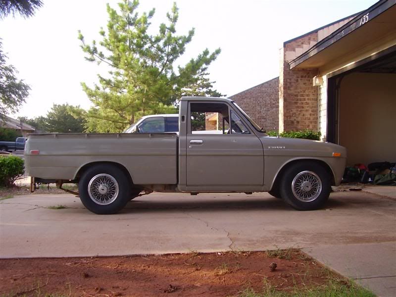

    More progress finally, waxed it and got it lowered

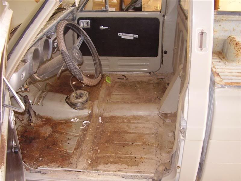

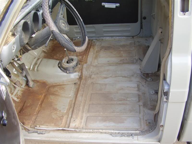

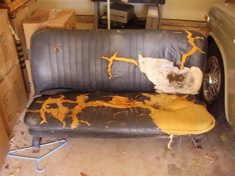

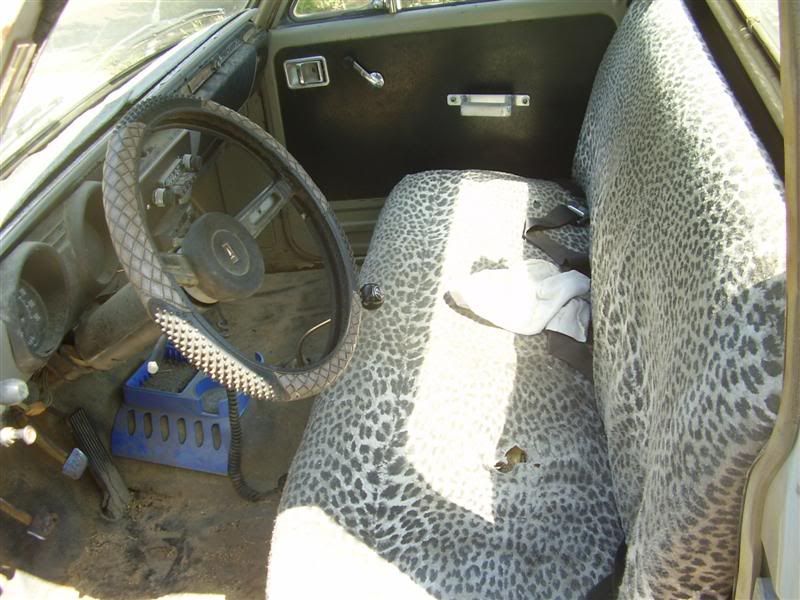

    Got the leapord skin cover off, was tied on with bailing wire in like 30 different spots, so it took awhile, look horrible so im gonna get it recovered asap

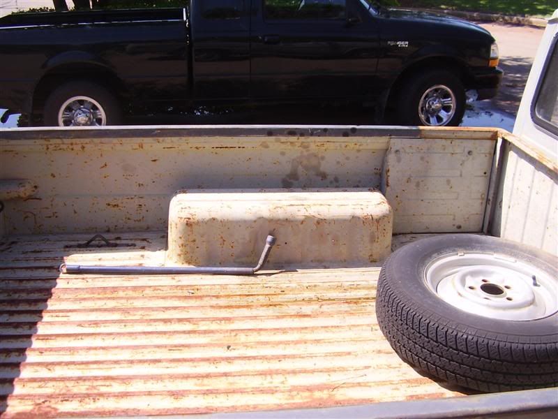

    Start cleaning up the floor and im in the middle of cleaning the years of dirt and crap, then im gonna primer it and throw some rustoleum down, neither autozone or orilleys had por15
    Little cleaning
    Little more cleaning
  16. dailydragger
    dailydragger Enthusiast
    Oct 17, 2008
    282
    you should hurcaline the floor, it will quiet thing down i did my s10 not to long ago
  17. swapmeet
    swapmeet Enthusiast
    May 4, 2009
    108
    I just read what your plan to do. I really really reccomend that you don't just primer and paint it. That won't stop the rust. Your putting a bandaide on cancer. You really need to put some sort of rust inhibitor on that rust man.
    They sell other stuff that stops rust other than POR15, at least use some of that.
    Welcome to the site!
  18. krazyasslunatic
    krazyasslunatic Enthusiast
    Aug 9, 2009
    113
    Oklahoma
    1971 Hilux
    ill go around tomorrow see what i can find, the stuff i got is for rust though, its rustoleum rust stop or some ****
  19. standardbyker88
    Jul 30, 2009
    4,886
    10
    lynnwood, wa
    78 lolux and an 89 ramcharger
    go to an auto body supply place if you can find one. or even a body shop. there are products like rustmort or one step. it basically eats into the rust and seals it. we used those at the body shop. both turn the metal purple. great stuff. apply it with a brush but it flows nice, its pretty thin. then a couple hours later you can coat it with paint/undercoating/bedliner.
  20. krazyasslunatic
    Aug 9, 2009
    113
    Oklahoma
    1971 Hilux
    Will this rust stop stuff not work, its by rustoleum?
