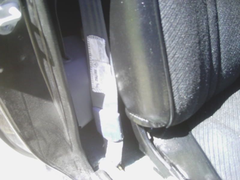

    here is the only part besides the carpet that is the OE color
    everything that could be taken a part separately was painted gloss black.

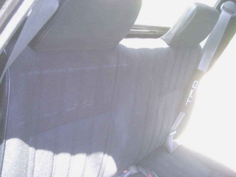

    my bench this is two cans but not as dark as i want it. I'll go dark when i change the carpet out.

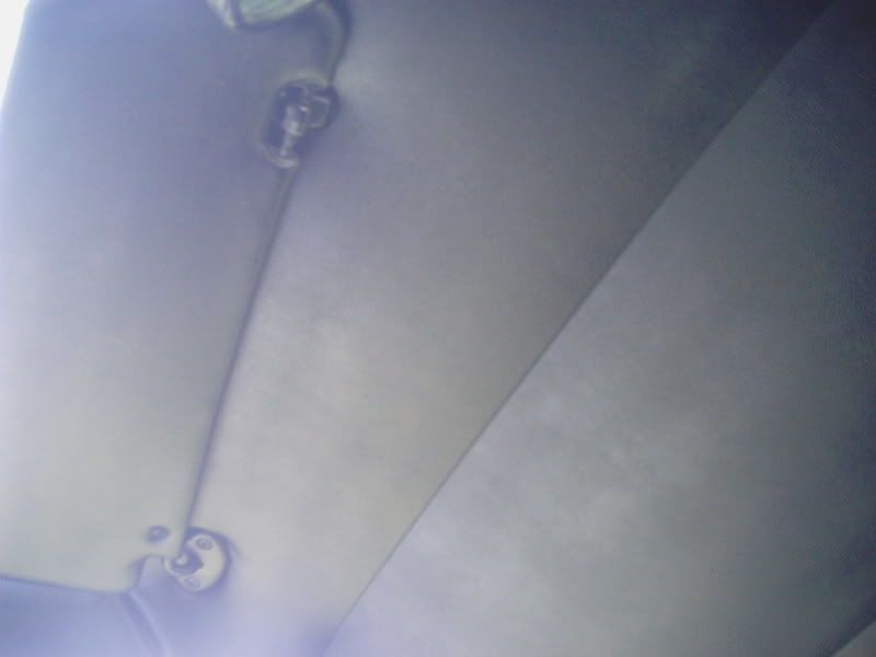

    the headliner was a pain with everything masked off and spraying upside down. that was the hardest part to do.

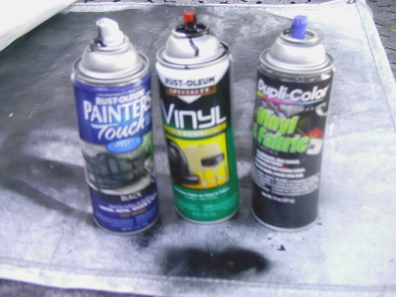

    here is what i used
    the Painter's touch
    (the reason i use this is, I was using it before Krylon Fusion, and the other paint for plastics came out. It was the first one out. It was marketed for plastic and multi purpose. And now they have a paint for plastics same paint new label for $1.75 more)

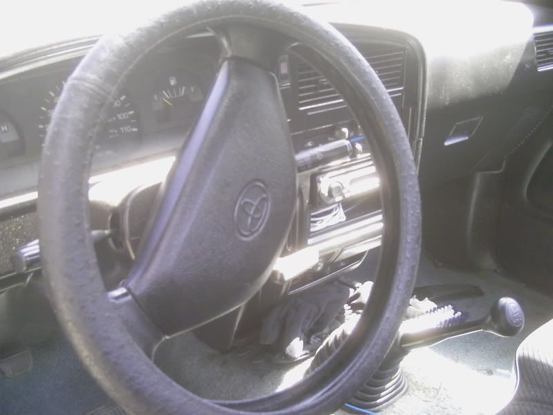

    Dashboard , vents glovebox,
    Vinyl flexible coating
    the doorpanels, headliner, weather striping, steering wheel, armrest, lower/side portion of bench.
    Dupli-color Vinyl & Fabric
    the cloth portion of the bench
