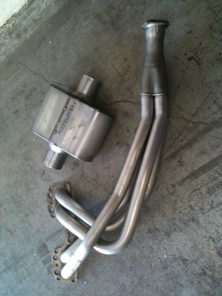

    This is what I have right now. I still need a high flow cat and 6 v-bands. I'm cutting the flanges out the header and putting the v- bands on[​IMG]. Its all going to be full stainless steel. But I might cut the coletter off and put a ss one on. Cuz LC put a steel one one there. Sucky

    I'm going to go with 2.5 on it

    The system looks serious. I think you should give her a cam and some other intake goodies if you go 2.5". Give her the extra love for what she'll put out ;)
