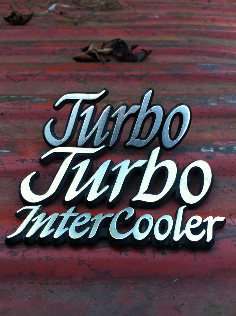

    If you are gonna run boost, you should show it off. I have some old school volvo turbo emblems. Check these out
