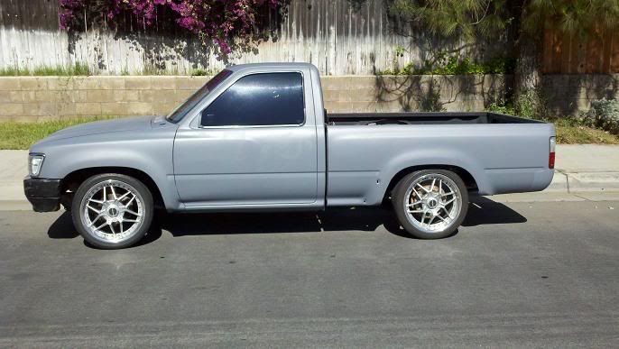

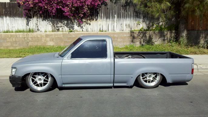

  7. yota4life
    yota4life Grand Toyotaholic
    Jun 28, 2009
    3,023
    51
    lodi ca
    1991 xcab 2wd 4cyl
    I get about 9-10" up front 12+" in rear. Here's with 120psi maybe less before I had the front done

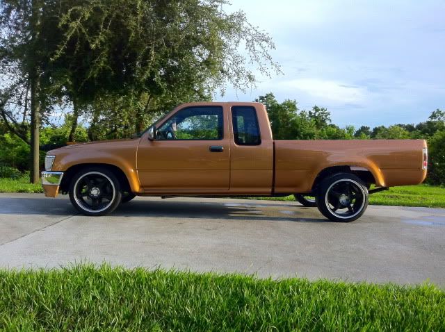

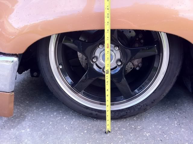

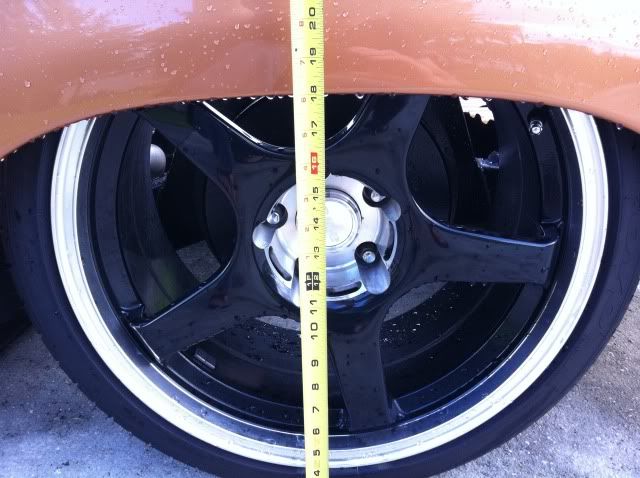

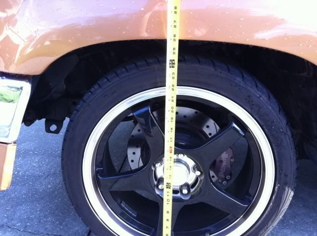

    Here are my pics...
    Front driver's measure 18 1/4" down and 26" up. I'm going to retry this soon, I think I may be having a problem with the driver's corner. It doesn't air up as far as the passenger, and I didn't realize it until I had put away the camera.
    With a grand total of 7 3/4" of wheel travel, it is way less than the 10 1/2" I measured when I first assembled the setup. I realize I lose one inch of travel due to the 18" wheels center being an inch lower than the 20's I designed the truck to lay out with.
    And the Rear. 18" down and 28 1/2" up. If I pull the shocks I get an additional 2 1/2", but I don't really need it.
    You can also see my setup in my build thread.
