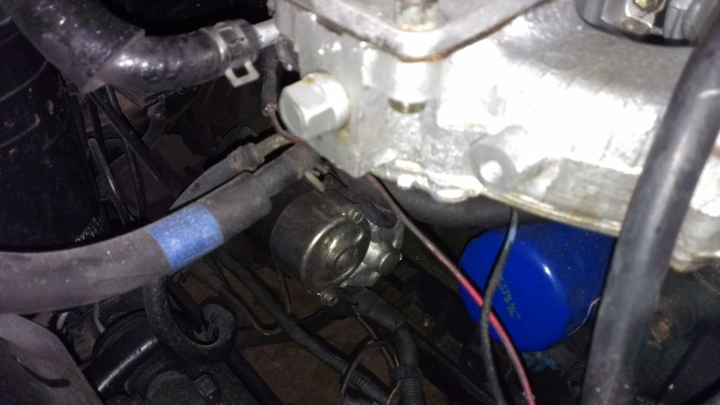

    Okay so my truck has had this issue since i bought it...has a webber 32/36, and it runs cherry...the problem is if i try to accelerate fast it hesitates. I could tell it was intake realated by the sound..first thing i noticed was the accelerator pump was wrong (the lever underneath had the tab facing out not in) and one of the studs in the adapter plate was stripped....so i fixed both things and still has same problem....kinda confused on all the vac lines around the manifold so idk where to go from here....vac advance maybe?

    Take a pic of your manifold side so i can see your vacume lines. I'm thinking it might need a rebuild kit and s good cleaning. does it have the filter on it? Rebuild kit is like $60 over here. comes with o ring and gaskets everything you need.are you running manual or electric fuel pump?

    Okay soo i shouldve mentioned i rebuilt the carb when i got it...still same problem...played with the timing(distributer) and ive also had a different carb on there and its the same..
    So i dont think its the carb, my truck was advanced about 6* and i just recently retarded it a little cuz was backfiring choke..
    @scrub88~~~your pretty much on the money, when i try floor it (not literally) it just falls on its face for like 1 sec, then its good...The truck runs cherry!!!!! IF u gradually accelerate...It can hold RPMs no problem with no sputtering
    BASSICALLY IT SOUNDS LIKE ITS JUST SUCKING WAY TO MUCH AIR BEFORE ITS GETTING ANY FUEL...so i guess it definitely could be fuel related...oh i have a mechanical FP.

    Picking brain . I would believe that it is carb related sense I've experienced similar problem I've down right wanted to beat my carb with a hammer . Fuel supply keeps coming to mind messed around with the regulator much . Do you have both your vacuum hoses hooked to the distributer and then again the acel pump issues

    Did some yanking and capping and its helped a little...messed with the carb a bit as well as the distributer, and got pretty good improvement :waytogo:

    I had the exact same issue as you are descirbing... Here is what I learned the hard way and yes, I am hessitent to say a word because its embarrasing!!! However, I am certain that I am not the first to experience this rookie move... First make sure you CAP every port that does not need a vacumm line. Second, make sure that you have the PSI coming into that carb. You have to eliminate the variables to get to the root of the problem.... So once you have those down, it becomes a matter of timing, which I believe is your problem... I dorked around with my stock pice of **** and after I got my weber installed and THOUGHT my timing was on, I FAILED to realize I set the timing with the vacumm line connected (ROOKIE mistake!!!!!!). I messed with that for a day and when I realized that was the case, I got the timing set at 8 deg (NO VACUMM) and then set the RPM and of to the races....
    Long story short, make sure you are setting that timing mechanically. Also, you HAVE to elliminate possibilities. It could be MANY things, so make sure that you narrow it down.....

    Navymc is right gotta be disconnected . Looks like in the pic u have both vac lines hooked to distributer I only use the one port facing nearest to the radiator then u can buy a plug at autozone to screw into were that multi port vacum housing is with a little Teflon tape or suitable liquid sealant

    So what Navym is saying is i have to disconnect the vac lines coming of the distributer and THEN mess with the timing??

    Exactly correct Bow... This is what I learned... If you set the timing with the vacumm connected, you will never get the advance required for acceleration because the vacumm is present on the distributer when you adjusted it (when the line is connected). It will run fine but it will NOT accelerate. Sooooooo, ideally, the distributer has fly wieghts that as the rpm increases it will advance to a small limit then be tapped out (wont advance any more, thats mechanical advance). After it hits its mechanical limit the vacumm takes over........... I felt like an idiot when I found that line connected because I know better and it just goes to show that I am human. I spent an entire day messing with that thing, pulling the number one spark plug figuring out EXACTLY where TDC is and trying to get that thing to accelerate. When I found that line I was pissed like you read about! Essentially I was timing my engine using the carb instead of the other way around. Set MECHANICAL timing and adjust the carb second. I followed this method after discovering the vacumm line connected...
    -make sure the weber is set to lean run. With your hand, tighten the fuel/air mixture screw IN until it seats (don't tighten it as it will damage the needle tip), then back that screw out 1.5 turns, no more for now.
    -make sure the vacumm is disconnected and get the truck to run at idle, which might require you to turn the idle set screw in until it will run. Then get your mechanical timing set.
    -Go bakc and fine tune the fuel/air mixture screw the way weber advises and then set your final RPM with the idel adjustment screw.
    -NOW connect your vacumm lines, close the hood and, voila! It should solve the problem!

    Thanks ALOT!! I bassically worked on it most of today got the timing light out and was wayyy off...busted out the Haynes and like u said..."felt like a dumbAzz"pretty much learned what u just told me but not as detailed...THANKS.. Going back at it tomorrow, gonna do it the right way and hopefully problem solved!

    Trucks running perfs!!:waytogo:
    @ about 7-8 degrees Advanced..
