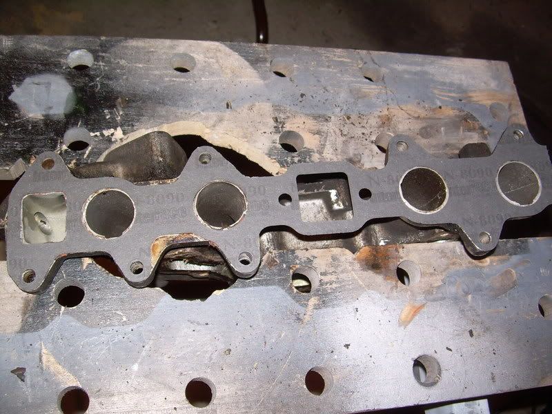

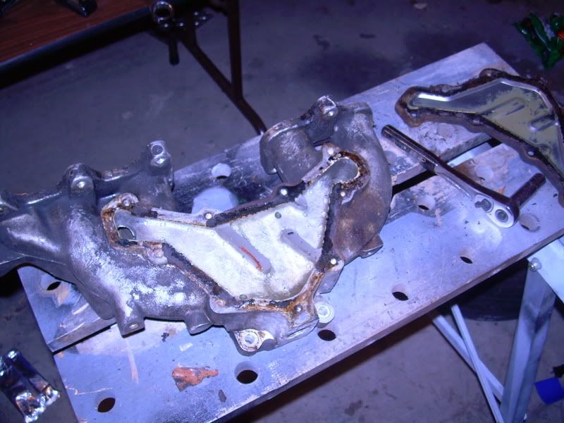

i have read a few places that a stock ported intake is as good as the aftermarket ones. i found a very noticable gain by gasket matching, porting and other mods to a stock intake for my 20r. i also have a good ignition, a header, a new head that had 1mm oversize valves, plus a 32/36. i cut out the bar on the carb mount area, and did alot to the intake. id say get an extra used at the junkyard, and port it with a kit with a die grinder or a drill. you can get the kits at harbor frieght. and like nook said, dont get it too smooth. i think i finished with 80 grit on the intake. here are some photos as i did it.

yeah for downdraft carbs, thats about the best you can do. i dont see the design of the offy intakes being much different than this, so not worth my money. i also saw minor gains by taking the choke butterflys out of the carb. i ended up cutting the whole choke horn off but i wouldnt suggest that unless you have a second upper weber body. lol. start with an intake. you can always switch it back. i did use a carbide tip to help get the bulk cut for gasket matching. and taking the flash and ribs down. but did the rest with the paper sanders. its by no means perfect or totally even from port to port, but i got them pretty close by my standards. and its worked well. plugs read pretty consistant from cyl to cyl.
