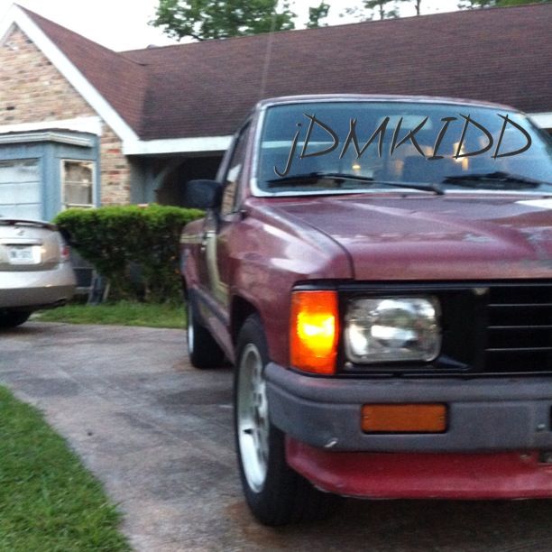

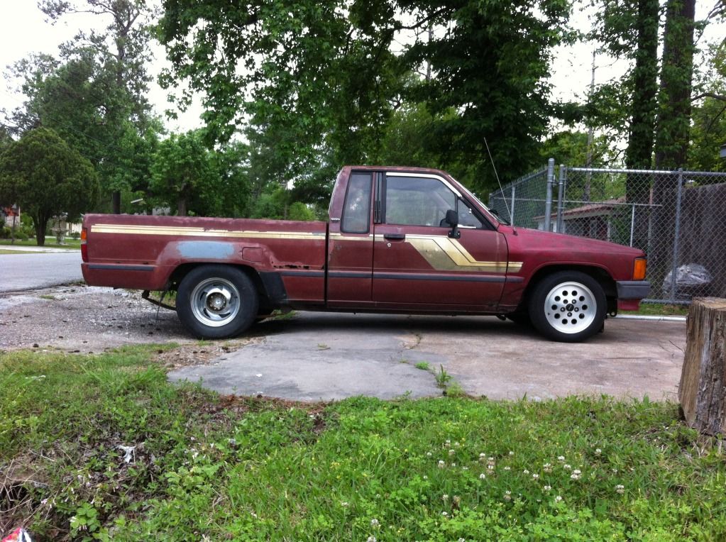

    Well i recently picked up the wheels there 15's on 205/50/15 tires im thinking of going lower all around cause when the wheels are on theres a kinda big gap on the back nd i want it lower gonna get the drop leafs for the back nd turn the torsions more from the front nd what else do i need to do to the front..???

    nice man... For the front you can do a ball joint flip and get some shorter shocks.... You may want to remove the bumpstops if you havent already.

    pinto shocks are about 2 inches shorter i believe. i did the balljoint flip, cranked the torsions and removed my bump stops. no washers on the balljoint flip though.
