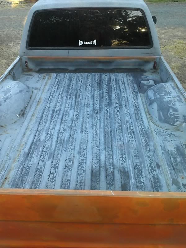

    Ok if your gonna go through with all the work an money spent on bagging it you might aswell lay the bitch out. You can always raise the bed floor an still keep it functional. Bag on axle wont ride the best an try going with a 3 link or 4link those are the best an will keep your pinion angle at optimum degree. Ill post a pic of my bed so you can see its still functional keep in mind mines raised for a body drop aswell so yours wont have to be so shallow [​IMG]

    Thanks but I still need a deep bed cuz I haul crap from time to time. I'm the family hauler now for crap.
    Pickup truck problems
    And I'm not that much of a fan of the bodied minis. They look cool n I respect it but not for me. I wouldn't laying frame but I really don't wanna cut my truck up that much.

    You don't have to body it. Mines just raised up for it cause ima be bodied one day. It could probably be around 4-5" deeper than what it is right now. What size wheel an tire do you plan on running? Tht will help with notch size. Hell I remember seeing on mazdabscene some guys were just Z'ing the rear frame after the cab so they wont need a notch an just raising the bed floor a little bit
