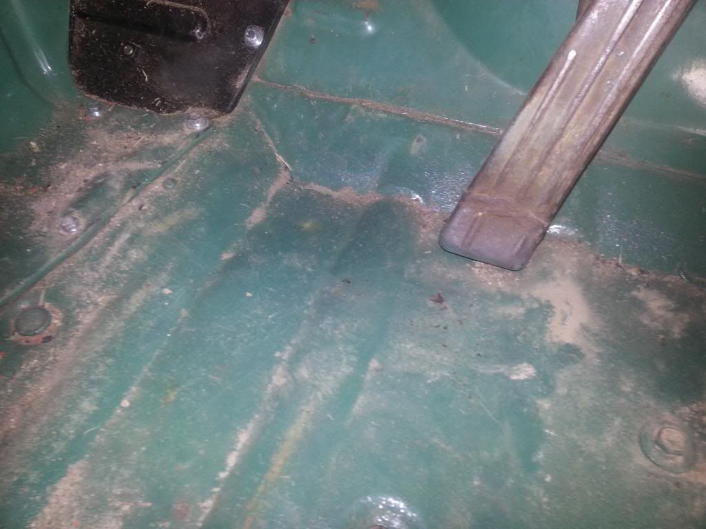

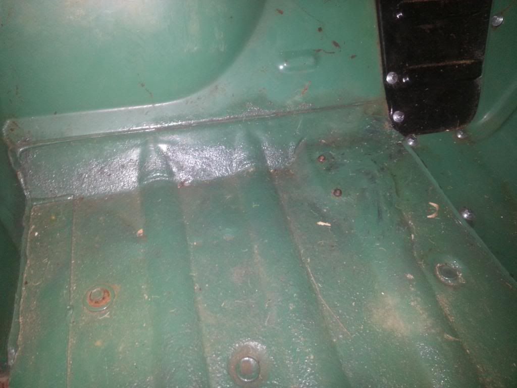

    as the stouts have a relatively flat floor flat sheet metal would be an easy way to put a complete new floor, yet with my experience the pressed ridges are very important in holding structural integrity and with my 1976 RK101 stout (australia) the floor has creases in it from it being on rough roads and on the left side i had to weld up a large crack formed by the floor creasing under the weight of the cabin sitting on the rubber spacer under the two screws in the photo (photos australia is right hand drive) but both side have creases [​IMG] [​IMG]
    in the photos it is slightly hard to see the creases, yet if you know the under frame and how the cabin bolts on you can see that the floor has dropped around quarter inch in front of the mounting bolts.
